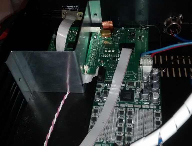

Have a look at my implementation in my signature, I've since changed all 8 audio cables to use RG316 coax, however the distance on the I2S/spdif wires are kept short as possible, since I am driving boards parallel, the only wired connection to the 2nd board are for the serial port, the rest chain from the top board to the bottom via pin headers. Overall I personally think your layout is fine. My case has very little ventilation, a few tiny holes at the top, but it doesn't get too hot despite the shunt regulation.
A further improvement with iron shield around Raspberry PI 2b.
Could you please publish a photo of the Pi with its shield, I have spent some time trying to work it out!

The picture yellow is the answer with nylon spacers and Raspberry Pi indexing Moode data base, green is shield, spacers and Raspberry Pi indexing Moode data base, red is shield, spacers and Raspberry Pi without audio reproduction and no indexing. Everything in the audio output.
