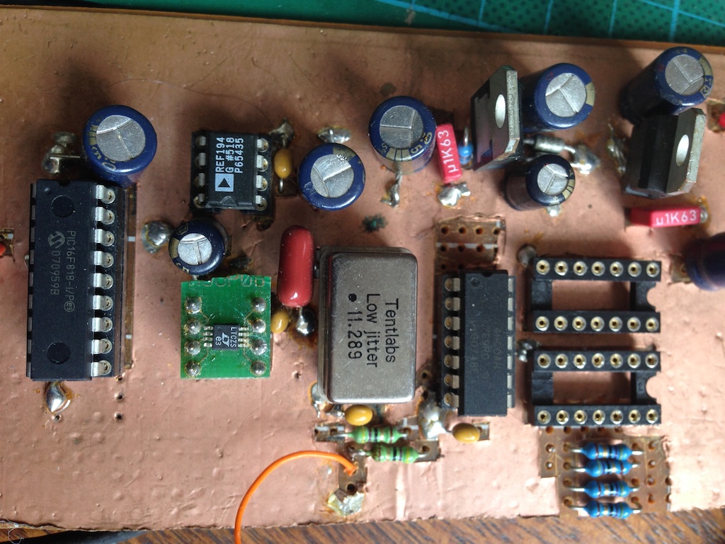

I don't count myself as a jitter reduction guru by any stretch. I did build and code a PIC based PLL using a Linear Technology unbuffered DAC to control a Tent Labs VCXO around 2008/9 but never got the code fully sorted out. It used the 3/8 word buffer in the SM5847 filter chip to compensate for slight drift between the recovered clock and vcxo clock. It was fine once locked and sound far better than the recovered clock despite being a "rough as guts" perf board experiment.
Iancanada's method has drawbacks - the long buffer creates an input to output delay which makes it unsuitable for home theatre applications as Søren pointed out.
The reference to "TRACKS the incoming clock" belies what is actually occuring - while long term frequency of the data stream is followed, the FIFO acts as a low pass filter on the incoming clock to remove jitter. The corner frequency of the low pass filter is directly related to the frequency of the updates to the master clock.
I found in my PIC PLL setup there would be no adjustment made to the clock frequency for periods of 5-10 seconds even with a minuscule buffer and an unoptimised control loop configuration. This is the equivalent of a LPF with a corner frequency of 0.1 Hz.
:ADD: Most XMOS and Amanero based USB to SPDIF/I2S convertors now use XO to ensure that clock rate is stable, but even in the case of older transports the clock drift is not huge enough to require large adjustments over the short term. :END ADD:
With a well sorted FIFO and accurate adjustment of the master clock the update rate is likely to be in the order of once every 60-120 seconds or better, giving an equivalent of a loop filter with a corner frequency of 0.01Hz in the worst case. As a point of comparison the old CS8414 S/PDIF reciever has a loop filter corner frequency of 1000Hz. The low update rate means that the influence of jitter on the incoming clock is effectively eliminated. The infrequent update rate of the master clock means also that jitter induced by adjustments to the clock is very low.
So I contend that while a large buffer might look impressive on paper, in practice the advantage isn't nearly as significant as you might have been lead to believe.
