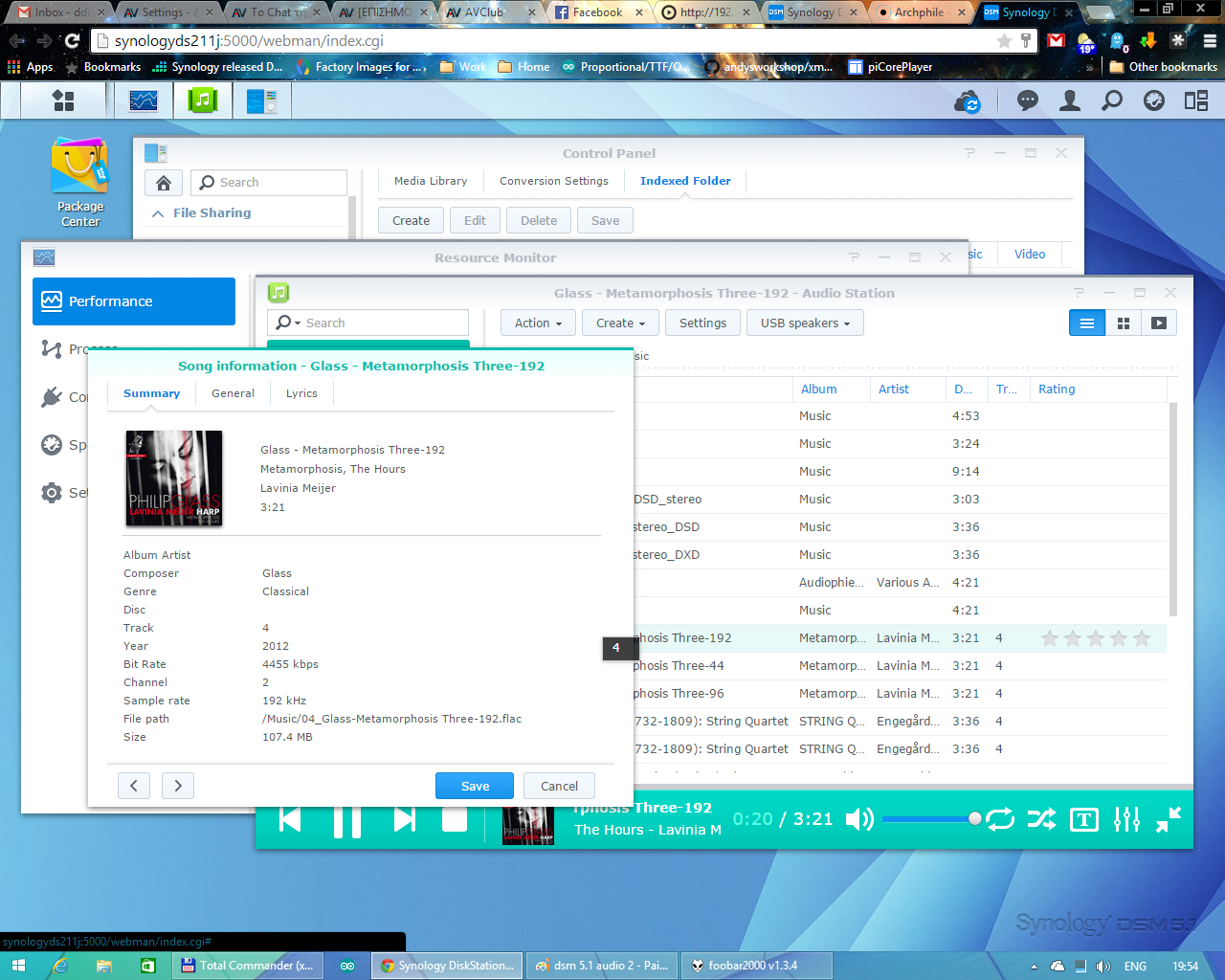

@Eldam: In fact, Synology NAS are able to output bitperfect through usb from 44.1 to 384khz since DSM 5.0 with DS audio / Audiostation app
French resource link: Test "Bitperfect" d'un NAS Synology via l'USB et le DLNA. : Musique dématérialisée - Page 22
If you don't like this app, there are alternative mpd packages that can do the same thing.
Right, so it is definitely not an operating system / device driver limitation.
