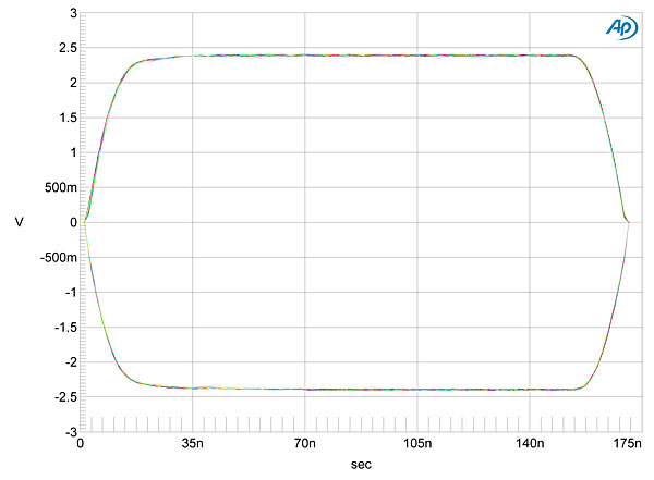

As for TOSLINK being a bad protocol, I'll share my favourite online test data from a Stereophile review of a Musical Fidelity V-Link .
fig.1:The "eye pattern" of the S/PDIF data waveform, connected via 15' of plastic TosLink, was wide open and free from timing uncertainty at its start and end (fig.1), and the Audio Precision System SYS2722 calculated the jitter in this datastream to be a very low 395 picoseconds peak. This is not quite as low as the Halide S/PDIF Bridge, which measured 345ps peak, but was the same as the Stello U2. (All figures calculated with a 50Hz–100kHz measurement bandwidth.)
Pretty good performance for a protocol that is supposedly far worse than coax. Perhaps the V-Link has a superior TOSLINK implementation to your Squeezebox, but regardless it shows that TOSLINK is not inherently flawed.
