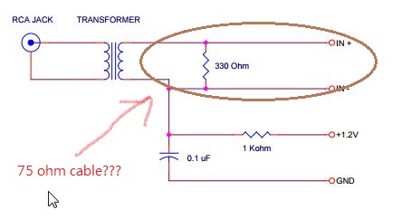

75 ohm Cable after Pulse Transformer?
For SPDIF receiver, should 75 ohm cable be applied after pulse transformer? 😕😕😕

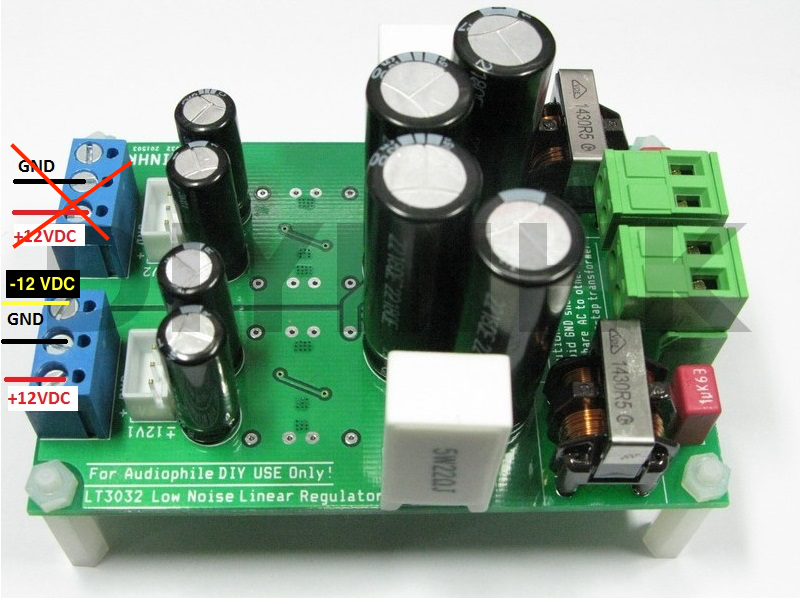

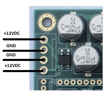

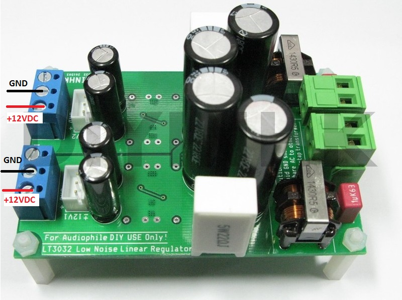

I just assembled this LT3032 PSU from diyinhk as proposed by Hifiduino. It measures +12VDC between + and GND on each side.
Is this the correct way to connect it to the DAM1021 in?

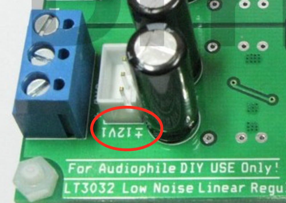

You have a *dual* board. This means that you have 2 times +/-12 volt.
So you only need to use one of this 3 outlet blue terminal instead as you draw both of them.
Now, as the web page don't supply a real drawing and no schema this is a bit hard to tell but I can see even on the silk screen text on the board near one of the terminals the this says "+/- 12 Volt" and that all you need.
Yeah, diyinhk might have some good stuff and reasonably priced, but it comes with absolutely no assembly instructions or schematics. Nothing to download on his website either.
