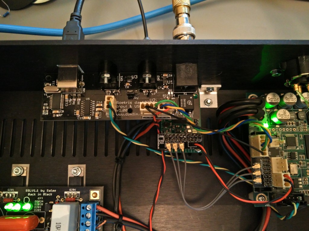

I finished my s/pdif inputs board and installed it in my Soekris:
attachment.php
I decided to include two toslink inputs instead of one, and LDOs for powering the toslinks and the coax input. I also included a USB-to-RS232 circuit, to minimize fuss with performing firmware updates.
While I was at it, I also made small adapter PCBs with U.FL sockets for the Soekris, the DIYINHK XMOS interface and the Amanero.
Schematics, PCBs and BoM will become available when I find some time to do it right.

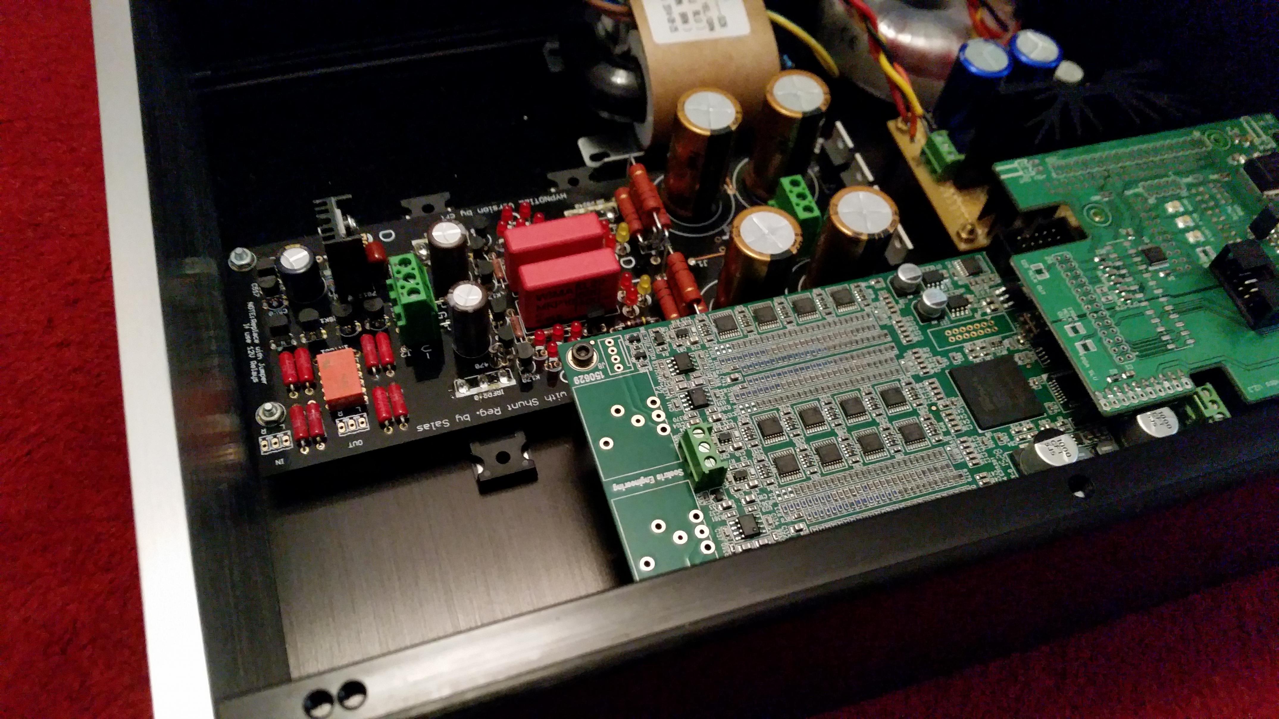

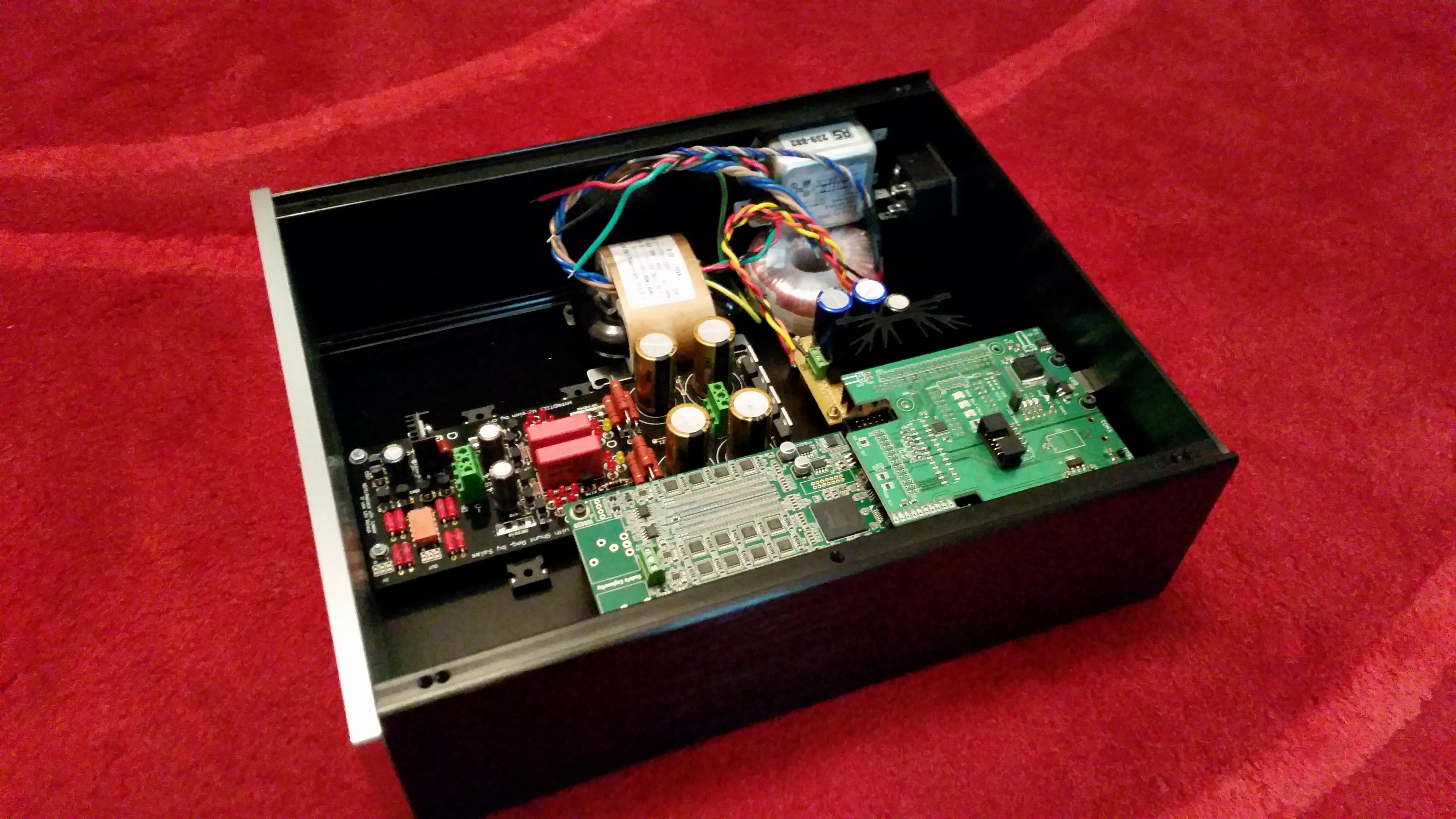

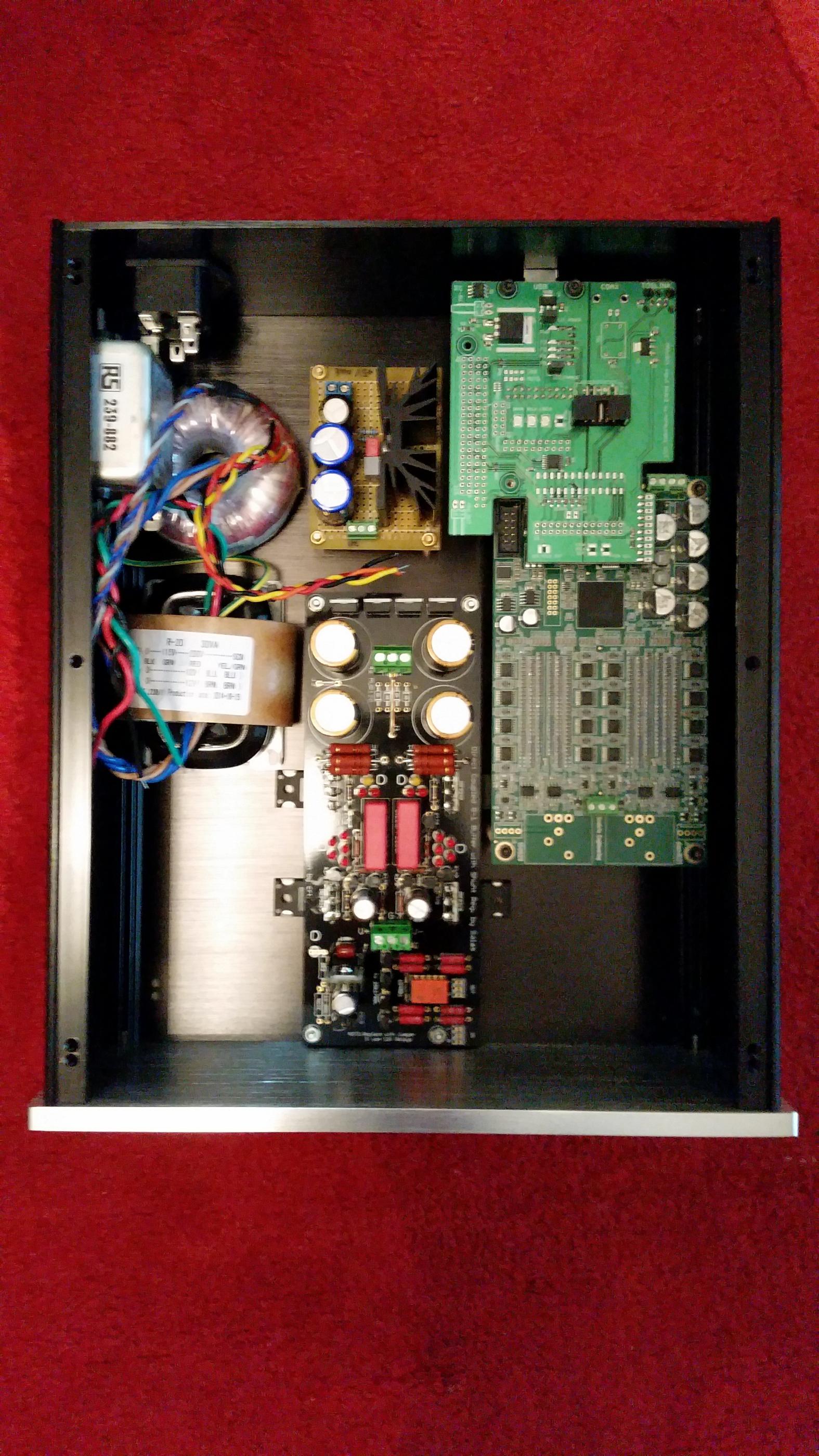

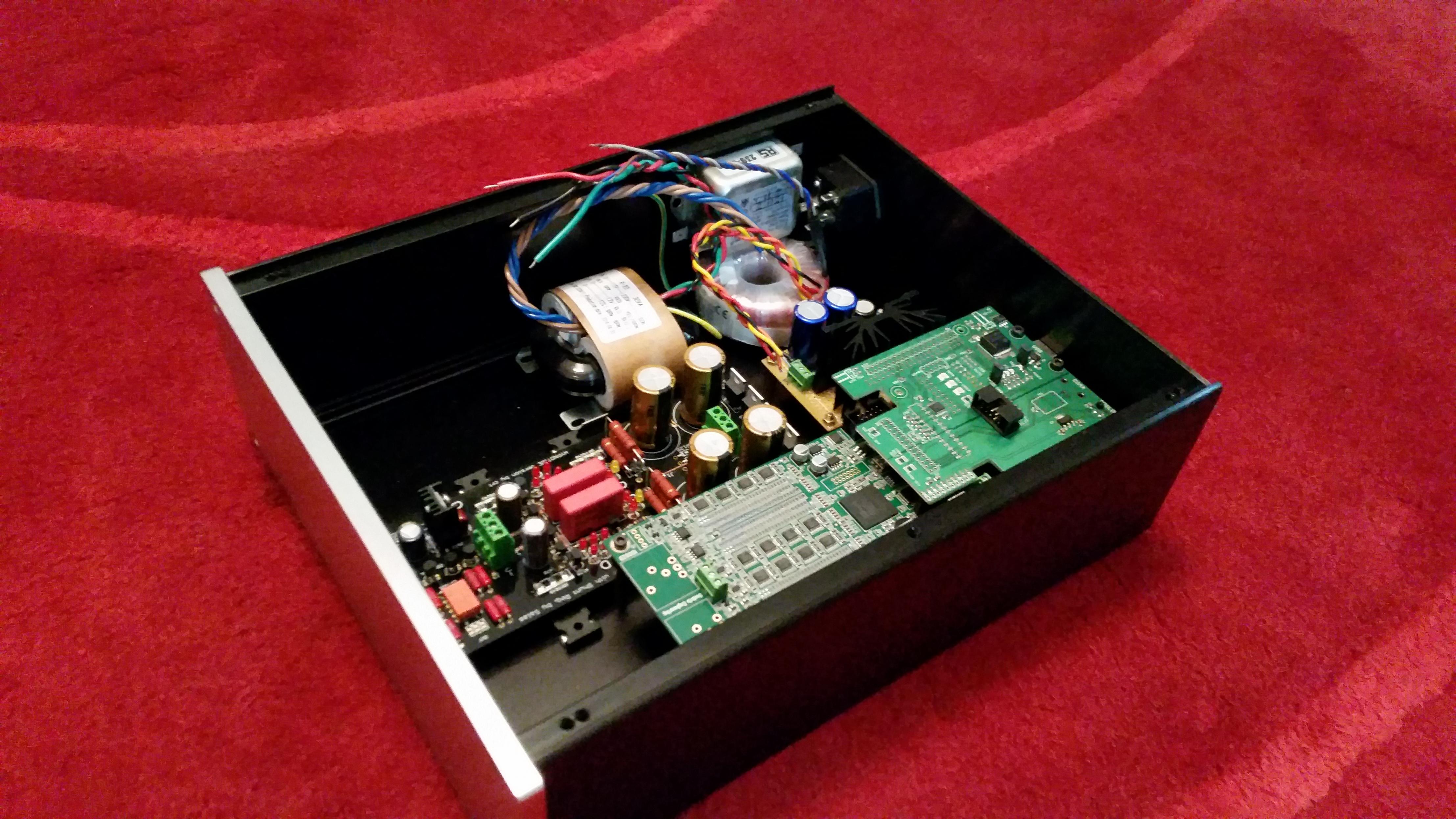

So what do y'all think about this layout?
The basic setup is as follows: dam1021 rev.2 with a DCB1 for power, output buffer and mute, a diyinhk XMOS USB receiver and normundss' input switch board.
For info on the DCB1 see http://www.diyaudio.com/forums/blogs/tea-bag/296-salas-hot-rod-dcb1.html should you not be familiar with it already.
On the mains side there'll be a fused power receiver with a DPDT switch (in the pics there's just a fused receiver though), a line filter (EVOX, rated 3A), a 30VA 2x12VAC R-core transformer for the DCB1, and a toroid with 2x6VAC. To power the switch board I'll be using the 2x6AC toroid and a nice LM317 prereg which will be going to the output tab of the 7805 on the input switch board, effectively bypassing the 7805.
The dam1021's raw output will go into the DCB1 buffer, the input impedance of which I've set to about 20k. The buffer sports a muting relay, so that's taken care of. The shunt regulator of the DCB1 will also be supplying the dam1021 with 10V of the finest DC. The regulator's CCS is set to about 500mA, about twice of what's needed. The RCA output connectors will be located just above the input switch board.
I thought I'd run the layout by you folks before I start drilling. So waht do you think?
If you want to bypass the 7805 and use your own 5V regulator, you will need to disconnect the 7805 output pin from the PCB. I have just uploaded an updated document with details on various supply scenarios, check the "Using external 5V supply with onboard 3.3V regulator" section. Link to the doc is in the first post of the GB thread.
Since you don't seem to have anything that actually requires a 5V supply, another option might be to build your LM317 regulator for 3.3V output and bypass both onboard regulators.
