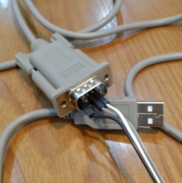

Could some kind people quickly confirm that the serial - USB converter with output 5V is OK to connect with DAM?
I just bought Unitek Y-1050 from a local store, measure with multimeter I got GND - TX is -5.5V
Thanks a lot!
Thanks a lot!
