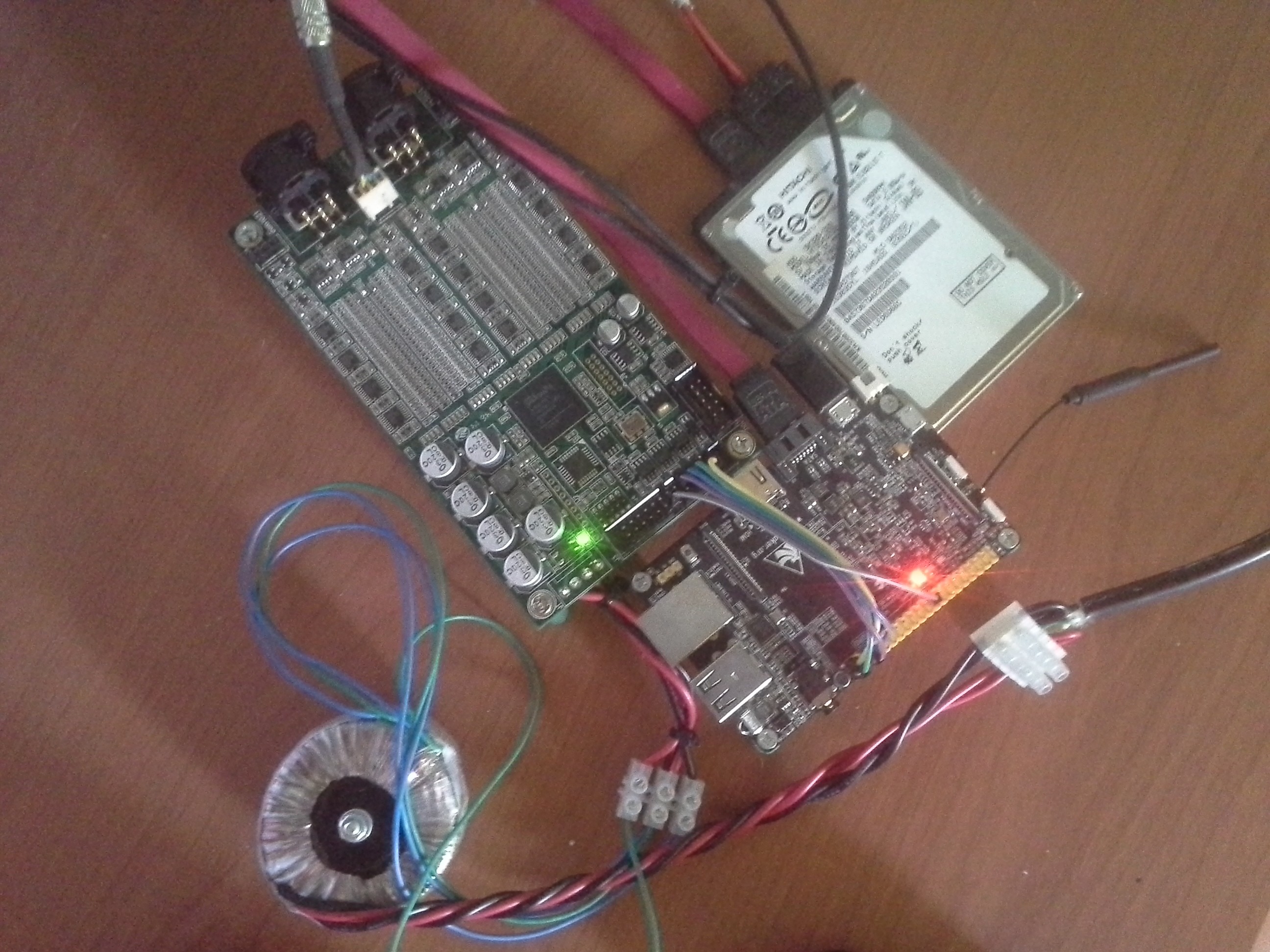

Hi, I want to share my crappy build. It consist of the dam board powered directly from a 7 VAC antek traffo, the i2s source its a banana pi pro running mpd and the files are in a old sata drive, the banana and the HDD are powered from a two port 20W cellphone SMPS. The unbuffered out are conected to my old and trusty Logitech Z-Cinema, but in the future I will be using the balanced out in to a pair of LPUHP amp powering an Alpair6p based bookshelf... Some crappy pictures... and sorry form my bad english
Looks like a great start. It looks like you are controlling the banana with wi-fi (antenna?). Just curious, how does it sound and what MPD client are you using to control it?
Yes, Im using wifi (in the firts picture you can see the tiny antenna beside of the HDD, that come bundle with the banana pi pro, its snall but work great), but initially I was using the ethernet port. Cantata (linux and window version) and mpdroid are the client that I've tried...
To my sound great, better than the build in soundcard of the Z-cinema and a raspberry pi with a hifiberry dac... But this is my first full blow DIY project, maybe Im not the best person to give you the best opinion...
Do you use I2S "directly" to connect between Banana Pro and DAM? If so,how? need special setup on Banana Pro?
Wiht the banana pi pro you have I2S and SPDIF output (also 3v3 and GND), Ive tried both but the spdif out only have support for 16 bit resolution not 24 bit (it seems that this is a software issue, because the hardware should support it)... Follow this tread in the lemaker forum:
Banana Pro - I2S interface - Advanced users - Banana Pro | Banana Pi Forum
The last post, guide you to where donwload the correct image with the I2S driver integrated, how to activate the driver, etc... When you have the banana pi pro up and runing, with mpd installed, in /etc/mpd.conf make shure that you have selected the correct sound output...

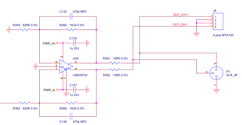

Subwoofer implementation
As a few people here are using this strategy I thought this would be an appropriate question for this forum.
I have been running my subwoofer amp from the balanced outputs and my main amp from the direct outputs simultaneously. When one of the rcas came unplugged I discovered that the sub amp is introducing phase cancellation in its mono summing circuit.
If I switch the one of the buffered outputs from +/GND to -/GND will it fix the phase issue in the summing circuit?
Also- would this introduce crosstalk into the direct outputs or otherwise risk harming anything on the DAM?
You might want to ask Søren...
Both XLR and the buffered outputs are run from the output of the differential opamp, so you are paralleling the loads. If you have RCA on +ve/GND and XLR connected as well the RCA will change alter the loading on the +ve and effect both RCA and XLR.
