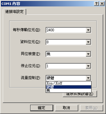

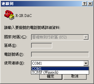

Here are a few cents that may be useful for Windows XP users:
1. When setting up a Hyperterminal (I use Windows XP),
please check the communication port.
My computer automatically select the wrong one.
You may use the hardware list in control panel to look up the com port used by the adaptor.
2. When setting the 115200, 8, n, 1 in a dialog box,
MAKE SURE that there is no flow control.
The default setting does not work with the Dam1021.

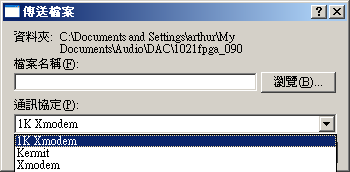

3. Make sure you select "Xmodem 1K" before you click SEND.
Sorry for attaching Chinese Windows dialog boxes, but boxes in other languages should look similar.
