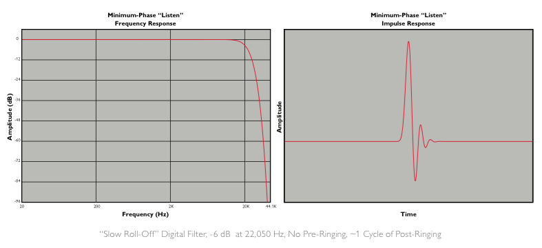

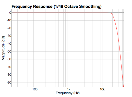

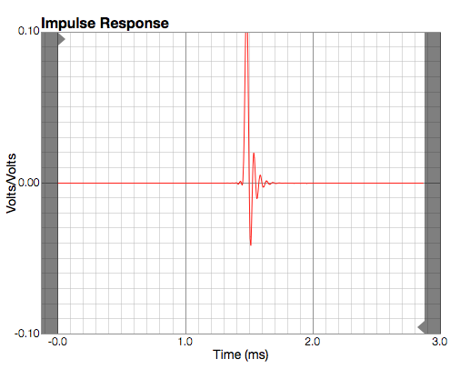

I been having a play around with approximating the "MP Listening" filter described in the Ayre MP white paper. Not sure that Søren would approve as the filter slope is way less than the 192dB/oct figure he gave for "real filters" 🙂 Anyway it sounds pretty nice, despite being an approximation.
While the “Apodizing” filter proposed by Craven solves many of the problems with digital filters, careful listening tests conducted at Ayre showed that the multiple cycles of post-ringing still created an artificial brightness and an overall confusion to the sound. We therefore sought to combine the best aspects of Craven’s minimum-phase digital filter proposal with a slower roll-off that reduced the overall amount of ringing.
The resulting filter has no pre-echoes, and only about one cycle of post-ringing. This filter is implemented in the “Listen” position of the new Ayre MP disc players. The result is simply the most musically natural digital playback available today.
I'm down to 2, possibly three cycles of post-ringing and a tiny amount of pre-ringing, as I've had to add a linear phase filter to get the response down above 30kHz.
cheers
Paul

zzzz - are you using Fuzzmeasure?
Yes. I bought a license about 5-6 years ago, it doesn't get much use but seems ideal for checking filter response.

Cool! It's a really nice bit of software. I was using it for testing the polar response of DIY stereo mic rigs.
Are the FM measuremnt real meas on the DAM output?
No. This is analysing the filter response:
rePhase -> 32bit LPCM WAVE -> Fuzzmeasure
