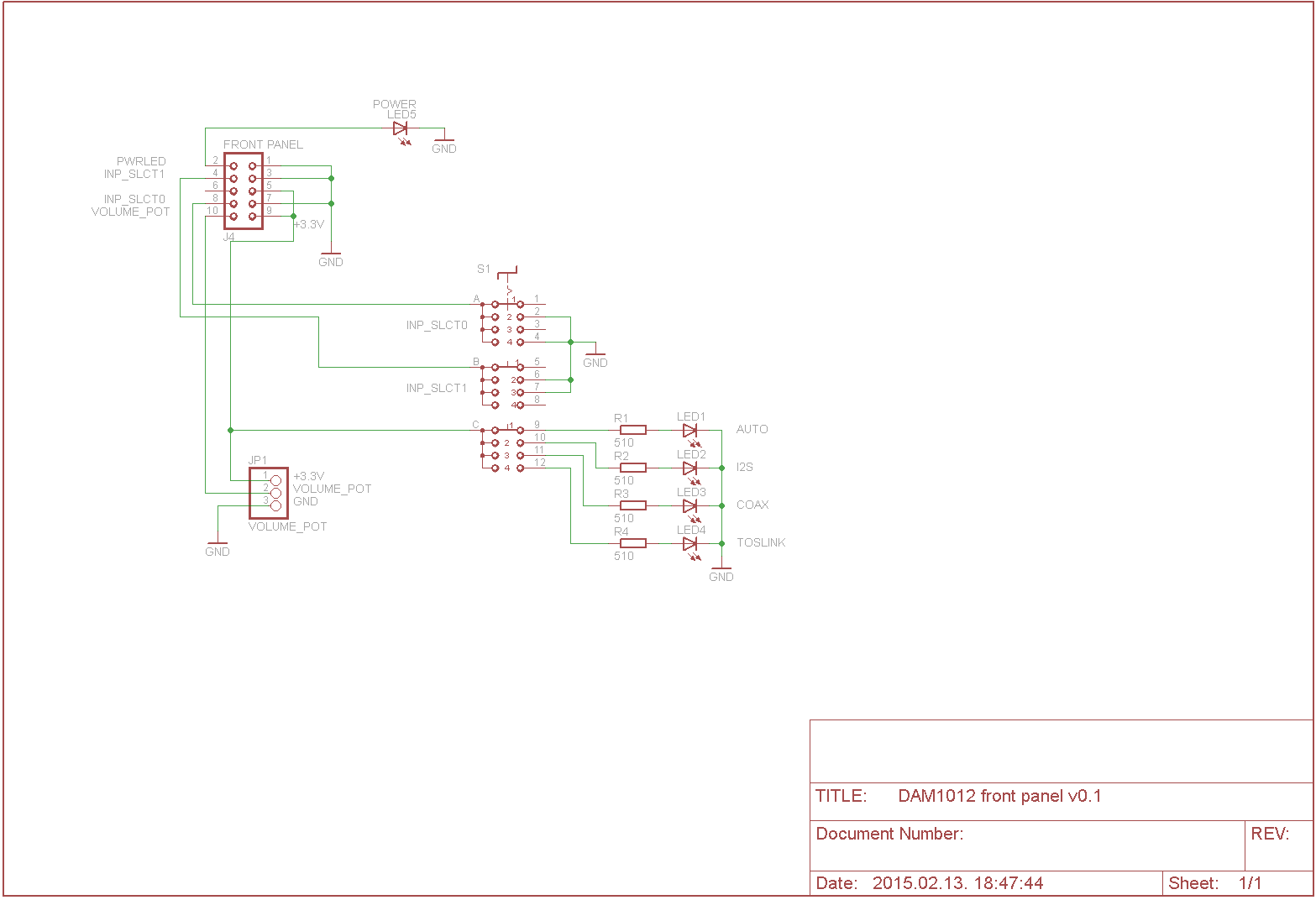

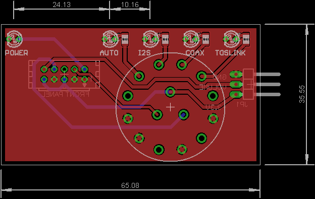

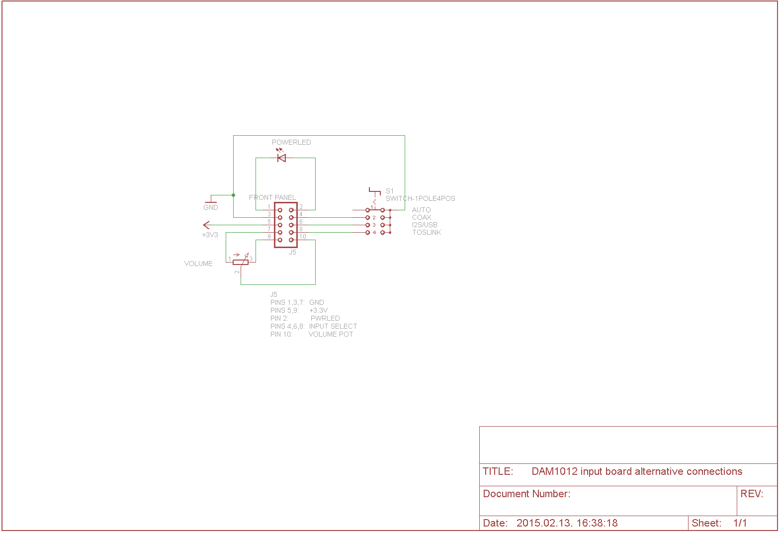

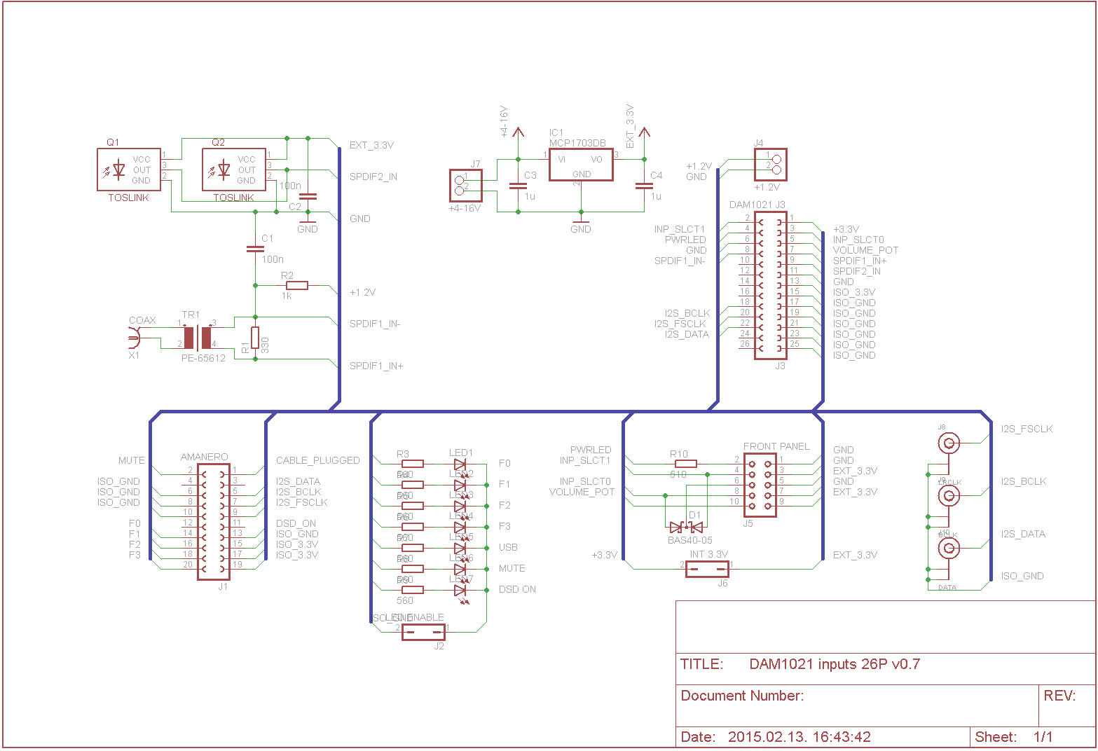

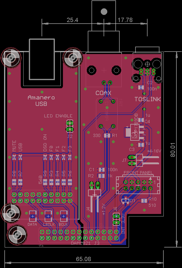

Here is the latest and hopefully final version of my input board and the front panel switch board.
The input board now contains optional schottky diodes to allow the use of a single pole switch for input selection. If using a common 3 pole, 4 position rotary switch these diodes are unnecessary. I have not actually tested input selection with the diodes.
The front panel board accepts Lorlin CK series switches, such as CK1051 or CK1061. Input selector and power LEDs can be soldered directly on the board, or 2 pin headers can be soldered in place of LEDs to allow different LED placement.
The alternative connection schematic shows how to connect volume pot, power led and single pole input selector switch directly to the "front panel" header.
