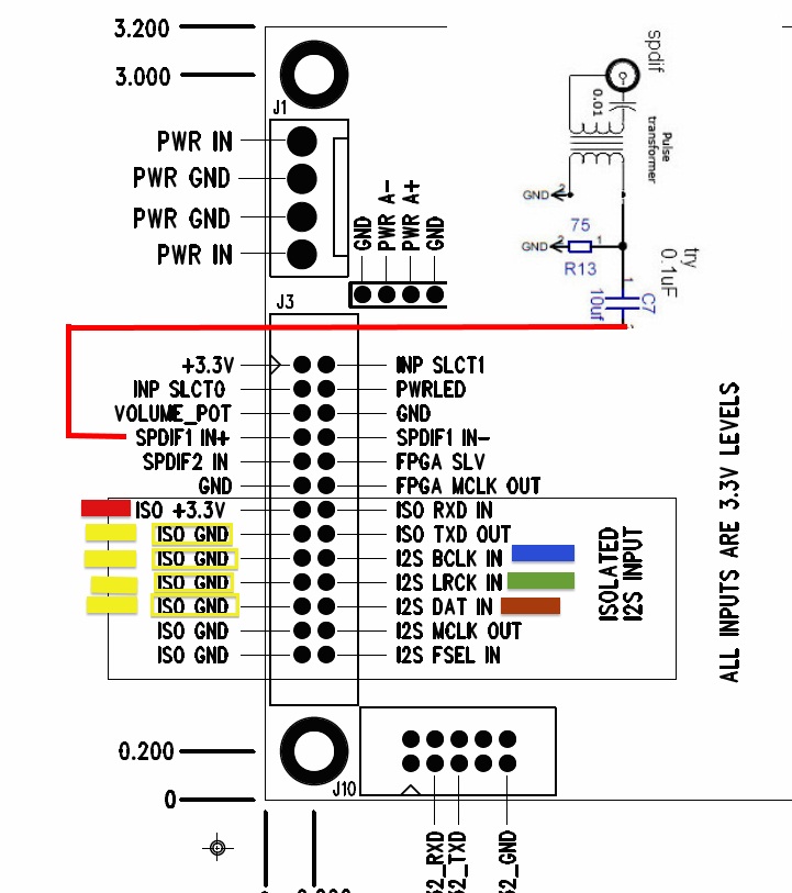

Hi!
I'm not a DAC expert like most of you here in this thread, so I would like to ask:
Can someone explain to me simply and clearly how to be connected this DAC to a "USB to Spdif" converter ?
(It is a CM6631 converter. I have a Spdif out RCA connector in the converter and a coax cable to the DAC)
If I use +/-DC, which pin is + and - ind the power input connector?
I got the board, but without any detailed user guide, or manual.....
Thanks in advance!

I thought it will be "plug and play" with a normal spdif coax source....Up to 24 bit / 384 Khz input from SPDIF, I2S and USB (via USB to I2S interface board), with isolation on the I2S interface.
Thanks!
I don't believe the board was ever positioned as such. At the same time, the pictures of the board clearly show that there are no such connectors installed on the board.
For connecting your spdif connection to the DAC you can follow the diagram drawn out by Soren (link on first post).. use SPDIF1
Based on the info provided by Soekris, SPDIF input should be like this?
(Edited, added trafo and resistor)
No - according to instructions earlier you should put cap and pulse-transformer in between the input and the board - to keep the isolation!.
Yes of course!😀 I knew that I have to make myself the connection.I don't believe the board was ever positioned as such. At the same time, the pictures of the board clearly show that there are no such connectors installed on the board.
Thanks, but I was afraid of this:Based on the info provided by Soekris, SPDIF input should be like this:
😕No - according to instructions earlier you should put cap and pulse-transformer in between the input and the board - to keep the isolation!.
That must be balanced s/pdif input. I suggest you to use s/pdif2
Tibi
It's actually really simple. One 0,1uF cap on signal. Then connect to the primary of a pulse transformer like the DA103C. Then secondary connected to the spdif1 + and - pins. So its actually only two more components.
Tibi
Spdif2 is for optical (Torx) reciever output directly only as far as i have understand it at least.
Tibi
Soren's post to help with connections
Hi Tibi!I suggest you to use s/pdif2
I am beginner in DAC them. So, please tell me how to connect my spdif Coax cable to tis connector: the inside "hot" wire to the spdif2 pin and what about the ground?
