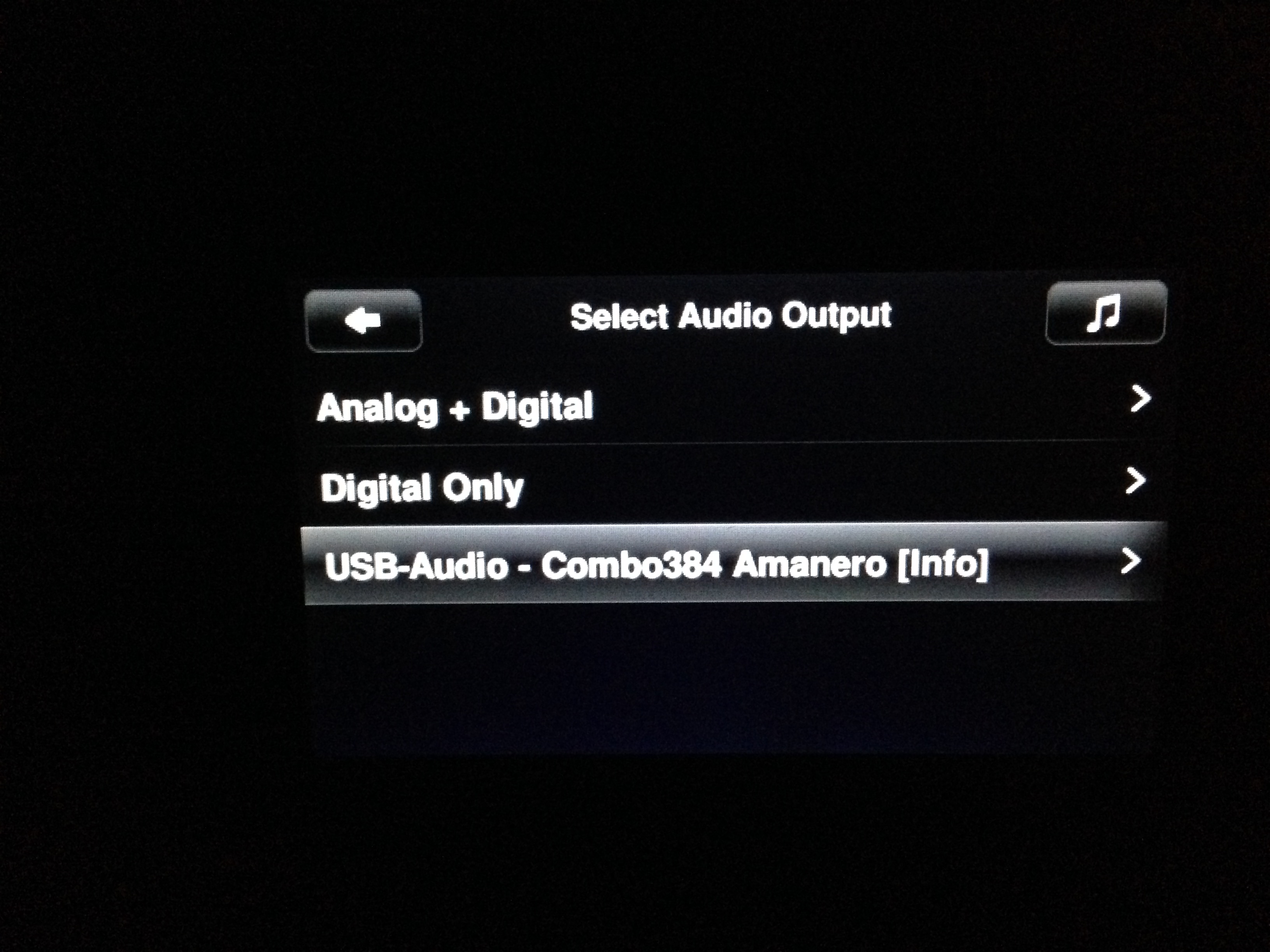

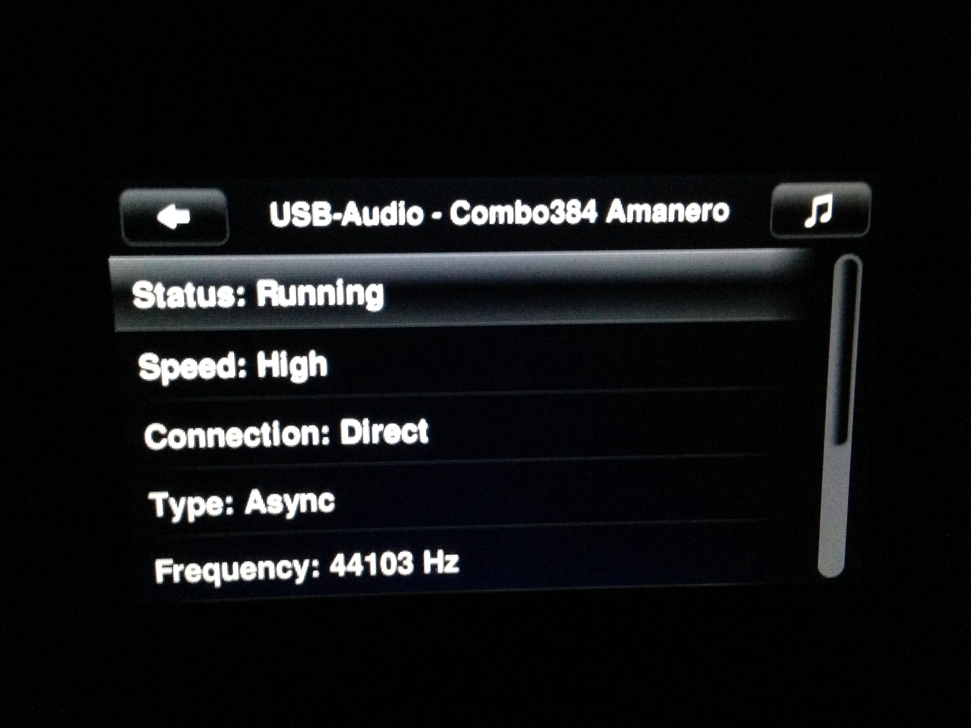

I have these component but no sound.
Touch on 7.8.0 FW. Digital Output (Digital Only) installed. A hub between the two.
Any pointers?
Any pointers?
Go to Settings/Audio Settings on the SBT, then under Digital Output select USB-Audio. (NOT any of the other options such as Digital Only). The SBT will reboot with a special kernel and the USB selected as digital output. Should work. SBT will recognise the Amanero board as Combo384 - Amanero.
I only see Digital Only or Digital & Analouge. No "USB-Audio" option. I can not see anywhere "Amanero"..
Okay then,
1. Plug in the Amanero board to the USB port
2. Go to Digital Output
3. Select the output that is NOT currently selected
4. SBT will now reboot
5. Repeat step 2. A third option ‘USB-Audio’ should now show. Select this option.
6. SBT will now reboot and you should have a signal out on the USB port when playing music.
(Go to Digital Output to check if it says ‘Combo384 - Amanero [Info]’)
Did steps 1-6. 2 reboots.
But.... no. Arghhh. I need this.
I see "Digital Output"menu in 2 places. Settings and in Advance Settings - does it matter which one I use?
The DAC ses the SBT because it blink during boot and "blops" at start...
