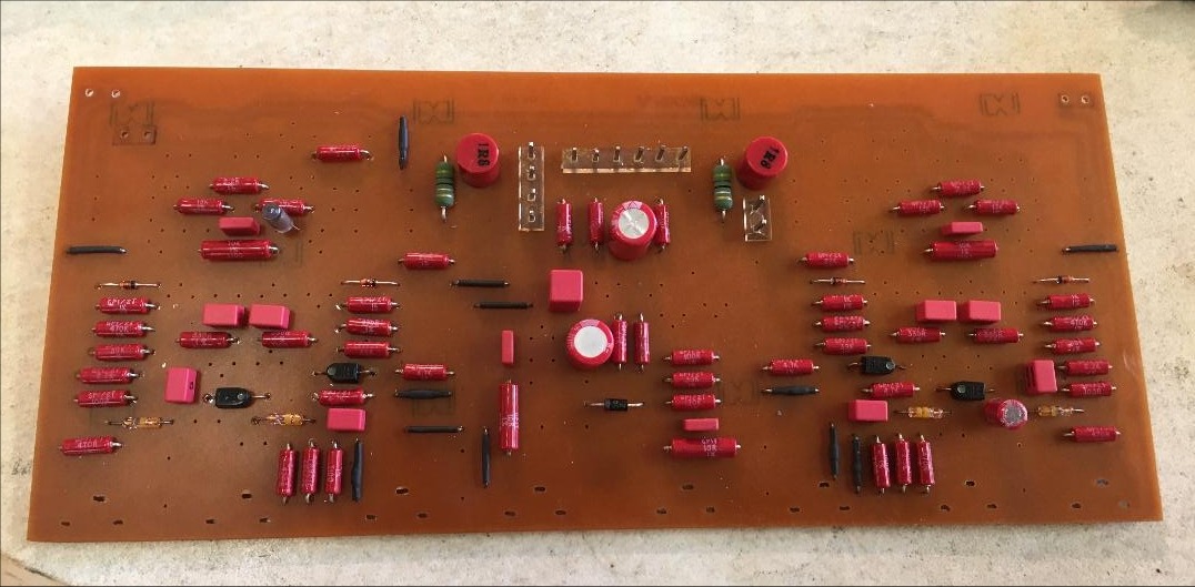

Sooo update
SH1S's re-used
1S1555 replaced with 1N4148
10E-2 replaced with UF4004
All caps are now Wima or Polymer types as appropriate
And frankly amazingly all transistors test good - that is a nice surprise
Found / discovered that the green on the bigger transistors was copper oxide emerging from under the tinning, while cleaning them with IPA and a scalpel (very, very carefully)
Anyway photo attached, 10uF Caps are (mostly) omitted as I need to check polarity - original silkscreen vs correct, there's an article somewhere suggesting they might be off
Very red isn't it
Andy

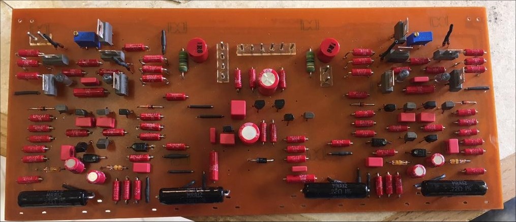

To Quote Agent Smith; 'more'
Couple of PRP resistors and some volts will ruin all the fun no doubt. But these are halcyon days, reality may still bite :devilish:
Nevertheless all transistors have been checked (again) before fitting and checked against photos of prior orientation to mitigate the silk screen... Slowly slowly the ice is thin :)
the 0.22 ohm resistors are 12w Mills wire wound, they fit pretty well, even without their insulating 'legwarmers' to prevent random shorts
Andy
