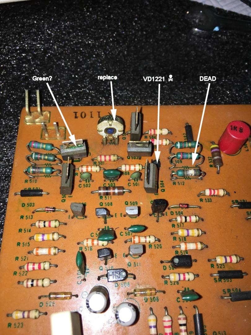

More news as I'm waiting for soldering iron parts. Me tip's disintegrated
The baby board is in position, so I've started to look at the amp board closely - see photo, the resistor marked dead was indeed that. It's counterpart on the LHS of the photo did measure 334 ohms - so browned to perfection I guess.
I'm changing out all the resistors that are spaced off the board anyway

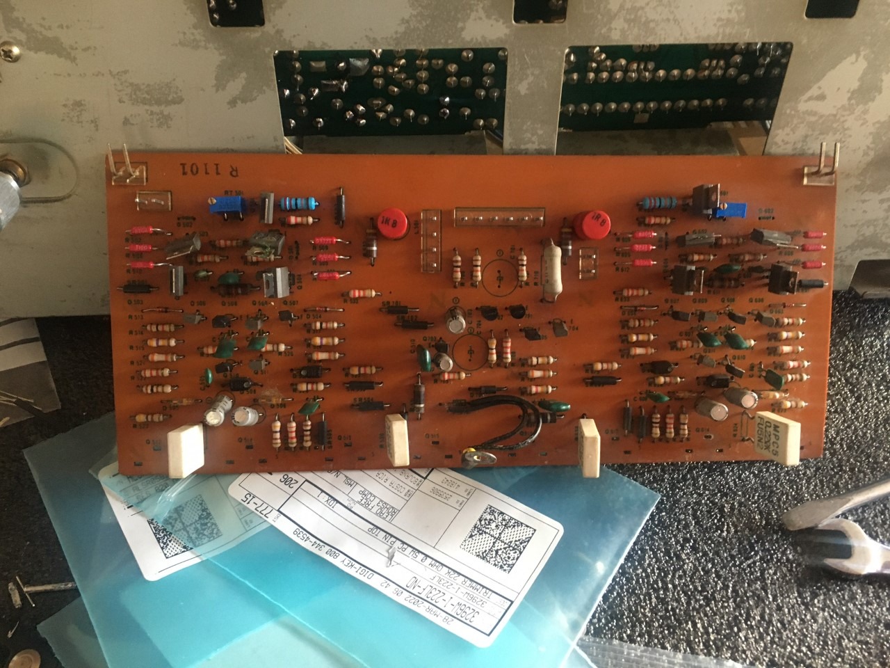

So new pots in place (Note to self - 22k NOT 2.2k), VD1221's dumped and series IN4148 preapared and ready - Looking promising PLUS a bonus new tool to form resistor legs so they're all pretty
But the V-FET daughter boards for the outer pairs are grotty with damaged insulators so I'll swap those out with parts from the donor.
And then the usually ultra reliable SONY board started to go south
Of the 24 connections between the board and the V-FET connections two are shot & completely separated from the board, one is sort of half there and about a half dozen are lifting (corroded) in someway :/ It's all that goop from spillage which, as a side effect has now been thoroughly cleaned away. Never had any failure of the V-FET boards till now

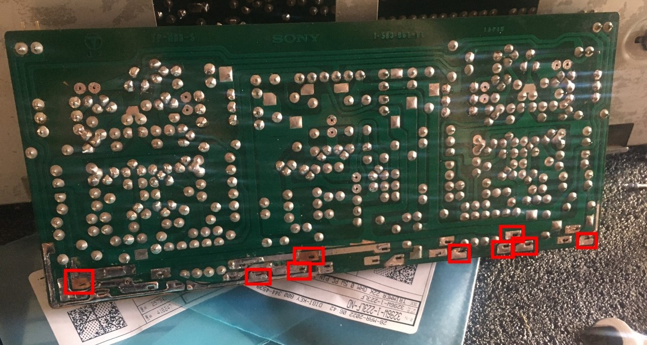

Pictures!
you can see on the track side photo I've already started repairing - Red boxes are pads that are lifting or lifted
Looking closely at the service manual this morning I realised that the track around Q512 - bottom right VFET is always a bit shady The track is cut away to form a C around the pin doesn't leave much left at the best of times
So I've been remiss in updates. looks like I've closed the browser and not pressed go :/
Anyway the board repair is almost done following the directions in this entertaining masterpiece to some degree
Seemingly, (for the UK) the Epoxy mentioned is not available in the same stores as the magic green pen! So I may forgo the greenness on the final board. As I work with composites daily I'm pretty impressed by the 316C spec of the epoxy - so that's what i used. Can confirm that acetone is very good at cleaning the board vs IPA & I cleaned between every step.
If I were doing this again I might use solder laced SMT flux for the lap joints, but they seem good. Tinned-cleaned-fluxed & soldered-cleaned & epoxied. Certainly easier to keep the new pads flat than I expected too
I think the sensible thing is to finish the rest of the board (the usual stuff) before adding the VFET daughter boards
