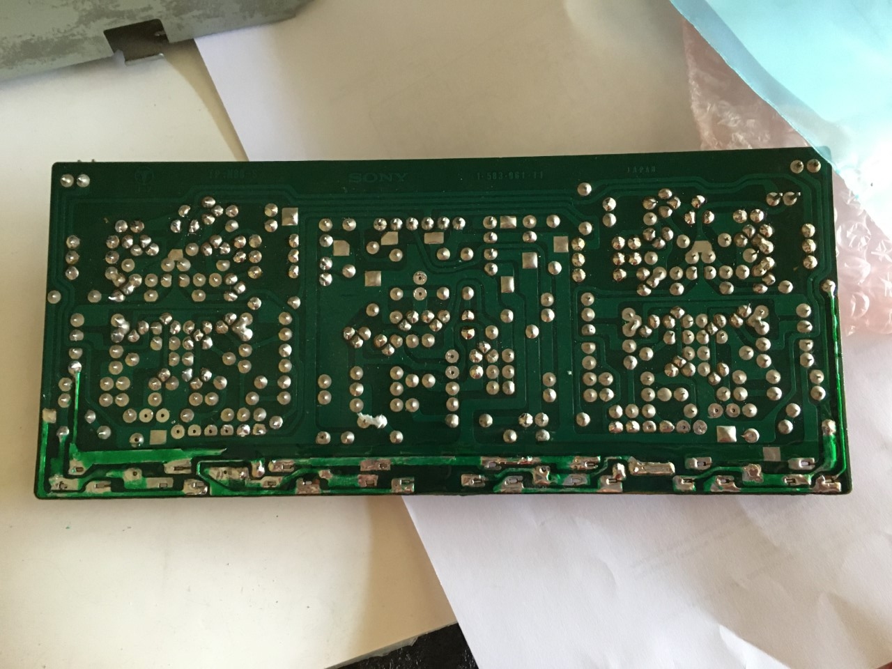

Finally update with pictures of the repair.
Its not pretty but it seems to suffice

Alas, 7 of the 8 VFETs are dead, they led a happy life... also a couple of resistors look burned up in 1 channel. I am going through the board slowly to find the cause, I suspect the Double Diodes may the the root, probably taken out a few other parts along the way..Thanks Andy,

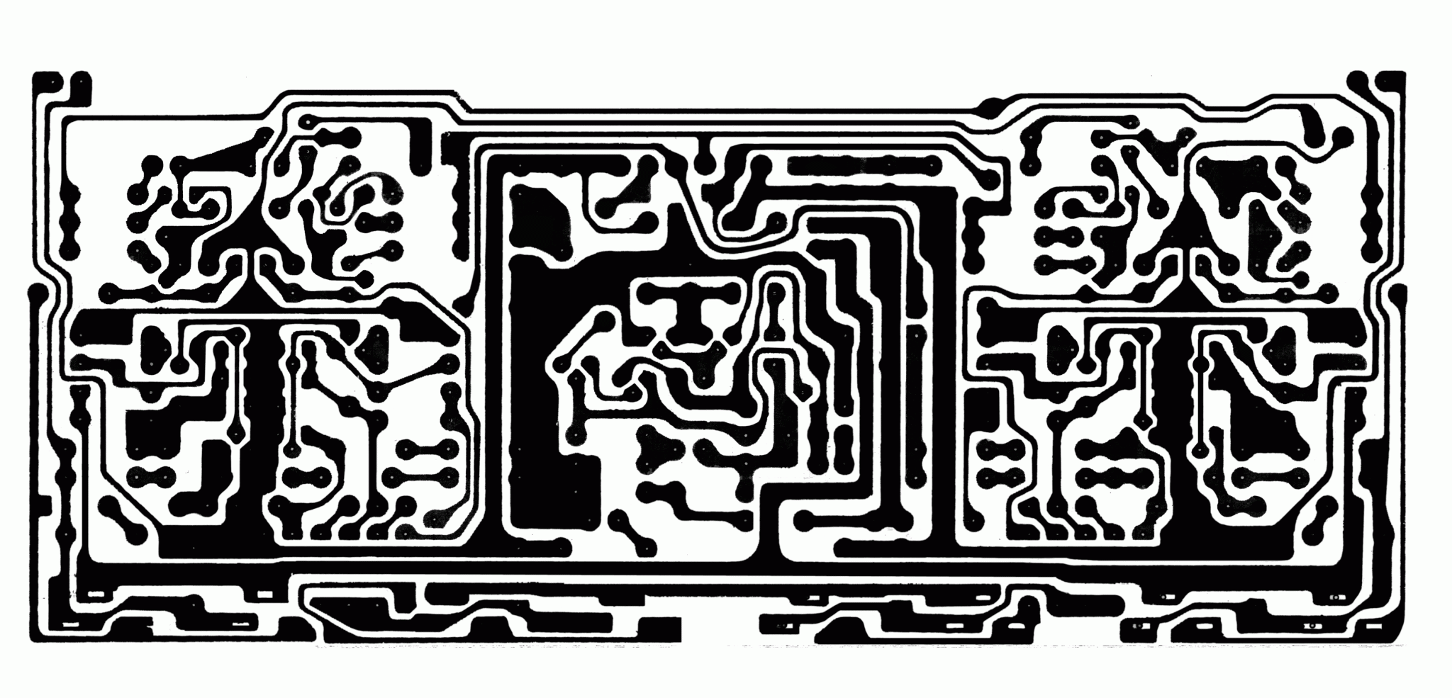

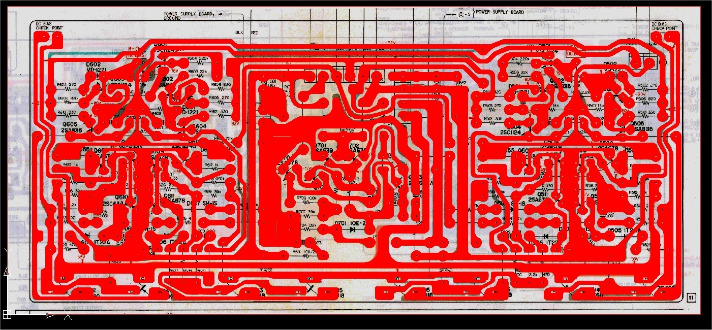

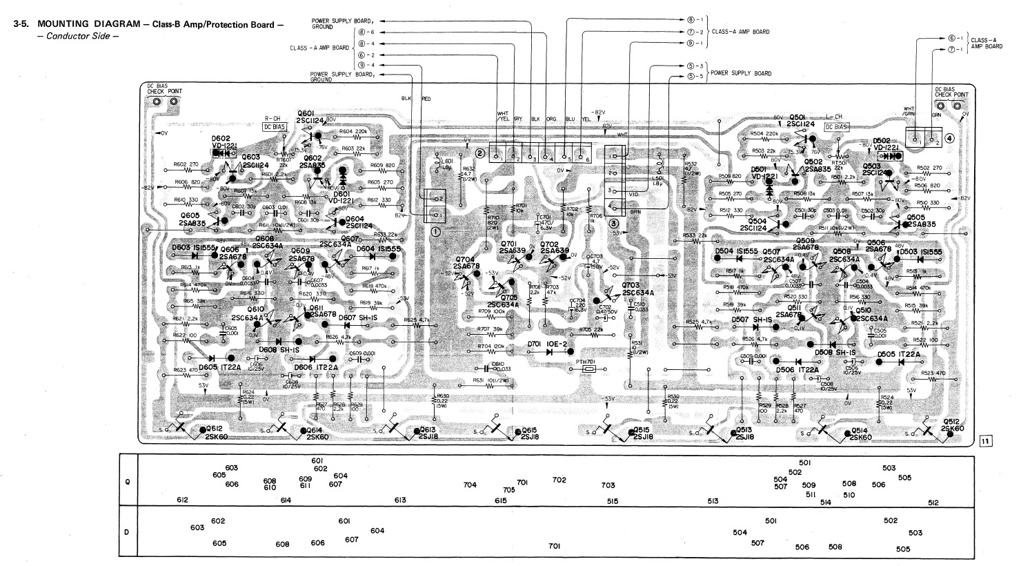

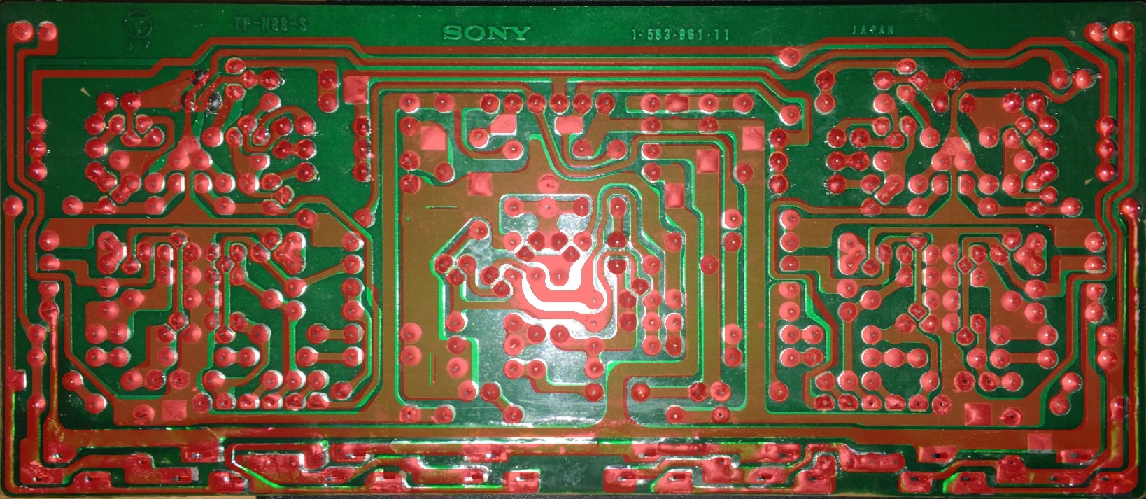

Thanks! But I've progressed from there. The original plan was just to scan from the paper service manual, tidy up and print, but then I had thoughts....Nice PCB art work there.
"AutoCAD" to the rescue (not a phrase often heard)
So it seems that Sony for the most part used a 2.5mm grid which makes life actually fairly simple > 8 hours later....
As this is now vector 'art' I can 'FIX' things, somewhat aware that the original 1975 draftsmen would have been in awe of the ability to just push a component along a pitch with just a click. Just as I am in awe at being able to create a board without it.
- First thing is that the bias pot on the right channel is sorta wonky, move it left 2.5mm and its as pretty as the left channel.
- I also thickened up / widened 'some' traces from 1mm to 1.5mm. Where possible that's been the route, again the right channel is more fiddly than the left.
- VD1221's, I've elected not to re do the board so that they genuinely become 2 x IN400x's. It's really only half simple on the right channel. and i'm pretty happy with the solution we've got
- The track passing between the thermistor's legs (PTH701)is offset requiring one pad to be compromised - not anymore.
- Now can I get the 10w 0.22ohm Mundorf resistors in there, the little cement blocks that were in there were truly grubby. Is there a 'hi-fi' version of these?
As for the Vfets who knew they were on a 30mm and 33mm alternating pitch
Not 100% sure on the rules, so I'm posting screen grabs in the knowledge they are useful for progress but that's it. If anybody wants AutoCAD files let me know, just have to figure out how to share.
Just need to scan the actual board to check for any Sony surprises - but progress! This was definitely the right way to go.

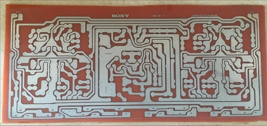

Another good reason not to bother! You're right that the "botch" works. I have heard mixed 'opinions on the thermal coupling and not understanding it well enough have always leaned on; "If Sony did it, and not doing it would have saved money, its probably worth doing"how are you going to thermally couple them [VD1221 diodes's] to the driver transistor? The “botch” solution is simple with some compound and shrink tubing.

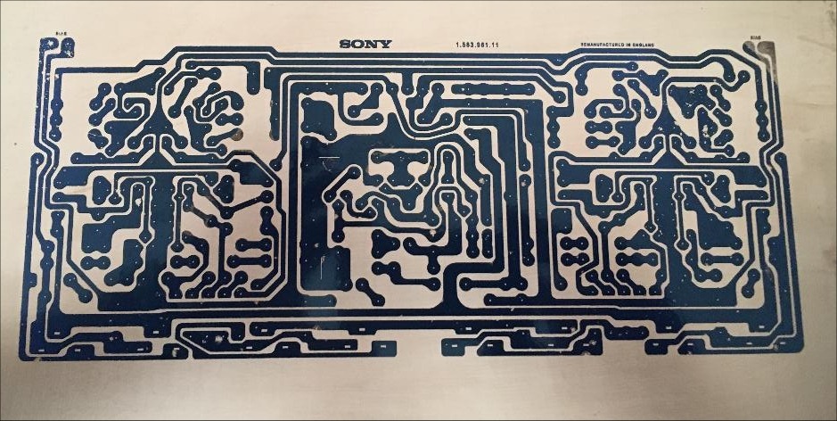

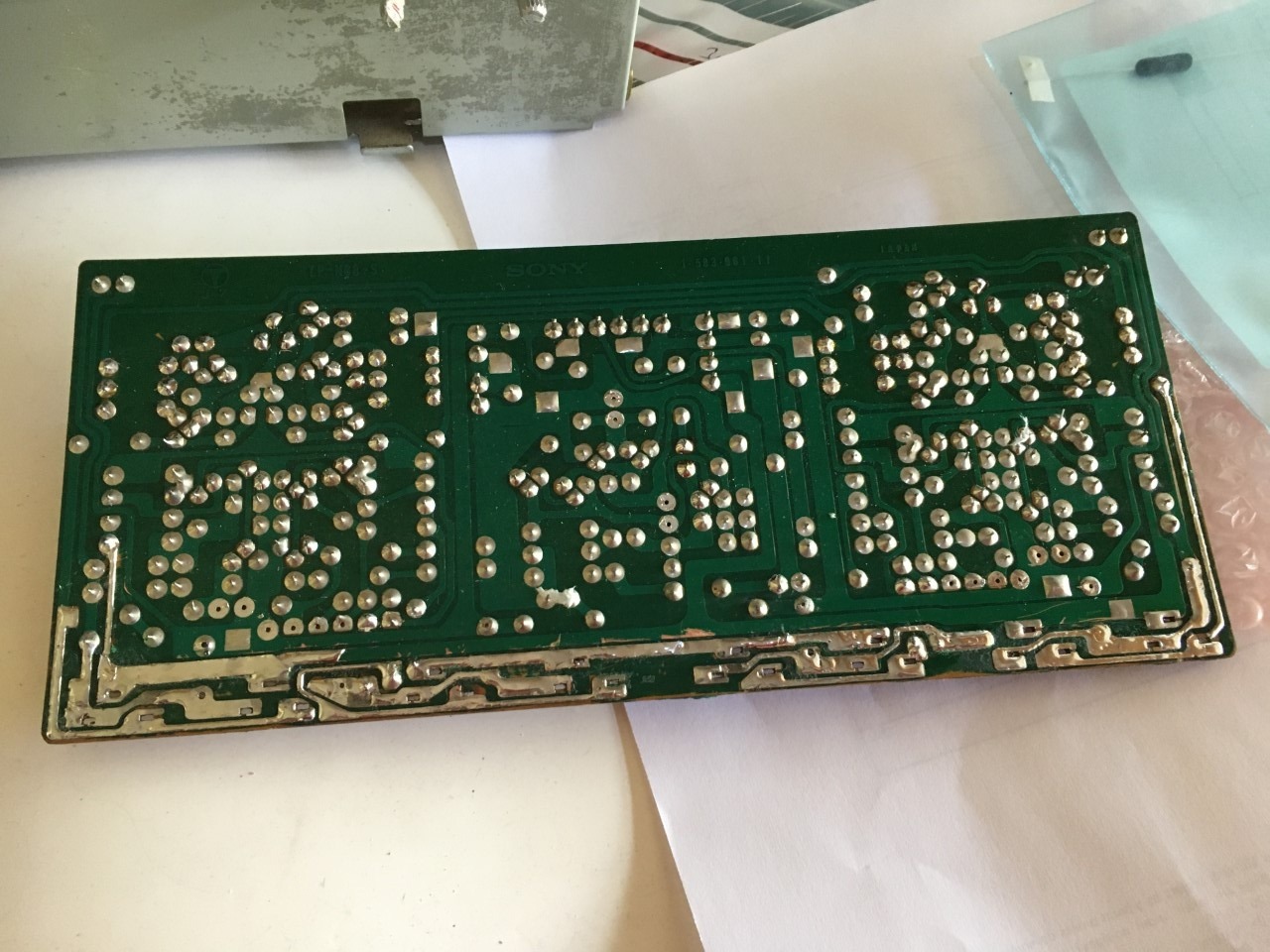

However, I'm mostly posting to confirm the board layout vs reality and show off my amazing 'press and peel' success with hindsight the "re-manufactured in England should have been GB" (Sorry Jon )
Now the joy of drilling all the holes…Board etched and tin plated!
Pride comes before a fall - this is never gonna work...
Andy
Ha Ha indeed, followed by the joy of 'oh missed one'Now the joy of drilling all the holes…
Genuinely, if anyone is looking for PCB drilling tips, get a drill press and some magnifying glasses (spectacles) so you can really see whats going on.
Andy
Worse! When foil from a pad wraps around a bit taking whole track sometimes. I would drill before hand if doable.Ha Ha indeed, followed by the joy of 'oh missed one'
SKIPPED
Andy
Not sure I follow, I drill all holes on the board first then check and check again - still miss ones where the pilot hole has gone AWOL. But if the whole track goes I'd consider it a bad board - still curse tho' that's how I got into this mess in the first placeWorse! When foil from a pad wraps around a bit taking whole track sometimes. I would drill before hand if doable.

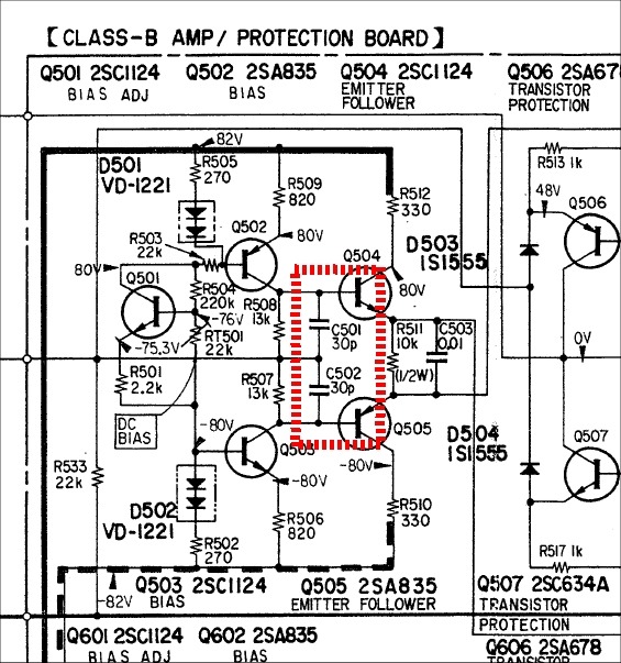

Meanwhile, all this fiddling has prompted capacitor questions.
Ceramic capacitors are 'BAD' (apparently they are not audiophile enough IIRC ) and I do have the option of stuffing whatever I like in the new board. These are decoupling the base on the (helpfully annotated) emitter follower 30pF
I have some 47pF polystyrene, is that an upgrade, or am I going down entirely the wrong rabbit hole. Any semiconductor ppl / actual electrical engineers care to help? (is that noob enough)
Finally, the board has been test fitted and components are going in, resistors and jumpers first...
