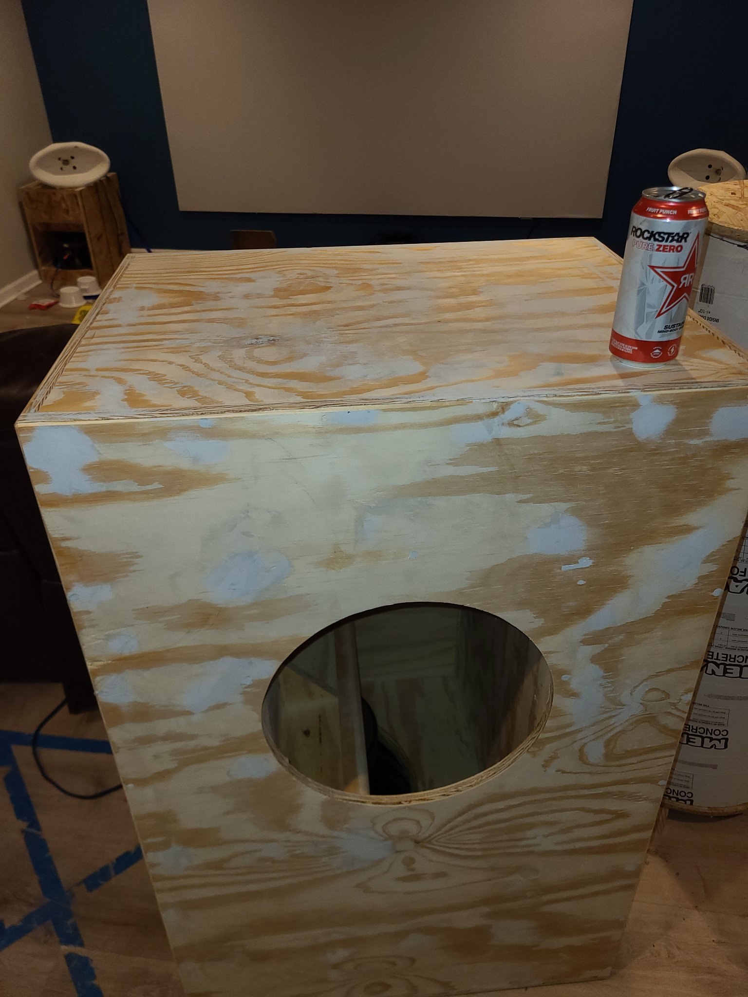

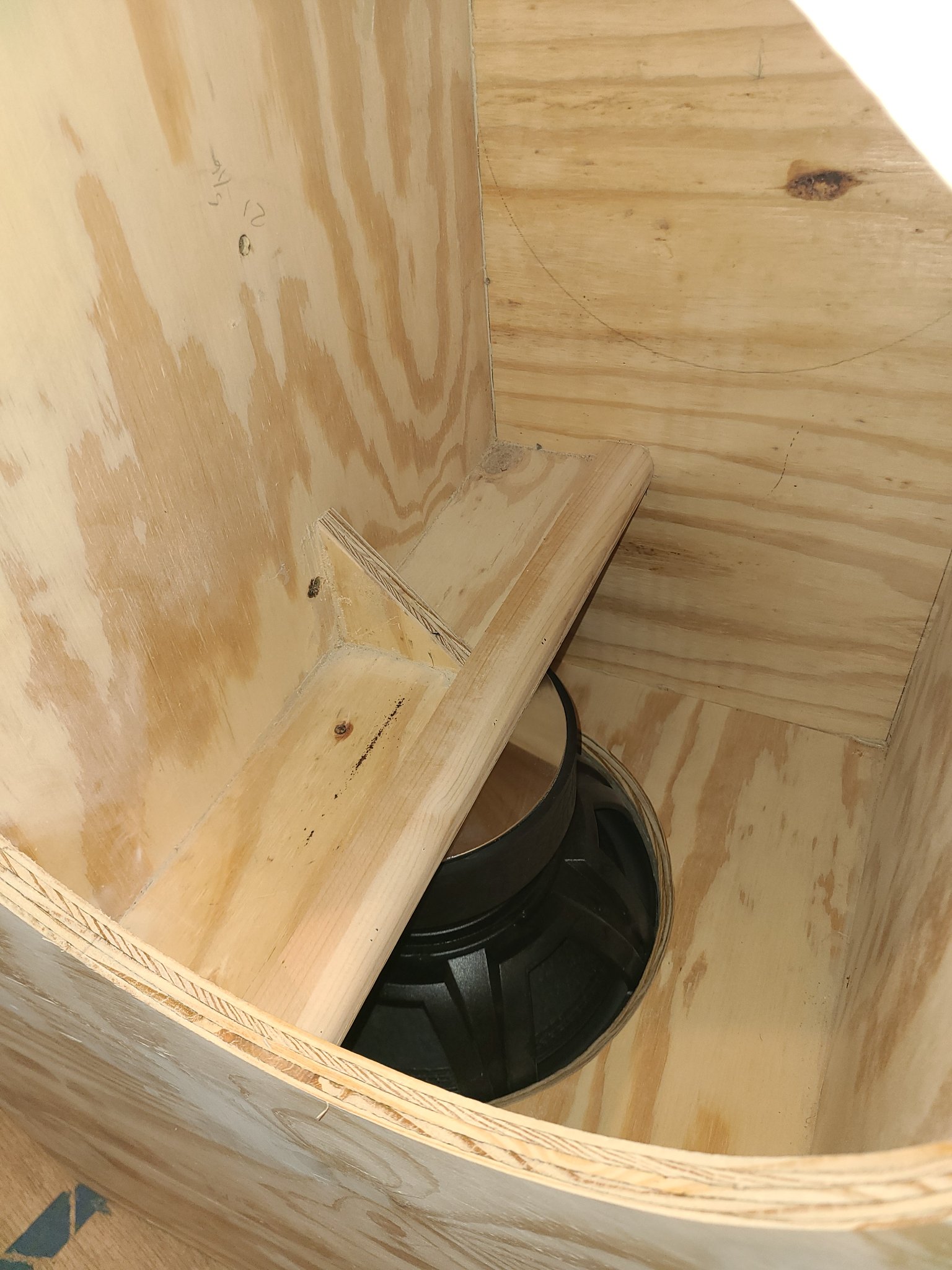

Soooo, unfortunately i tried to build the largest box i could fit in my truck and it wont fit 😆. I could probably make it fit but im not that ambitious. i really love it in my ht. Wayy overkill. i have to turn it down 12db just to get it close to the rest of my system and its still boosted but its perfect. Nothing wrong with headroom! Ill see about getting some measurements but i am not doing groundplane. Sorry. Im sick of moving this thing. I can do some mouth measurements and room if anyone is interested. But thats the best i can do!
Not much to look at but im adding a port flare and 2-tone paint
Pics

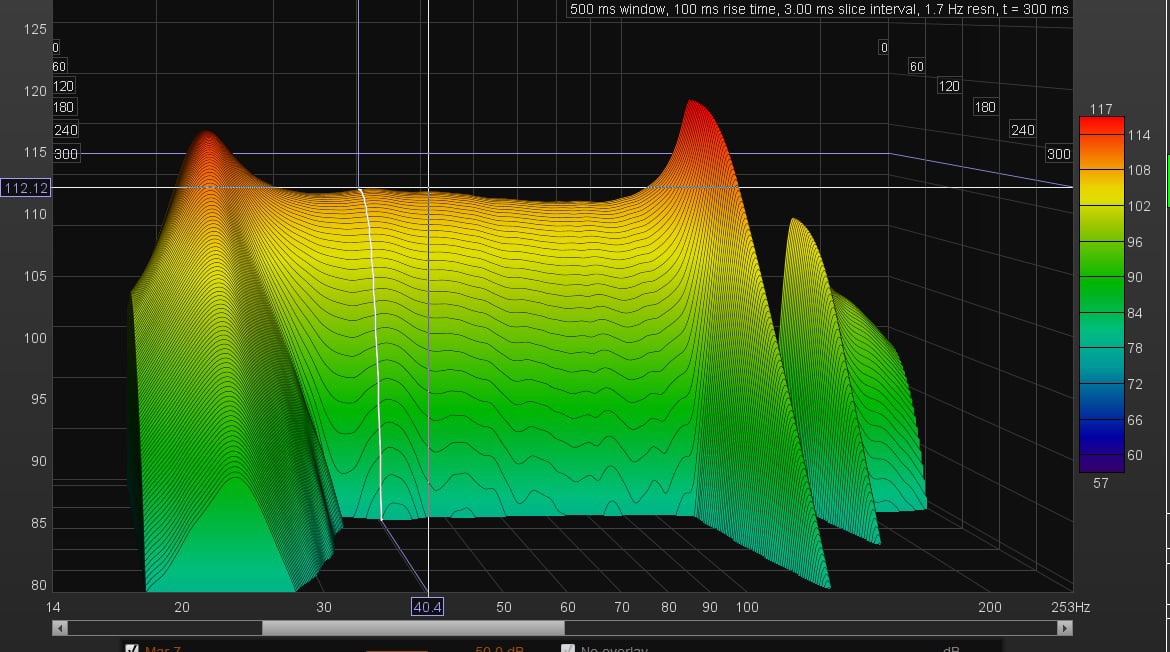

I love the sound of it. Its very impactful, digs deep, and loads the room with bass. There is a significant amount of group delay so i wouldnt consider it an sq woofer, but i have no problem being critical of my projects. Personally i think it sounds very good and the only time i notice GD, when not being critical, is during certain chords of bass. For movies and bass heavy music this thing is an absolute monster and i think it sounds great on heavy metal. I am a big fan of meshuggah but i often feel like the kick was never mixed with enough impact in their music. This cab is definately tuned to bring out the kick with a spike @74hz. Concert level impact is no problem. I would love to see how this compares to ricci's cabs like othorn and gjallarhorn since i had considered making those. Othorn is 3cf larger and less extension and gjallarhorn is 6-7cf larger with better extension. I imagine othorn has more output capability and less GD. Othorn is more complex to build. this cab works for any subwoofer with a displacement of about 1800-4000cm3, a vas between 40-90L, and a Qts of .3-.7.

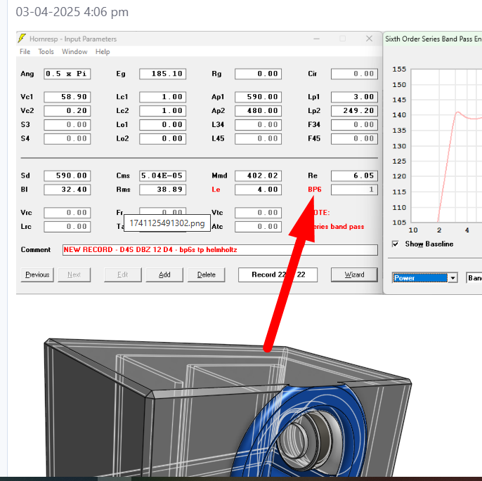

Side note, even though i modeled this using bp8s in hornresp i consider this a bp7s because there is no chamber volume for vc2.
but your sim show as BP6!!... so ?Side note, even though i modeled this using bp8s in hornresp
its a 6th order, regardless of the model used to describe it? 8th if you include that last spike at 110hz or so?
