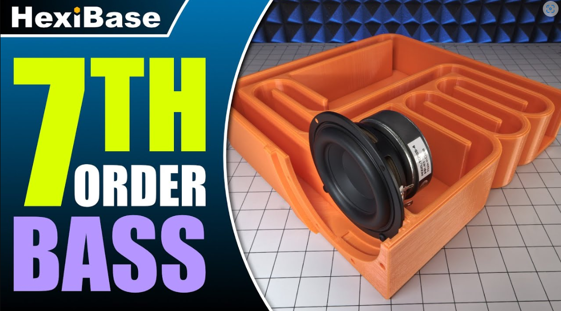

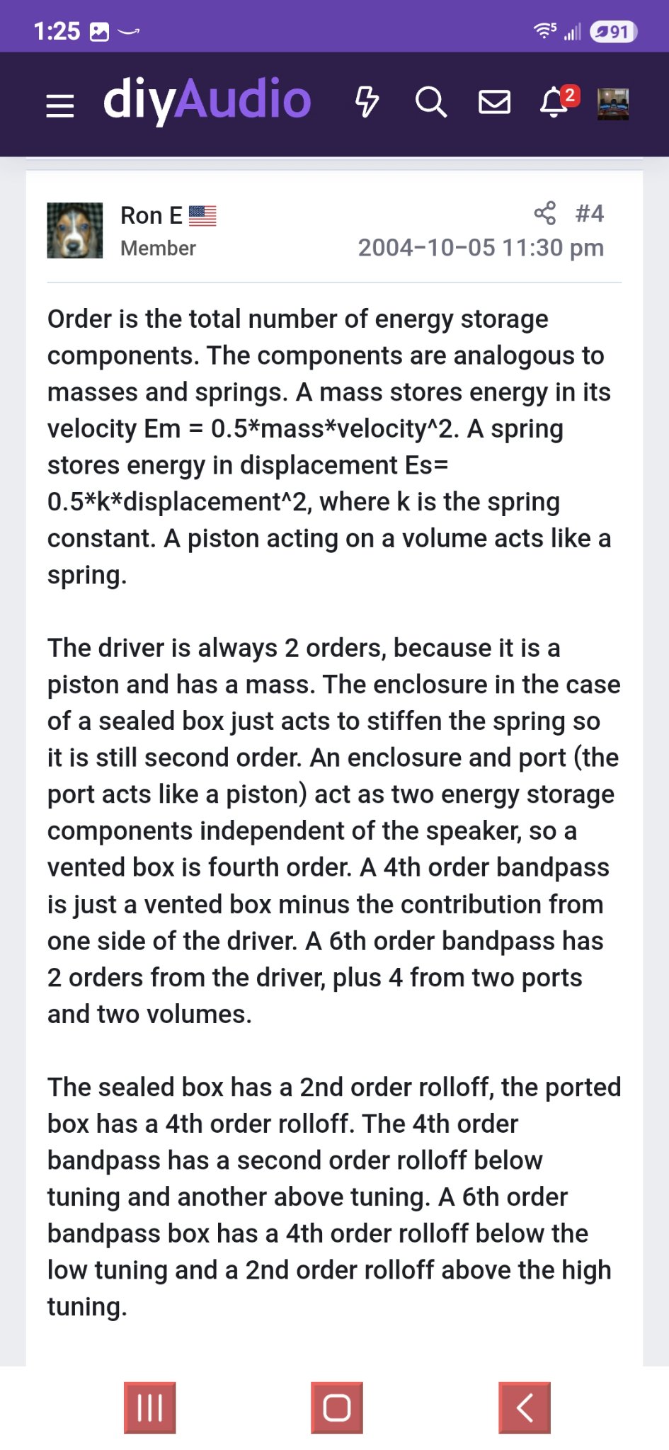

I have learned a lot from Pete over the years and he was one of the first influencers on YouTube for this content. Maybe instead of dming me and/or apologizing for being "pedantic" you should just realize that you're actually being "eristic" and "quarrelsome" and try something different.
PS, I hate to break it to you, and whoever else's reputation your trying to muddy, but a TL is, in fact, a 3rd order enclosure. All you have to do is COMPARE the responses. Which btw, that info is on NO Hexibase video.
a front loaded horn is a common example of a third order bandpass. decware housewrecker is a 7th order bandpass. hexibase has created multiple examples of odd order enclosures.View attachment 1434034
Love his channel!

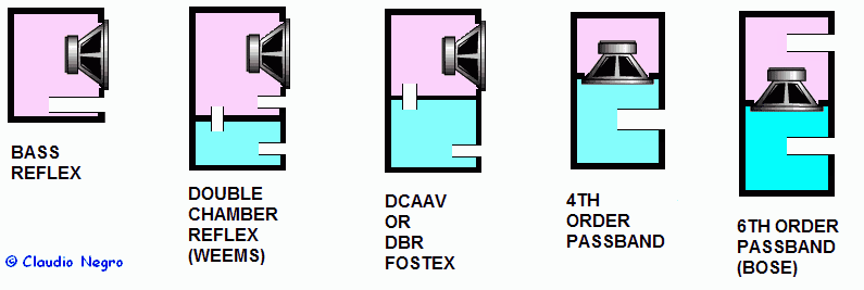

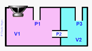

That chamber is vented, so that's 2 orders, not 1.
A sealed enclosure is 2 orders, whether it's the driver providing the output or a hole (acoustic guitar).
This enclosure is still a BP6S. The chamber is basically an irregular expansion of the low tune port.
At the end of the day, acoustics are complex and nuanced with often overlooked and misunderstood variables. The dilemma here is obviously two or more interpretations on what defines an acoustic order. Most would say chamber #'s, apparently some say impedance spikes or dips. I say that the rolloff on either end of the pass and is what determines it because that is the order. I don't really care if you stuff the woofer into a soft turd. And with that, I will just agree to disagree.

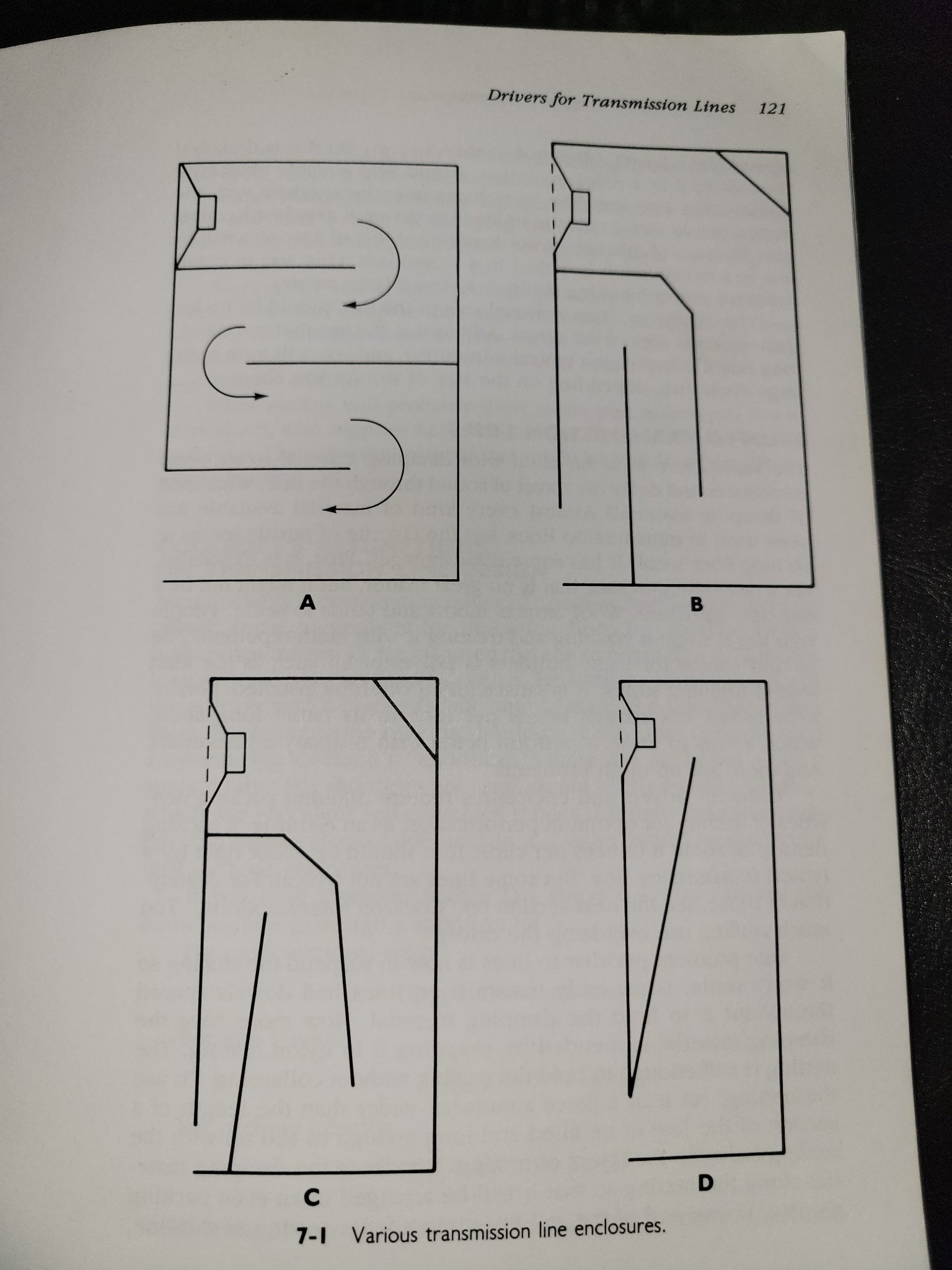

A TL is nothing more than a BR enclosure with a 6 foot or longer port.
