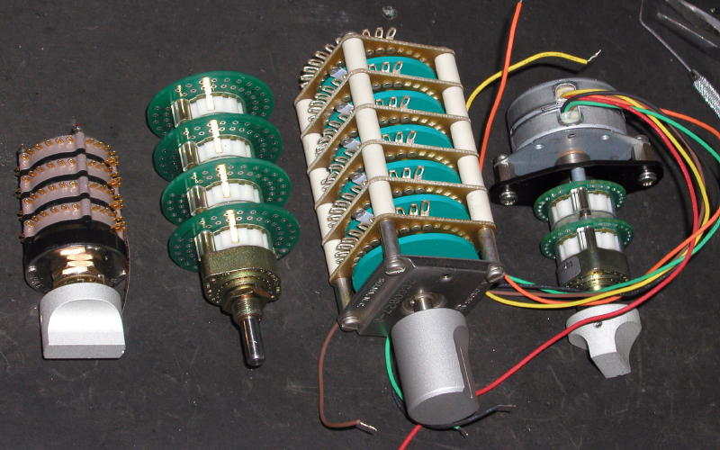

Thanks for all the reactions. I bought and installed the DiyFidelity 25 k stepped att. and it works great. No irritating clicks anymore and even much better sound... 😛

25k works great. Likely no oscillation, though I still have to measure that. At least the sound is great so I suspect no oscillation ;-)
The amp might even be more stable with 25k (lower resistance usually means less input noise). I am still surprised how much the sound changed here with this attenuator. I have to investigate this for sure!
(actually it was the change in sound I was looking for for two years 😛)

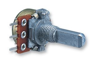

Peter Daniel said:Recently I've been experimenting a bit with different pots. Here's what I tried (from left): Taiwan Alpha, Panasonic, Nobel, PEC carbon, discreet switcher based on fixed series Vishay/tantalum and switching Holcos for shunt.
None of those pots is completely neutral and all of them show their sonic signature when placed at amp's input.
Thought that there were no audio pot better than the obsolete ALPS RK40 series (the 40mm black body ones).
How these compares to PEC pots?

Guys, I have an ALPS RK163121019AJ variable carbon pot. It has a click right in the middle of turns (12o'clock). I was wondering if this is a volume control pot or a balance control? Sorry, very new in this.
If it's a volume control pot, would anyone share their opinions or experience, b4 I try it on.

George, any suggestions on how to confirm it short of putting it into an amp?

Just wondering... since there's been so much talk about pots and attenuators for volume control, can anyone please share their experience with relay-based stepped attenuators? In theory, they seem to offer the best of everything:
- Precision resistors in signal path (no more than 2)
- Sealed long life relay contacts
- Better channel separation
Only disadvantages I can think of are:
- Higher cost & complexity
- Need to carefully route control signals away from audio signals
- Need to incorporate some form of digital control system
There is also the IC-based digital stepped attenuator chips to consider, e.g. TI PGA2310, Crystal CS3310. Conrad Johnson and Jeff Rowland for example, use them.
Can the experienced folks please share their OBSERVATIONS? I know this area is highly subjective and all I am asking for are listening impressions (and related areas such as feel, quality, lifespan, usability...). Thank you in advance for sharing. My diyaudio budget is limited - I can try a few of them but not all of them so your input is much appreciated.

You missed out the biggest disadvantage (for me) which is the number of steps vs a good pot. In the end it comes down to what matters most to you.
Apart from that, everything else points to using a SA if cost isn't a primary issue, and SQ is.
