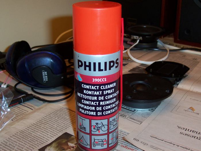

Nuuk said:
Yes, they are open to the elements but also open for easy (and quick) cleaning from time to time using a cotton bud dipped in Isopropyl Alcohol. And they sound as good as the others that I have using more expensive switches! :att'n:
What has always worked wonders for me is Philips 390CCS contact cleaner. The red one.
Made in Holland. 🙂
Nuuk said:
I hope that you are referring to cleaning switch contacts and not having a drink Carlos! 😀
Seriously, this solves problems that others don't.
Dirty pots, contacts... even to remove labels. 😀
My father always used this Philips contact cleaner, I saw this at home in his bench since I was a kid.
I tried others, but he was absolutely right: this one is the best.
I always have a couple of these at home.
