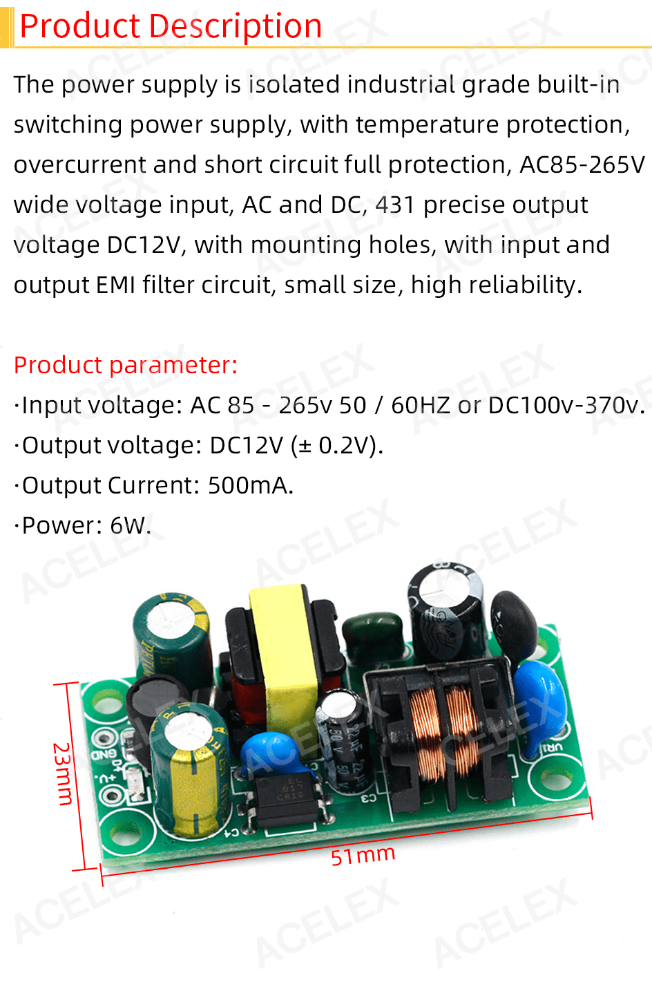

While it probably IS true that a 'cheapo' linear/traditional supply is more reliable than a typical SMPS, it doesn't include the full spectrum of possibilities.
The stuff on Ebay is designed under extreme pressure to reduce cost. If you're OK with that, it won't bother most of us here. But please realize that the product's reliability is likely lower than that of a work-a-day linear.

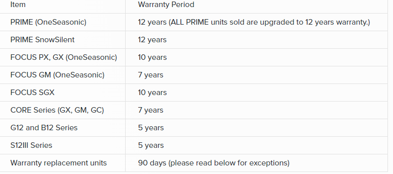

What can be said thought is, that build quality generally getting better, eg. the longevity of PC PSUs increased over the years, that's the warranty table from Seasonic, delivering efficiency of over 95% around 50% load. That's just very impressive and shows that it can be done properly.
I want to second Paul though, there is no point in buying cheap stuff!

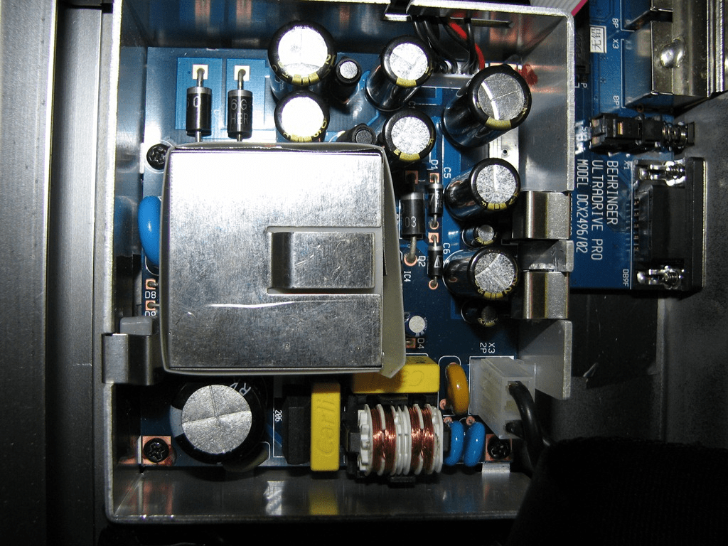

My tube amps mostly use linear for B+ and SMPS for heaters/bias. There are a couple that use linear for heaters, but I prefer the SMPS seeing as it weighs a fraction, is much smaller physically, and only costs 13$. The linear PSU I made for the heaters cost well over 100$.
My DAC uses an SMPS and it's on 24/7...
Here is a picture of it in a different device. I have the DEQ2496.
