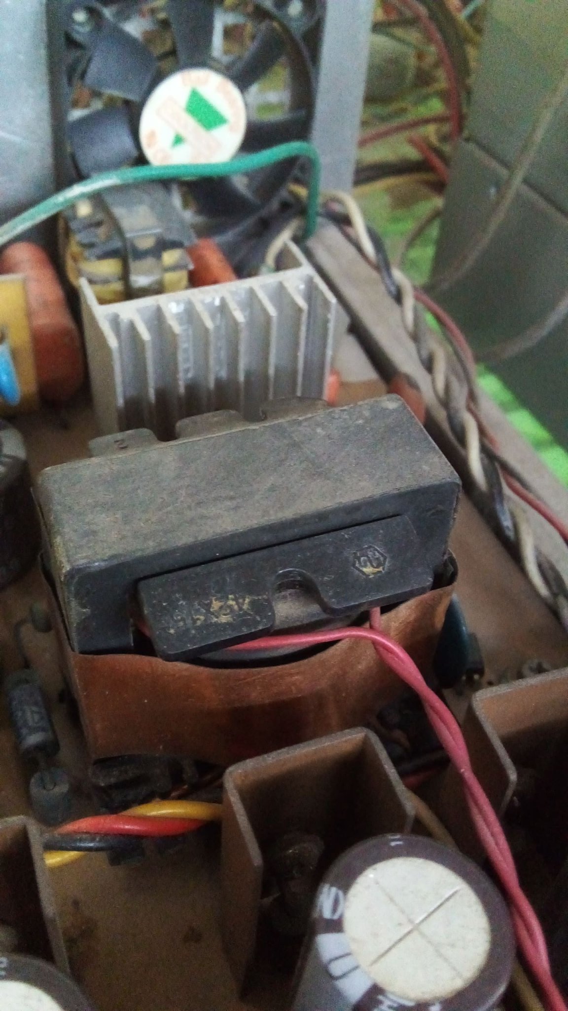

SMPS if carefully selected are very good performers.
There are mainly two kinds of SMPS: those derived from the Buck and those from Boost.
Buck derived (Buck, Forward (single and double MOSFET), Half and Full Bridge) are the worst choice. This is because they need an output inductor like those for choke input filter at 50/60Hz. This choke/inductor toguether output filter capacitor make a double pole filter. Viewed from the PWM control chip this is a low frequency pass filter with an inherent time delay to mantain the output voltage. So they are very utile for steady loads like computers, hard disks, and the like. But they are slow correction devices for load regulation.
ITOH the derived from boost topology and mainly the Fly Back (single and double MOSFET) are inherently higher speed because they use a much smaller inductor in the primary side that with current mode SMPS (UC384x and similar) completely dissapear from the transfer equation, remaining only the ouput caps. As they usualy have higher RF ripple, usually a small pi filter is used but its time constant and time delay are noticeably lower than buck, making them quicklier response than those. The Boost deriver are thus, clearly, the best option.
I made my SMPS UC3842 & STP7N60 running at 45KHz based several years ago and the regulation from no audio to full power is almost no clearly measurable. It can be found a high degree of "rectified audio" at the return of the control loop TL431 & PC817 at normal listening levels.
This data I learned from the two books I have for SMPS design: Marty Brown "Practical Switching Power Supply Design" and Abraham Pressman "Switching Power Supply Design" and confirmed by my own.

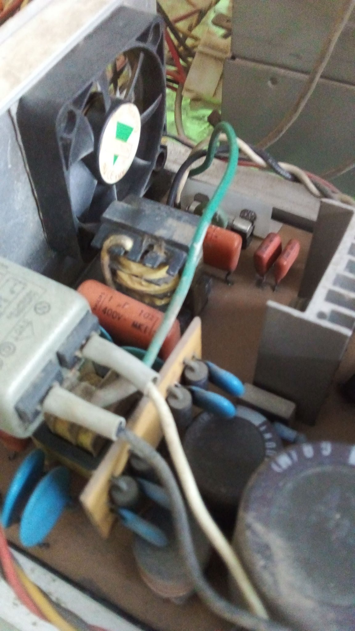

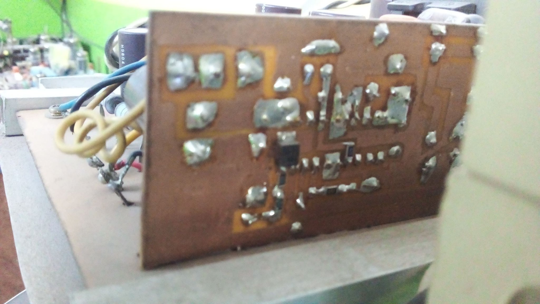

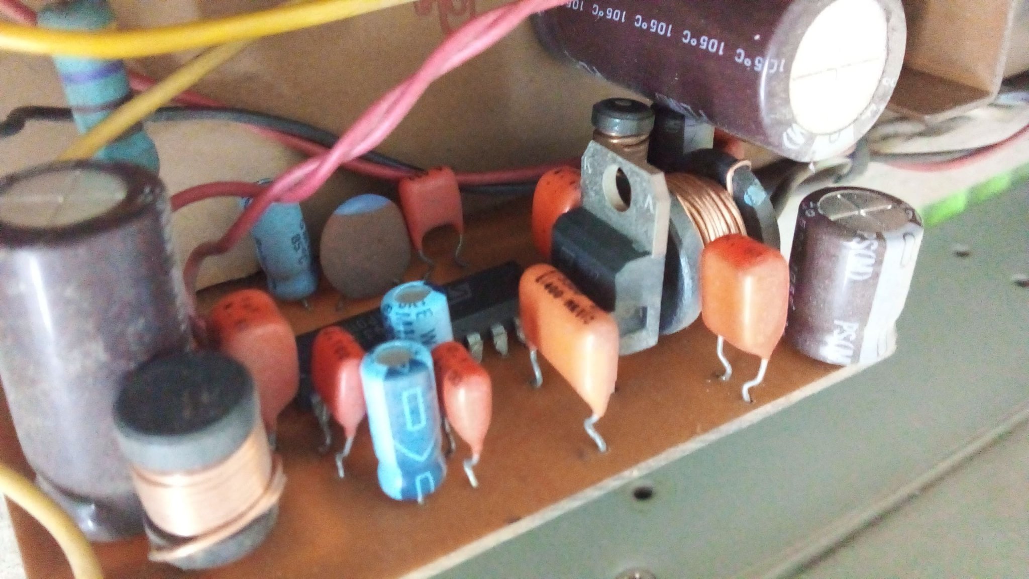

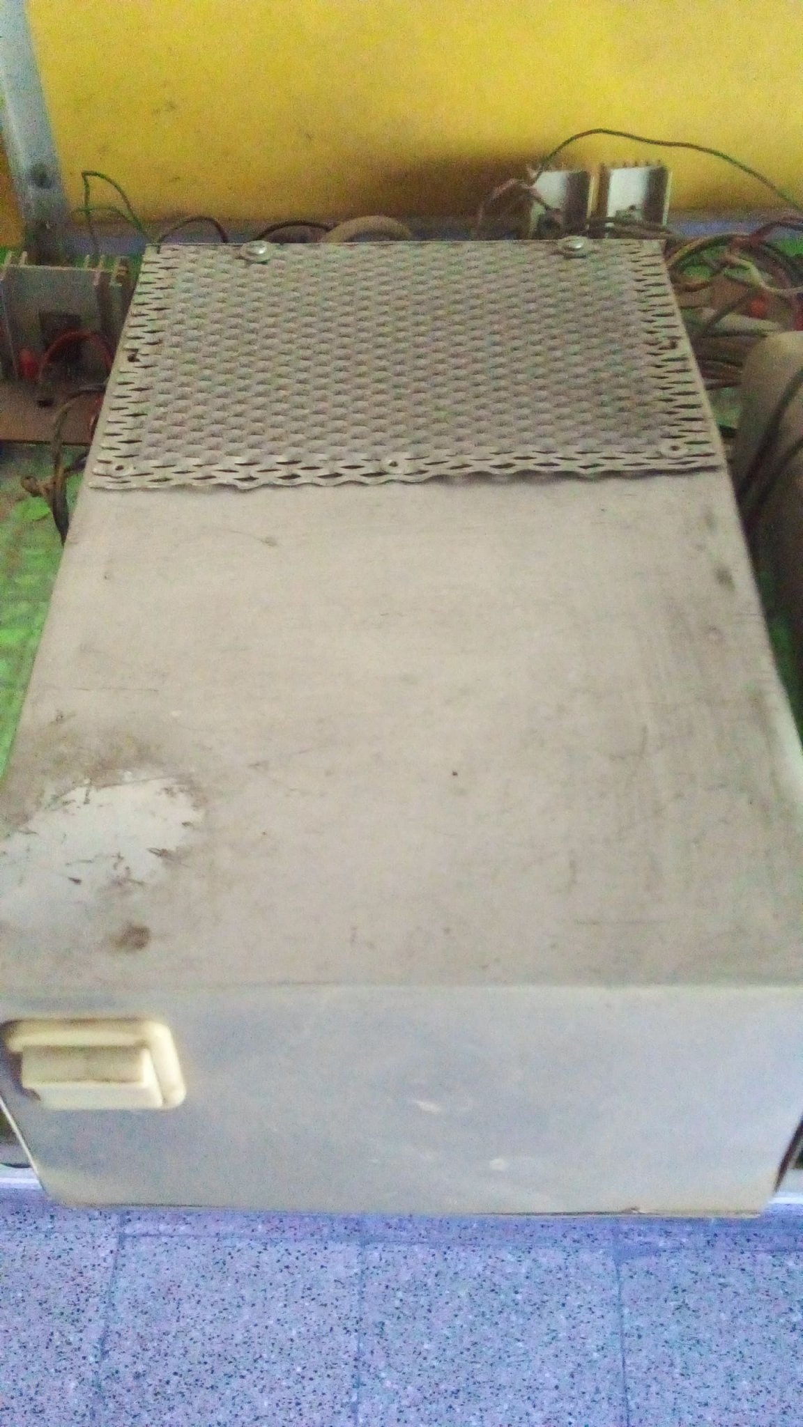

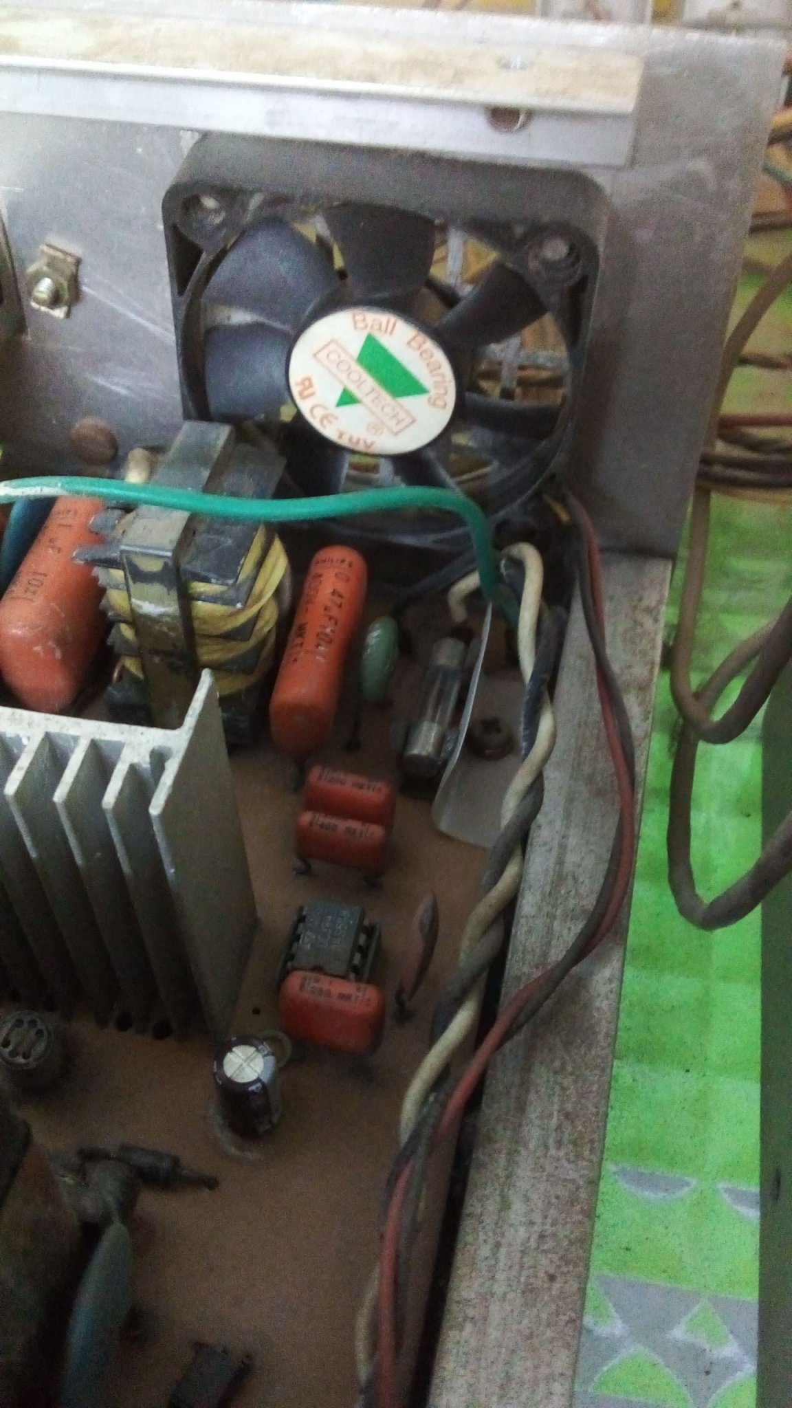

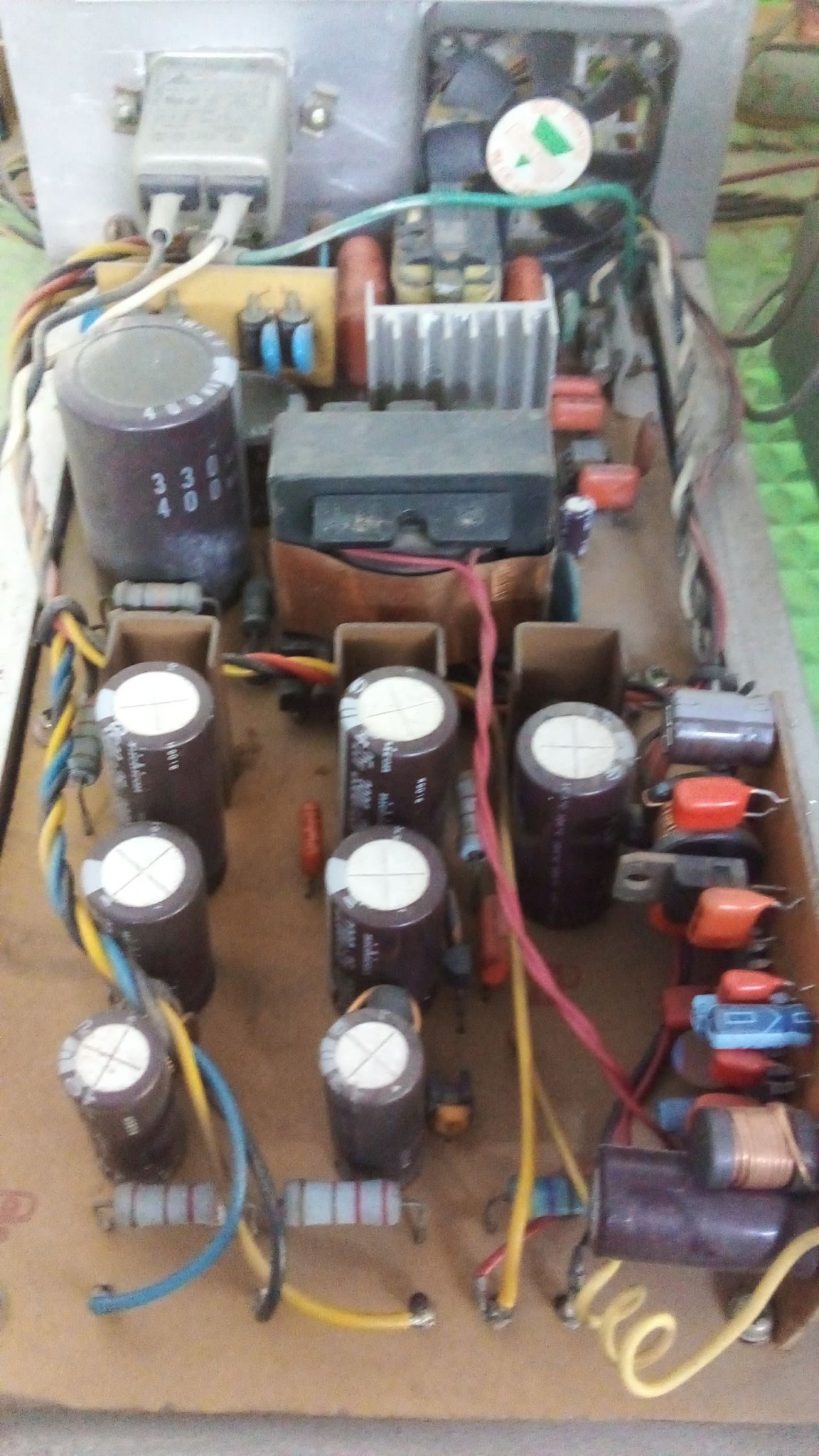

This is my SMPS.

I want to add that my SMPS gives 3 direct outputs plus one more post-regulated. From the Ringing Choke I obtain plus and minus 14V for TDA2006's (3 of them) and plus 12V. Post regulator around L4974 (The vertical add on vissible in pic #6) downconverts those 12V into 5.1V. Both are for feed old PC CDROM reader, now out of use. At pic#4 it can be seen a single turm around center tongue to synchronize L4974 to main switching frequency to reduce RF polution. Outside the SMPS itself there are LM7805 and LM7905 to reduce and isolate opamps for tone and matrix control and HCF4051 (2) for input select, and from 12V the AM/FM tuner (TDA7211 and TDA1220B) and TDA2003 (3) for driving tweeters independently from woofers.
The level of QRM radiated is really low and no disturb AM reception in the same set.
