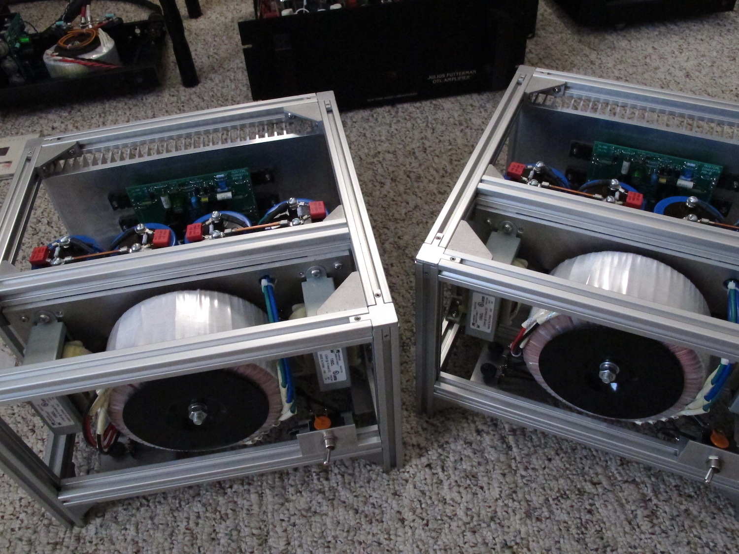

Yes its a resonant converter, the continuous power its 3kwIts a resonant converter plus PFC. Interesting. By its size; appears to be 1KW more or less.
Purchased or your own development?Yes its a resonant converter, the continuous power its 3kw
More details please!
Best wishes
David
And whats the idea with such a SMPS? Its too big for audio purpouses at home. What output voltages/currents is capable?
I had repaired several like this one, but green painted and designed specifically to drive large UV lamps to water purification. I don't remember the TM but were from Germany.
Its made by me and its capable for about 3kw output. Yes for home its to big but for my hobby its too small 😅 , in this moment it's used in class D amplifier, the output its limited by PFC ( I used 3.5kw PFC)
Also I can change the output voltages by modifying the turn ratio on transformer
