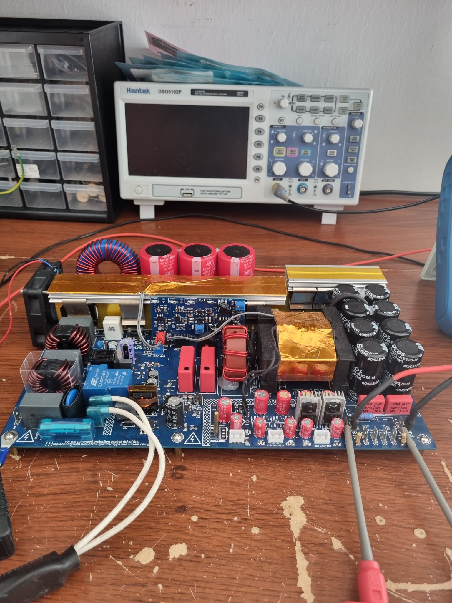

Hi my frends, this is the right SMPS for audio amplifiers🫣🫣🫣
And whats the idea with such a SMPS? Its too big for audio purpouses at home. What output voltages/currents is capable?
I had repaired several like this one, but green painted and designed specifically to drive large UV lamps to water purification. I don't remember the TM but were from Germany.
