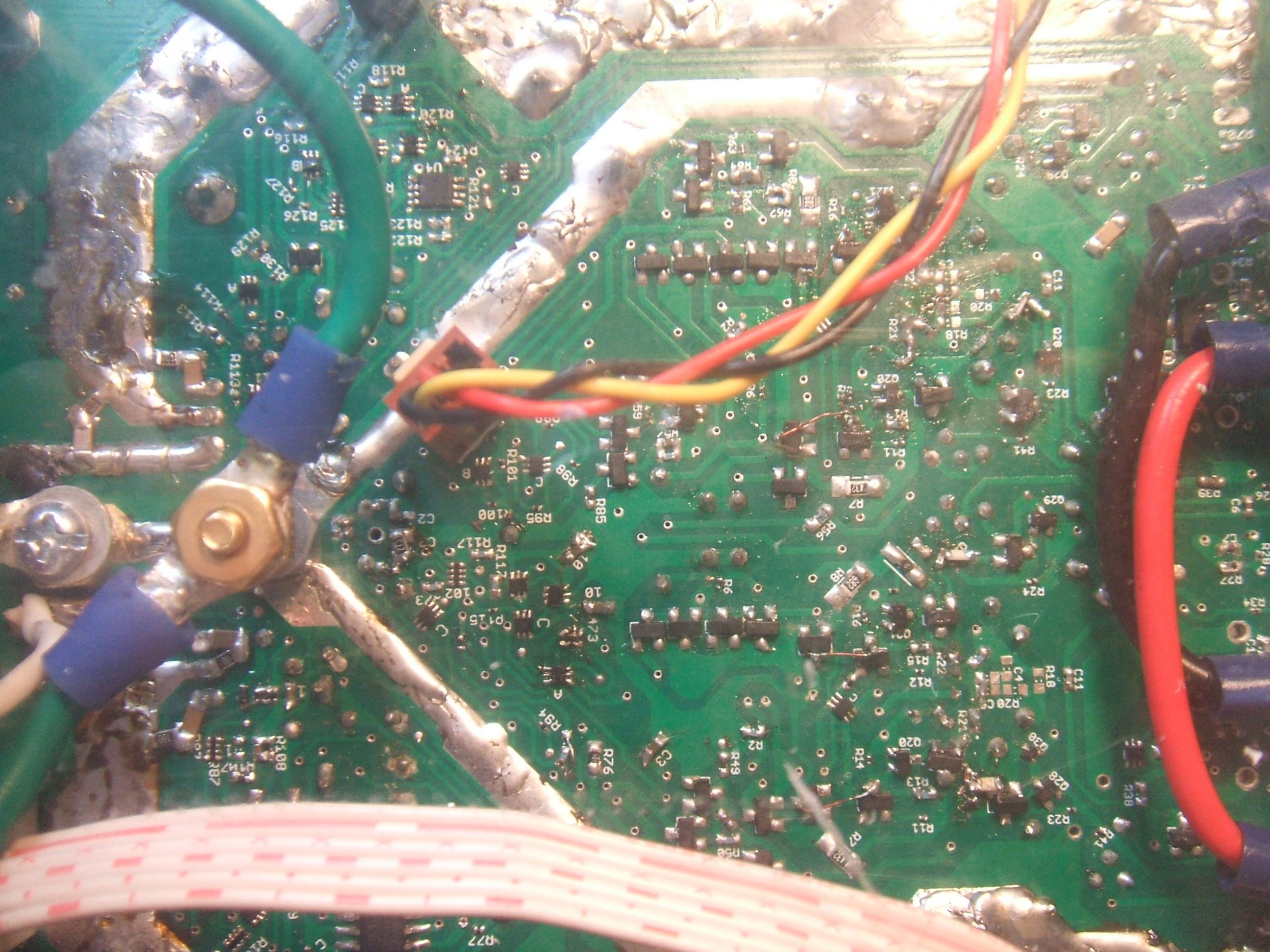

In my EC mosfet stereo amp there are a variety of smaller SMDs used. Some of them I labeled so you can see relative size.
