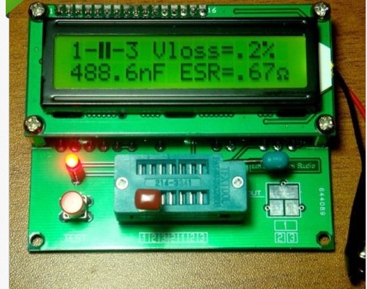

And I got this laying around (for almost 4 years) on my work bench, how bad is it for the job?
