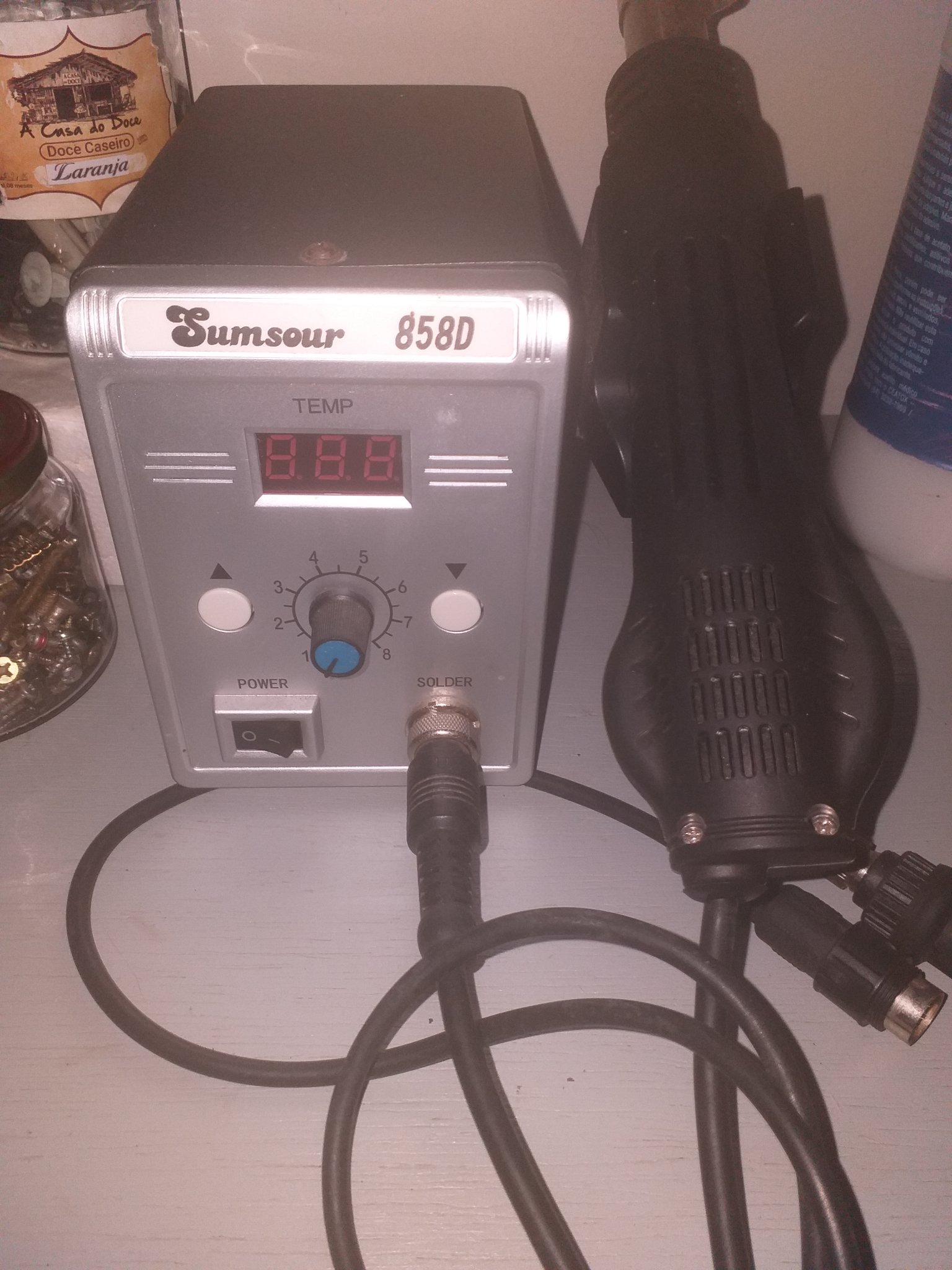

After reading all the responses, I got a couple of questions, earlier someone said that he does not like SMT for class A/B designs, or at least that's what I think he meant. Is it because of the inherent thermal effects? Because SMT components have less DP and are less robust?
I'm planning a class AB discrete design with full SMT components, is that a bad idea?
And I got this laying around (for almost 4 years) on my work bench, how bad is it for the job?
