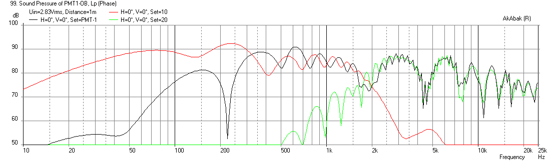

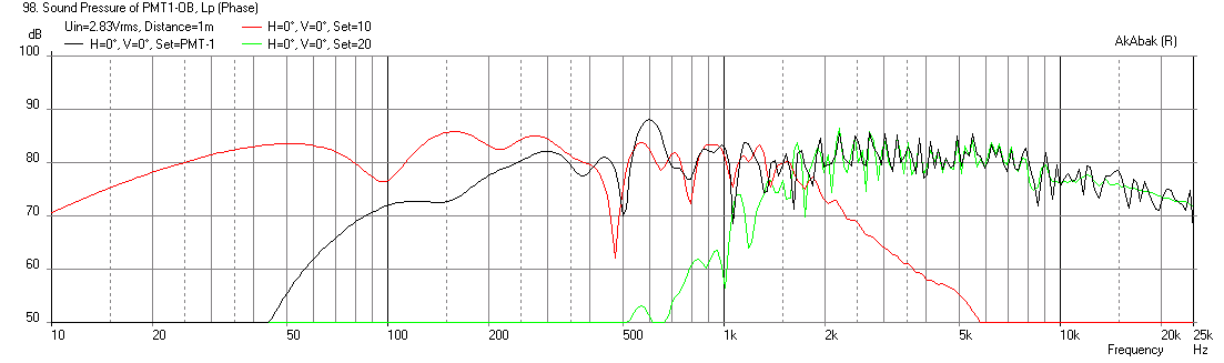

Sim of Linkwitz PMT-1 OB
I think I finally managed to sim the Linkwitz PMT-1 dipole (open baffle) speaker Dipole protos:
It was interesting to be able to add a crossover as shown here:
directly into the circuit and see its effect on the woofer and tweeter outputs and then see the combined output. I don't have the shelving EQ function yet to remove the -6dB/oct roll-off yet. It has a nice response otherwise and Linkwitz built in a gradual rol-loff on the high end to compensate for roll-off on the low end - to balance it out as perceived by our ears.
I implemented the XO in AkAbak as follows:
Code:
| XO Circuit for Linkwitz PMT-1 Dipole Speaker, Aug 3, 2013
| For Vifa P21W0-20-08 8 in Woofer and Vifa D26TG-35-06 Dome Tweeter
| Amp input goes to nodes 1=0
  Resistor     'R1'  Node=1=2  R=10ohm  | Default 4.7 ohm by SL
  Capacitor    'C1'  Node=2=3  C=10uF
  Coil         'L1'  Node=3=4  L=0.3mH
  Coil         'L2'  Node=3=0  L=0.28mH
| Tweeter goes to nodes 0=4 reverse polarity to flip phase
  Coil         'L3'  Node=1=6  L=3.3mH
  Resistor     'R2'  Node=6=7  R=0.2ohm
  Capacitor    'C2'  Node=7=8  C=18uF
  Capacitor    'C3'  Node=7=9  C=48uF
  Coil         'L4'  Node=9=10 L=3.9mH
  Resistor     'R3'  Node=10=0 R=5.7ohm
  Resistor     'R4'  Node=8=0  R=0.47ohm
The first plot is the freq response with the baffle mounted on a 30 in tall stand and placed 3 ft from a back wall. The second plot shows the baffle sitting on a flat surface like a desk and 24 in from the back wall. As you can see, when placed too close to back wall and flat on desk or floor, there are some undesirable effects to the response.

I do not know how Rudolf is able to achieve a frequency response that doesn't start to roll-off until 100 Hz with the FR13 as show here.
Doesn't seem to agree with the measurements by Linkwitz, or with my AkAbak sims which show falloff occurring in the range above 500 Hz. A flat response down to 100 Hz would normally require a closed box to isolate the back wave from cancelling with the front wave. ...
Am I missing something here?
I answered to this question:
Please, if anyone has any open-baffle design with Visaton FR13-4 post it here.
In http://www.diyaudio.com/forums/full-range/240012-small-open-baffle-2.html#post3579062 I have shown what can be achieved with that driver and what not. Because of its high Qts and the support of the 3.3 mH coil at the driver resonance, the response will be flat down to 100 Hz.
I have also clearly shown how the ability to deliver SPL values rolls off from 500 Hz and precipitates below 200 Hz. This is the best result you can achieve with such a driver in a baffle of the given size.
If your results don't agree with the two independent sims of mine, you need to look into your AkAbak. I'm absolutely sure that my sims are in line with Linkwitz' theory.
So what I am seeing is that with a single 5 or 6 in full range driver, you will need a bass driver (not even a sub woofer) to make it sound balanced if you like to hear bass below 400 Hz. Without any EQ'ing, the output from an OB, is, well very colored to the HF.
I'm completely in line with above comment - except the 400 Hz value. Would be 200 Hz in this case. But this has been clear already in post #13.
