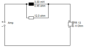

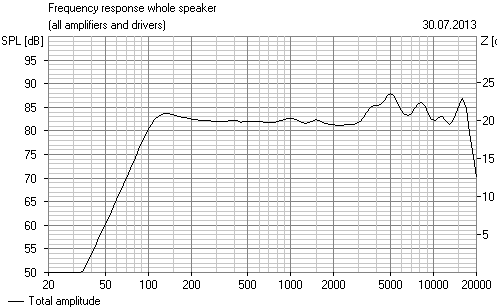

Assuming a baffle of 20 cm width and 30 cm height. FR13 at 20 cm height with 3 cm offset from middle of baffle, would lead to these results in simulation:

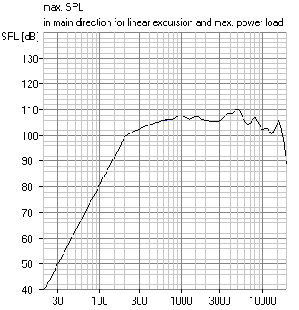

The OB is sitting on the desk. With the coil and resistor from the third picture the response looks promising down to 100 Hz. But look at the power response at Xlin:
It already drops off below 200 Hz.

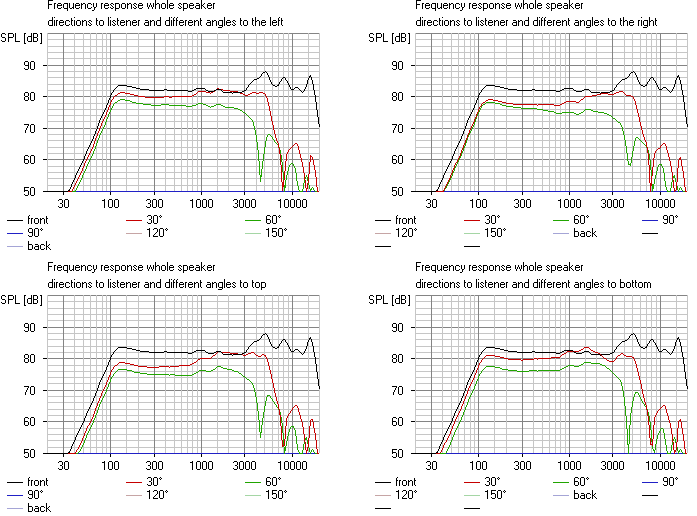

Last not least the response in some directions:
Simulations done with Boxsim.

Hello Rudolf, thank you very much.
50x50cm are too big, so dón't use the filter as I say don't seems a good idea.
If I use two speakers per baffle, as suggested xrk971, the second can be from 10cm from below of the baffle with the same offset? The filter surely also need change the values?
