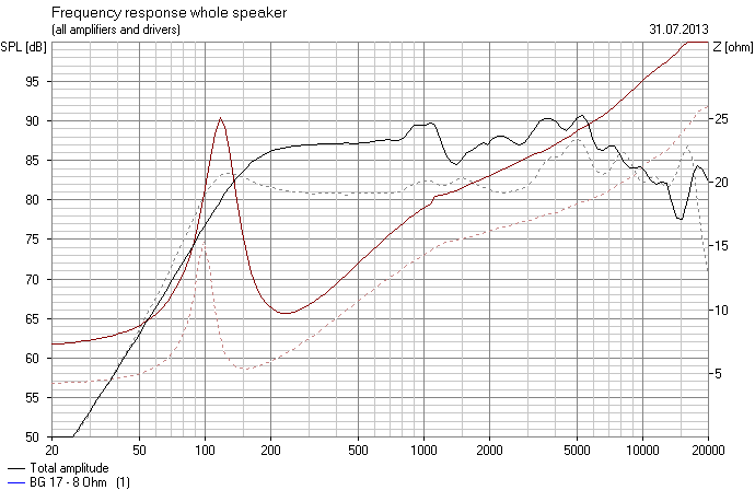

Same baffle, same position, same EQ, but BG 17-8:What about this? 8 Ohms, 93dB, 6,5" and say that are good for open baffle.
![BG17 response.gif BG17 response.gif](https://www.diyaudio.com/community/data/attachments/326/326609-03fc8b0ed5cf86231a9c096951f0531b.jpg)
Dashed lines are the FR 13-4. Brown is impedance. I listened to a single BG 17 in OB for two hours and put it back into its shipping carton. A hopeless case ...

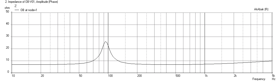

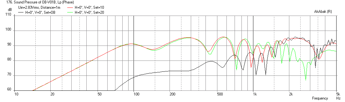

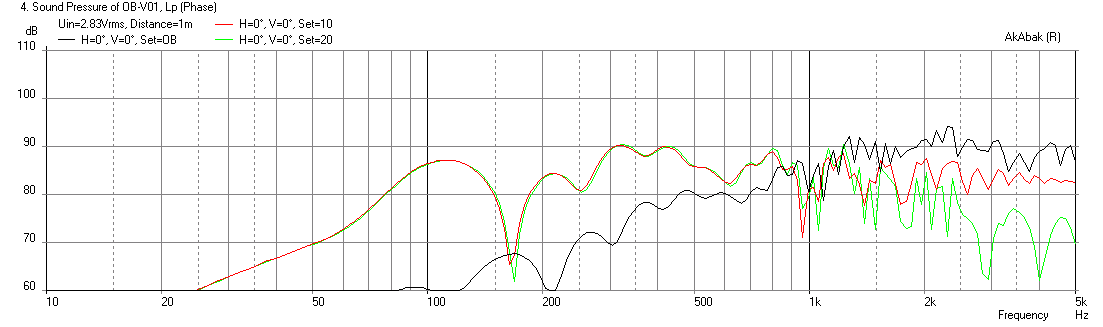

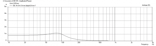

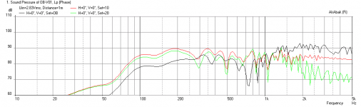

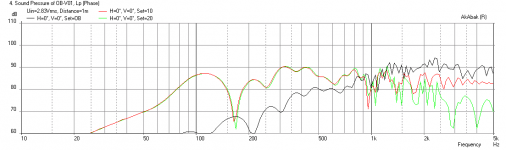

AkAbak sim of OB
I am not sure if I did this right as first time modeling an OB. I modeled it as a short duct (depth of baffle material 18 mm) and with a baffle diffraction size determined by OB baffle dimensions with driver placed at offset locations. The front wave is a direct radiator and the back wave reflects off the back wall. The combined wave is the superposition of the two waves and this cancels out a lot of the bass. The larger the baffle is, the less cancellation.
Anyhow, I tried it with the two FR13's in a large baffle (60 in tall x 36 in wide) placed 60 in from back wall, driver centroid is offset horizontally from center of baffle by 12 in and 20 in vertically (up) from center of baffle. First plot shows that you do get some bass.
Second plot is using a single driver in the tiny baffle of 20 cm wide x 30 cm tall set at 24 in from back wall as typical on a desk. There is so much cancellation of front and back wave that there is no bass. The freq response is just awful. You are better off with sealed cardboard box. Not kidding.
Third plot is impedance of large baffle, fourth plot is driver cone excursion with large baffle. Last plot shows what happens when you don't put any offset on drivers - the front and rear waves cancel and the bass collapses.
I may have done this wrong, if someone familiar with OB response can let me know if this looks OK?
It is very easy to add as many drivers as I want of any sort at any location if this is good approach.

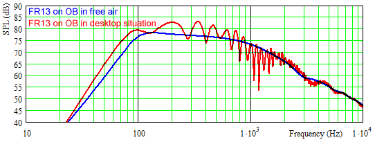

I have tried to simulate this situation for the left speaker (I don't recommend to have the OB pushed into a corner like the right one). This is the top view:What I look for is something like this:
![FR13 top view.gif FR13 top view.gif](https://www.diyaudio.com/community/data/attachments/327/327220-a907d972afc2400a988e0af088b4d4e8.jpg)
The OB is almost against the back wall, toed in 45°. The listener is the red square. Floor level is the desktop. The simulation worksheet from www.quarter-wave.com can't simulate different levels in a room. The simulation includes reflections from the front wall, left side wall, ceiling and desktop.
This is a comparison of the free air response (blue) and the response in the situation explained above:
![FR13 on desktop.gif FR13 on desktop.gif](https://www.diyaudio.com/community/data/attachments/327/327226-2c66a59b259961b9ef75b156182a3e02.jpg)
The simulation lacks the resistor in parallel to the coil. The MJK worksheet provides simple crossovers only.
Everybody is entitled to call a desktop OB an oxymoron.

Not the only one. Post #34 shows the simulation of your 20 cm x 30 cm OB design with an FR13. It doesn't look good. OB needs to be rather large to work, of order 1 meter before any bass can be heard.
