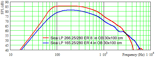

The Sica LP 266.25/280 ER 8 Ohm would be another driver to consider.
Sica Breitbandlautsprecher LP266.25/280 ER 8 Ohm
A comparison with the LP 165 - both in the large baffle with 1 W at 1 m:
You will have noticed the extended bass and the earlier roll-off of the heights.
A comparison with the infinite baffle response shows the same problem in the treble response - probably worse than for the LP 165.
Both drivers illustrate a common problem with fullrange drivers and OBs: Trying to improve the bass region by using larger baffles or larger drivers tends to compromise the balance with the treble region. Very soon you need complicated correction filters to restore the original equilibrium.
What some people call the "beautiful simplicity" of the fullrange concept becomes in real life a "bunch of compromises" in most cases.
