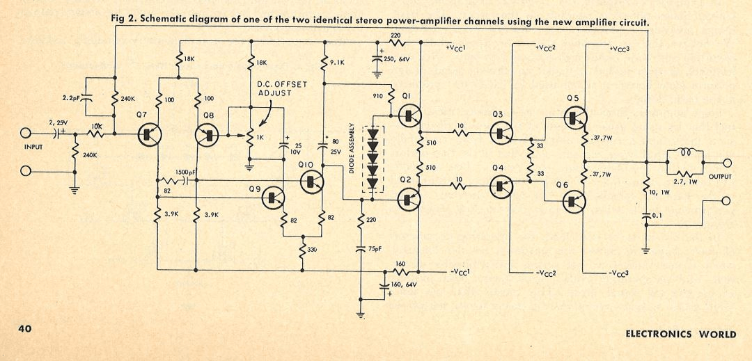

Have you heard about rail bootstrap? I think Textronix used it first with nuvistors in 50's oscilloscopes.I honoured them by using germanium transistors 🙂

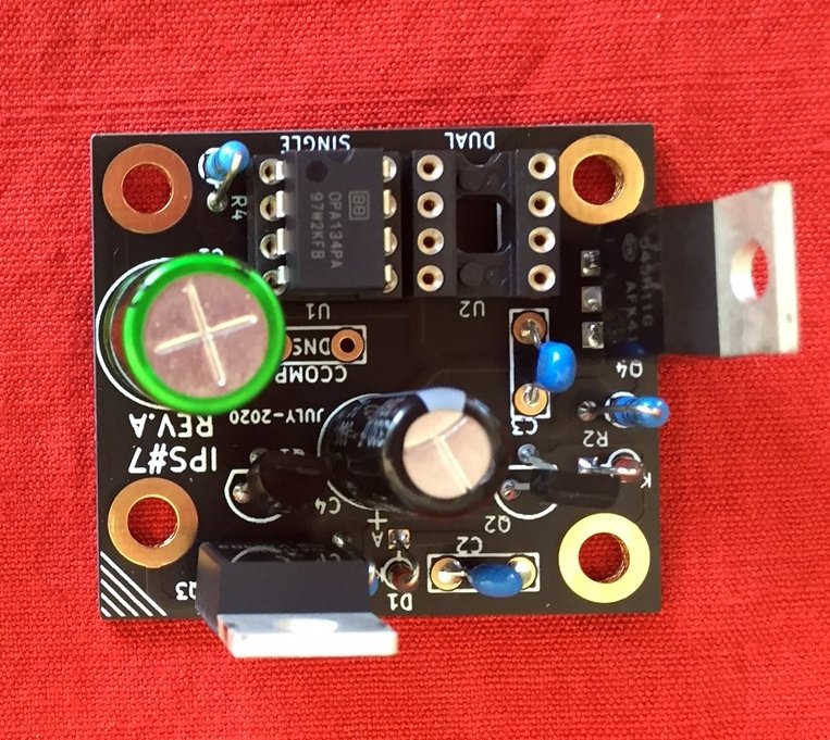

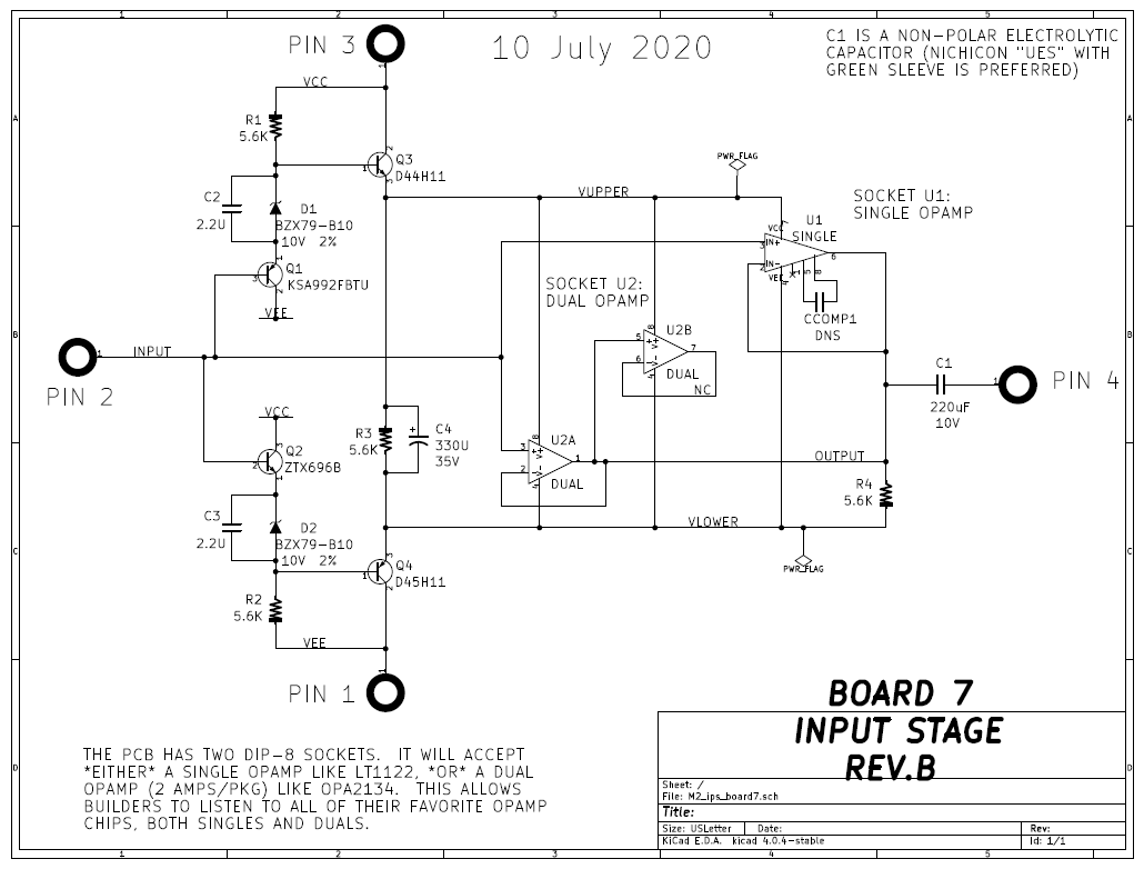

The "IPS7" input stage daughtercard for the diyAudio Store's "M2x" amp, uses bootstrapped rails. Builders rave about its wonderful sound quality.
Much later, I found out that someone applied for a UK patent on the idea, way back in 1979.

as i understand no PCB (gerber ) existing but last schematic is here, yes?:
post 18: schematic
I am not sure if to release Gerber files. The amp needs a large heatsink with very low °C/W thermal resistance. Sometimes it is difficult to reply to the bunch of questions when the Gerber files or PCBs are released.. So I better do it in case of preamps only, or very simple power amps.
Yes post #18 schematic is valid.
