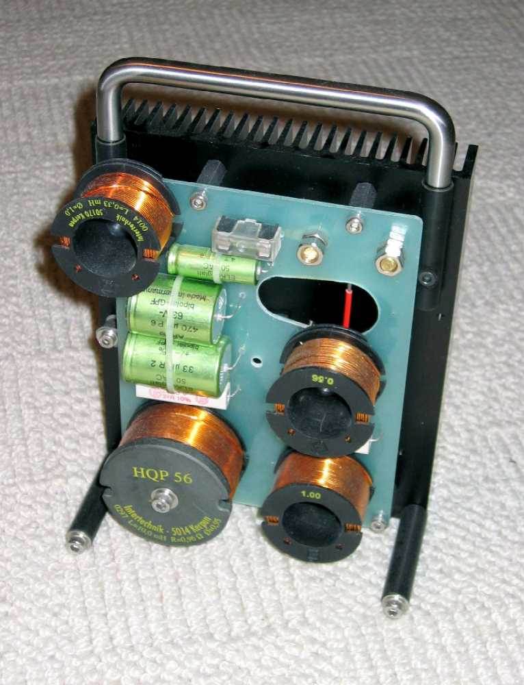

Idle power dissipation is about 75W per channel. An appropriate heatsink with low thermal resistance must be used. The one shown in my sample photo is insufficient for normal operation. I was using 19" 3U case with side heatsinks with fins and low thermal resistance during the normal listening operation of the amp.

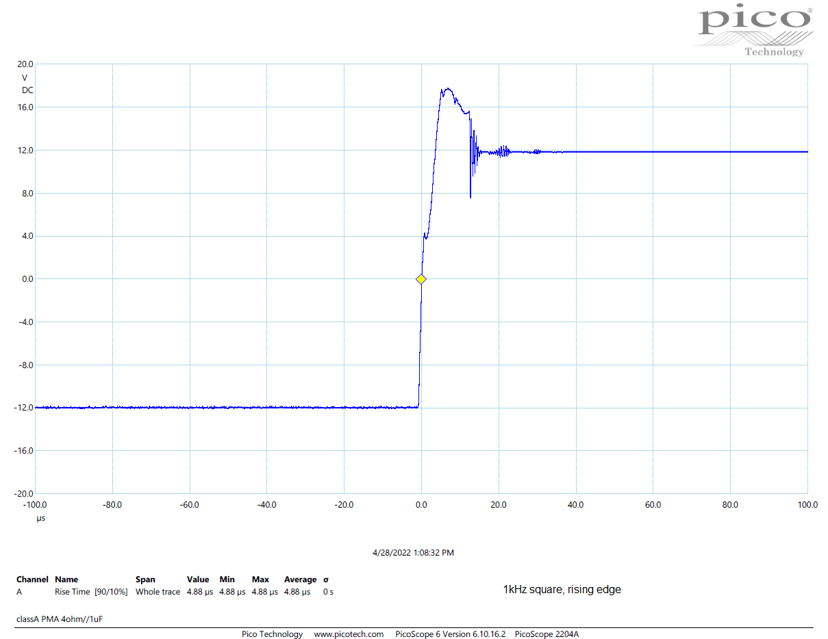

I remember vaguely reading a report from you some years ago, showing the step responese of a power amp with 1µF at the output.
I wonder if you have a "standard" stability test, and if yes, whether you would kindly share.
Thx,
Patrick
The step/square response into 4ohm//1uF is quite a cruel test, but you may have it.

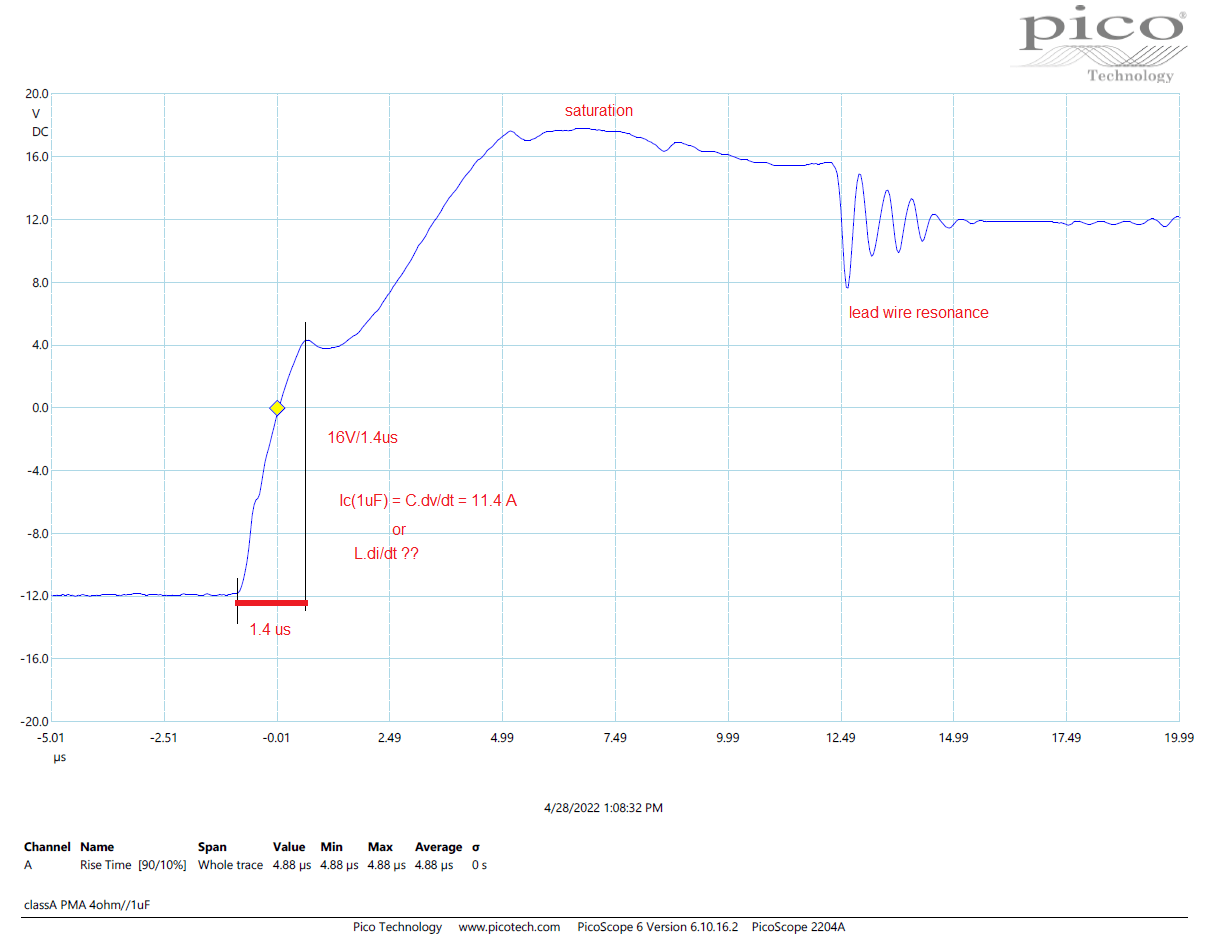

This step test into R//1uF is IMO pointless. In ideal case, with ideal step, the capacitor would eat infinite current, because Ic = C . (dv/dt) and for dt = 0 Ic is infinite. This test in fact reflects parasitic impedances of the circuit (lead wire inductances, capacitor ESR and ESL). And, if we have troubles with instability into capacitive load, we usually see it with load capacitance between 5nF and 100nF, rather than with 1uF. With 1uF, we can see parasitic impedances as mentioned and amplifier's output current limit. I tried to decipher the plot, but is is just one possible view. Many amps will go into current protection and some amps will be destroyed by this test.
So what is a reasonable test in your opinion ?
Do you design your open loop response with pure resistive load, and just allow x amount of phase / gain margins ?

Capacitive loading is fine to test from 100pF to 100nF. You might be surprised but the worst load is coaxial speaker cable with length >5m with open end. Impedance is violent above 1MHz with dips where capacitive component goes in uF order. Many amps get to oscillations with such load. I always use a complex speaker dummy load with nonlinear inductance to check both amplifier FR and distortion with it.So what is a reasonable test in your opinion ?

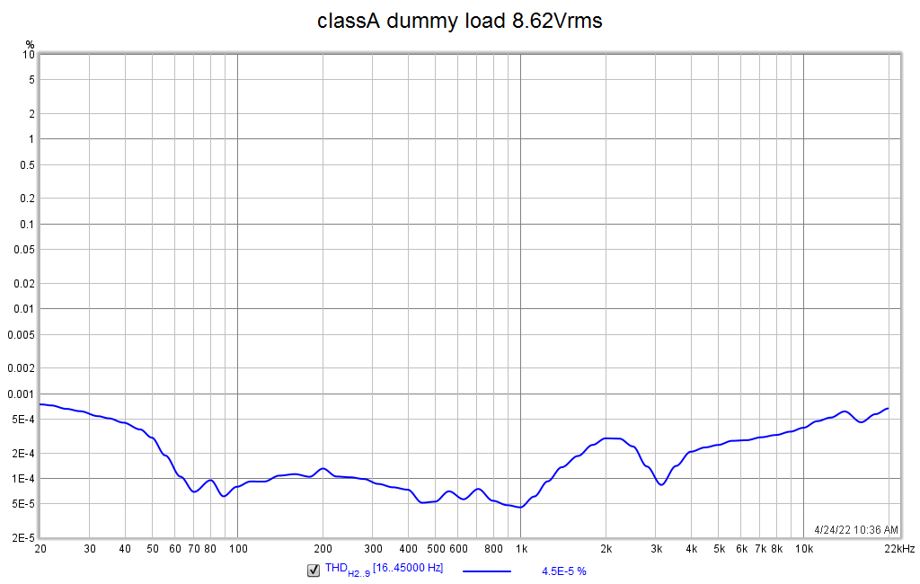

It is good. I have a very similar dummy load circuit.This is what I use. But not sure if it is severe enough test.
A minute ago I have finished testing of THD vs. power and THD vs. frequency with 4ohm//1uF load. There is almost no difference compared to 4ohm pure.

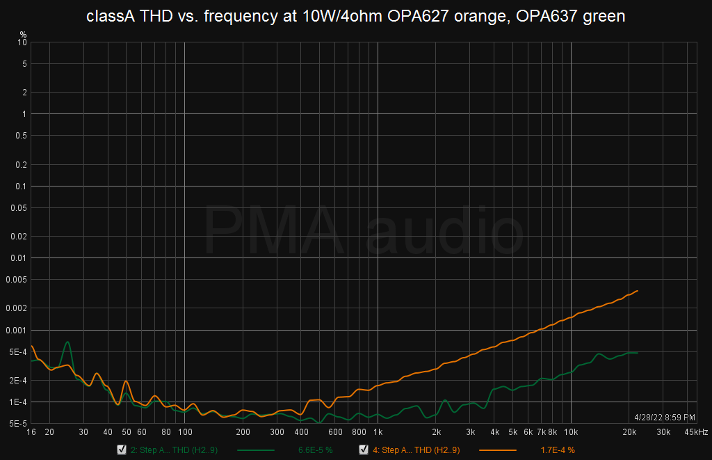

More interesting is the change of opamps. Below is OPA627xOPA637. OPA637 gives the best results by far, in this circuit. Followed by LT1122 and then OPA627. OPA134 has higher HF distortion than OPA627. BJT input opamps are unusable in this circuit, it needs low input bias current. Attached is also the result with dummy load. My dummy load has highly nonlinear 18mH ferrite core inductor which simulates quite well speaker nonlinear impedance.
You get some 12dB more OLG with OPA637.
So no surprises.

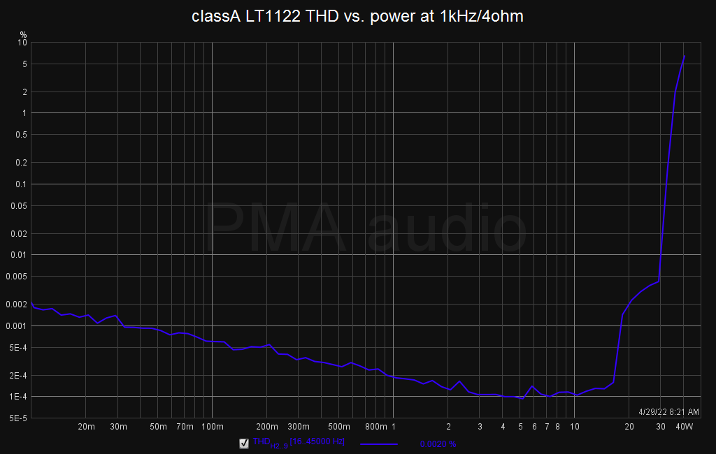

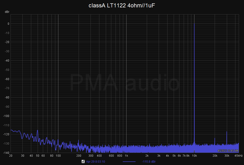

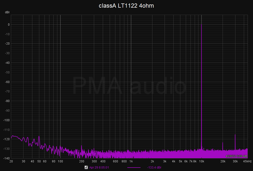

Hi Patrick, some opamps may surprise us. One of them is LT1122 which fits perfectly to this design and has supply voltage up to +/-20V. I guess that the old datasheet measurements of distortion were made with not enough resolution and were not updated.
Below are measurements with LT1122. THD(power) into 4ohm at 1kHz - see the transition into class AB at 18W and then still 30W with 0.004% distortion. Also added are measurements at 10kHz into 4ohm resistor and 4ohm//1uF capacitor.

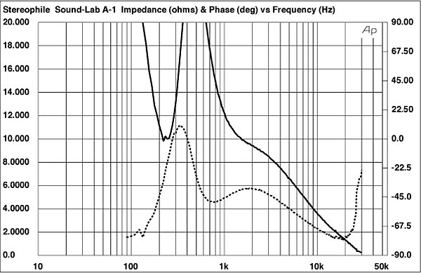

Probably these tests with 4R//1uF load may make some sense.
https://www.stereophile.com/content/sound-lab-1-electrostatic-loudspeaker-measurements
