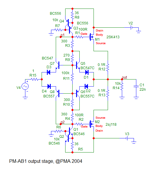

I can offer one more, built in 2004 ..
What you mean as "proof"? The old thread is here
https://www.diyaudio.com/community/threads/new-error-correction-amp.40543/

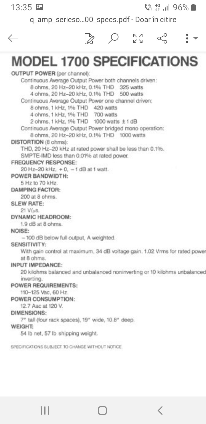

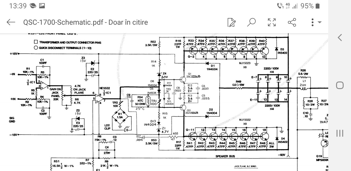

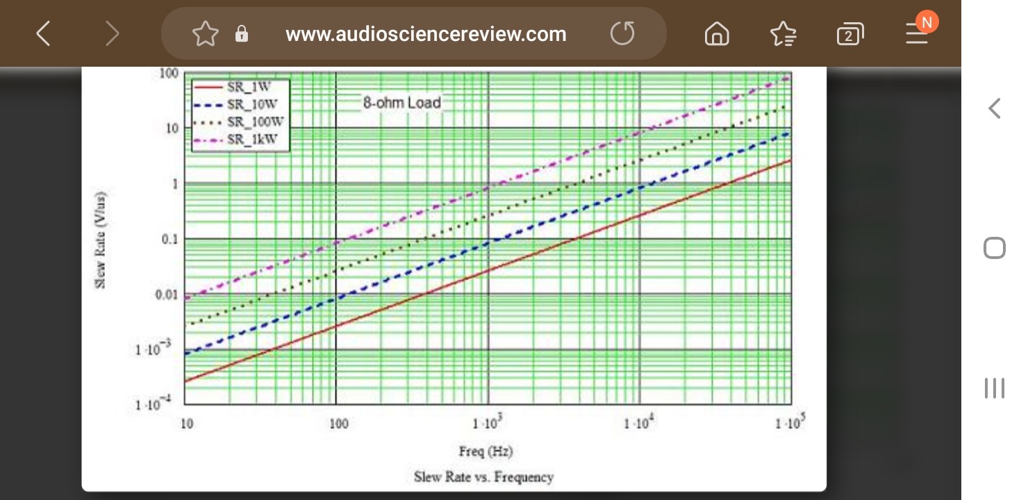

This is not true. Slew rate in voltage feedback amplifier (VFA) depend on input current (LTP) and the compensation.There must be smth wrong with your assessement unless there's smth catastrophically wrong about the power transistors. Operating output trz in class A gives maximum slew rate so I'd rule out that in the first place.
Bob Cordell and Douglas Self wrote it in their book. And I can confirm it in simulation or in measurement.
Definitely, you do not know how to design amplifier.
Thanks!What you mean as "proof"? The old thread is here
Thank God I don't have to! Ltspice does it for me!This is not true. Slew rate in voltage feedback amplifier (VFA) depend on input current (LTP) and the compensation.
Slew rate is defined as V/us, but you have no damn slew rate if you can't push your current through the damn 2...8 ohm INDUCTIVE load.
You could have a billion V/femto second in the op amp...if the final stage can't deliver it to the load you have 0V / 1 billion years slew rate.Try listen BA 5218 on headphones and you'll see what a 2...3v/us op amp can do just because it can deliver enough current to the load.There's no slew rate without the ability to push a current through a load and no op amp can do that on 8 ohms that is why you have a buffer...the op-amp itself has an internsl buffer too.Why are you biasing for class A to make 20khz crossover distortion as low as possible and why are you looking for low cob transistors in the final stage when you could just use your billion volt slew rate op-amp and you're done...!?
As for slew rate requirements of an amp...now that it's clear you're the true engineer here, maybe you could tell me how a 9v/us vfb op amp can drive a qsc1700 with 21 v/us at 600 watts of power into 4 ohms if only the input ltp of ne5532 is the one responsible with slew rate and basically you can only go down below 9v/us with any added compensation, not up...Apparently there's no need for more than 21V/us either ...
