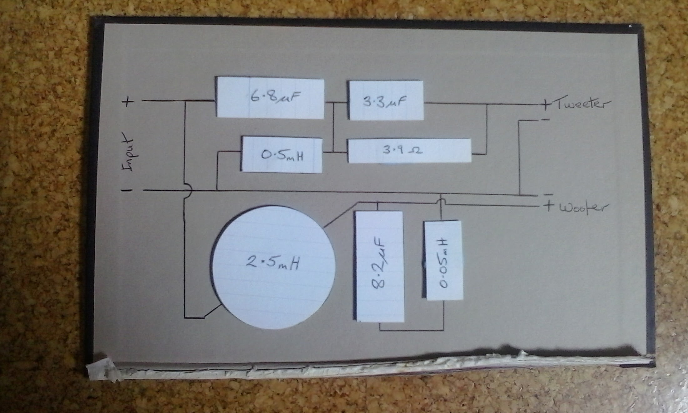

Oh cool....so a case of laying it out on a piece of plywood.....what are your thoughts, components glued into place? Or cable straps? Did you mention recessing one side for wiring? I think it might be best, simplest to do that on the component side too....

Prynhawn da (Good afternoon) Here's a suggested layout. I've put the two smaller coils on edge (apparently it means they're less likely to interact with each other)
I hope it meets with madam's approval 😉🙂
Distance almost never matters but orientation does. I'll do orientation 🙂 thanks buddy 🙂

You could do that but I don't see much point TBH, the components would need to be secured to the board anyway
He he, it would be neater and probably easier to solder the way you suggest. Clean on top.....dirty underneath....
