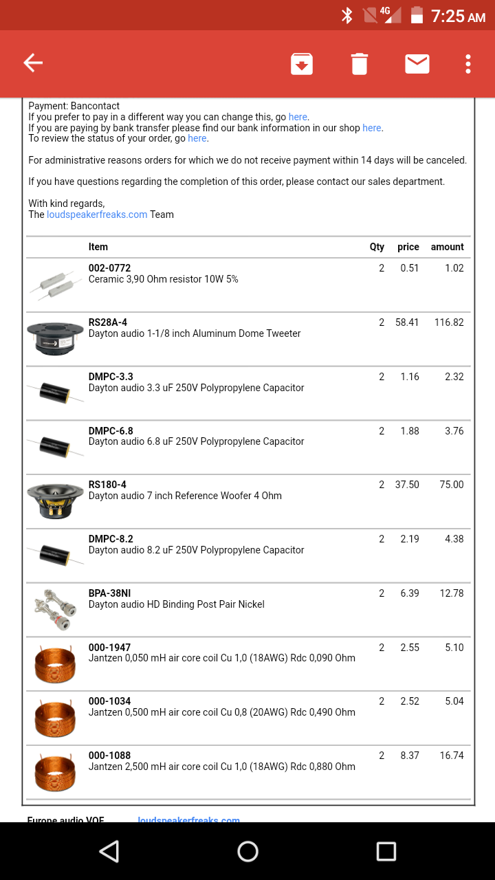

Yeah, decent little speakers by the look of it, 7" bass, that should be good. Looks like the port isn't on the front cuz there's no room............be interesting to see what Jim thinks...
Looking at your drawings, I think there are fine.
As to rebating the woofer: I wouldn't bother unless you prefer it for aesthetic reasons. The difference in diffraction between rebated and not rebated will be rather small.
One other point to consider, if you haven't already: I suggest grills to protect the drivers. Yes, grills do affect the sound a bit, but much less than a damaged driver would; children like to poke things, as do some adults.
Cheers, Jim

I triple checked the crossover components and looked after the other things as well, so now I made the order. They're expected to arrive the thirtieth of May. One of the Jantzen Audio coils is a backorder product that arrives May 29th.
Next, would anyone be able to help me make the crossover board? I'm making it on a piece of plywood cut in half, hollowed out in the bottom, so that I can hide the solder connections. I don't know the layout though. I can try and mail parts express but that's about it.

Yes, email Parts Express about the layout, I noticed Jeff Bagsby was/is on their forum so you may be able to speak/email him directly. Yes, just checked, he's there and active, you'll have to register if you want to send him a private message. Someone who knows may pipe up here of course but it wouldn't hurt to get it from the horse's mouth, hehe!
Oh, Jeff's on a forum? I have to contact him. I'll ask him to check if the design I made would work, as well, if he has time. What forum is that?
