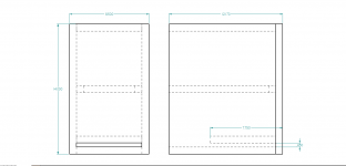

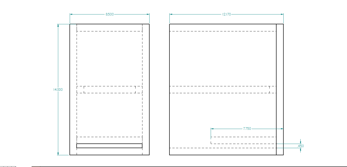

Some simple drawings I made. Note that these are WITHOUT the front baffle attached. I extended the length of the totall piece by .42" including the bracing etc.

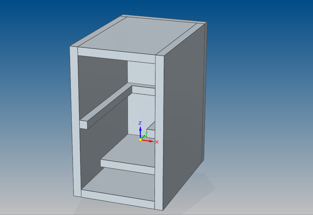

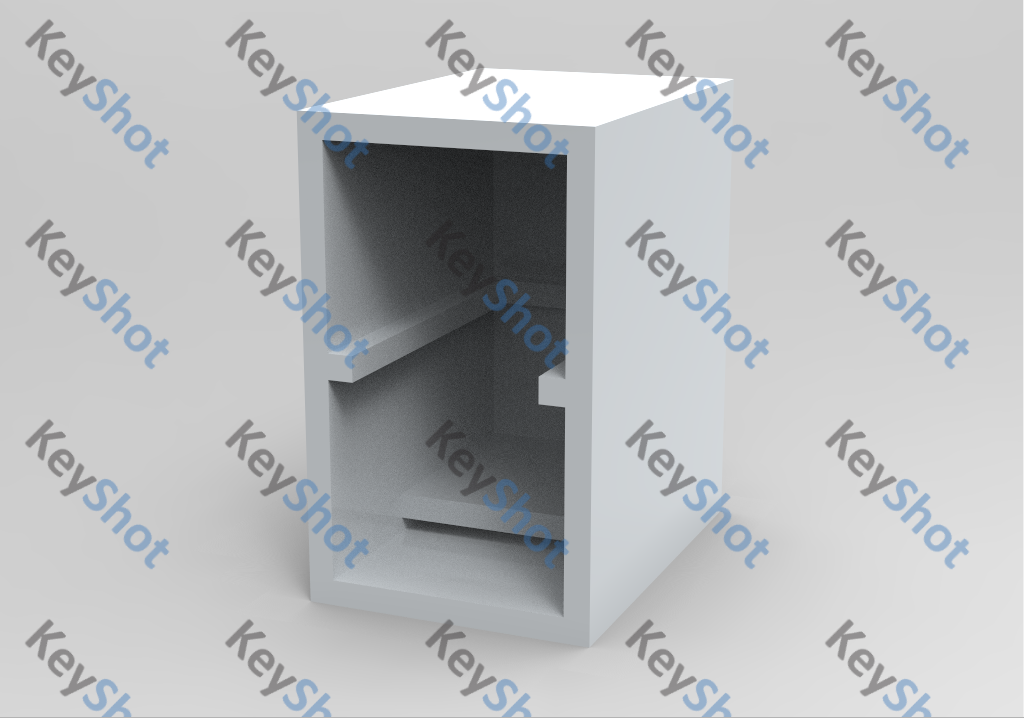

Pardon me for the watermarks on the Keyshot rendering, and the grainy look. I didn't want to wait two hours to finish the rendering haha and the licence file went missing after windows was reinstalled AGESSSSs ago. I didn't really use Keyshot until now. I did include a solid edge render though.
Yep, that looks right to me! You've decided the port in the back then? You could good either way I think.
Jim gave me insight on it. I learned from Zeos (Z Reviews) that we should put 'm about 3 feet from a wall.. But this design isn't that powerful and isn't ever gonna see much bass either. Shouldn't be a problem either because I plan to insulate the walls behind my work area with accoustic panels anyway.
I'm waiting for Jim's reply. If he thinks it's fine, I'll go over to metric-a-lizing it, putting in a rabbet in the sides, and making the top and bottom wider according to the rabbets. Eases the assembly and makes it more leak proof and it looks nicer. It also makes it easier to hide the endgrain of the mdf. Since I'll be chambering the sides, I'll need the extra surface area to glue on.

Probably wise to keep to the original as Jim said, ie port in the back, probably a reason for it, you mentioned phasing, there certainly could be some cancellation with it in the front. Do you need metric figures to have the pieces cut to size? Sounds like it's going to look good. How are you going to finish it?
I'm European, so we can't get quarter inch mdf. That's why I'm going for 18mm. i'm going to finish it in matte white with one clear coat to protect it. No shining clearcoat.
