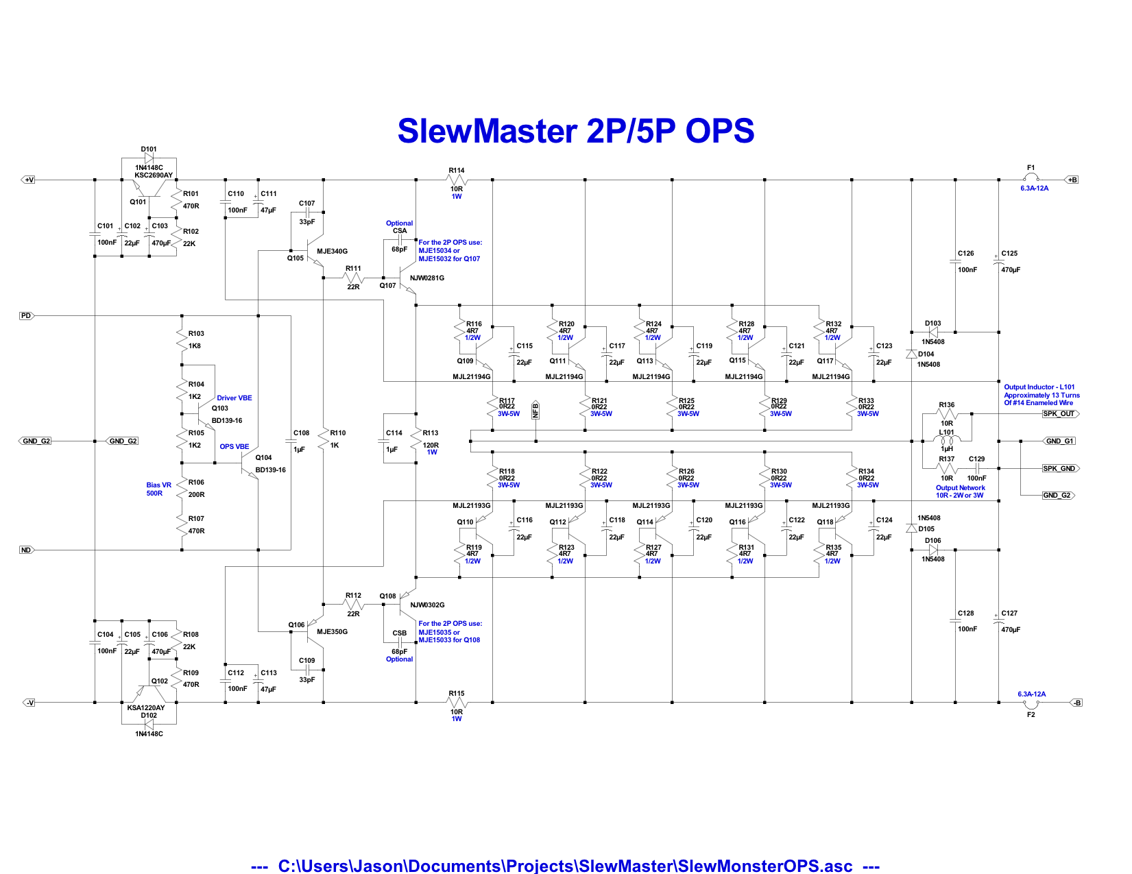

OPS Schematic Re-Draw
In the hopes of further clarity I have redrawn the OPS schematic to more closely resemble the actual construction of the PCB. Some values may differ from those on OS's schematic. Those are either non-critical (and represent values I used) or were discussed in the main thread as having some improvement.
As usual, a number of different semiconductors can be used but I have put down the ones that seemed to make the most sense to me. Of course individual constructors can use their own discretion regarding parts choices.

Is there any interest in making a 3P OPS too? If not I can just skip outputs on the 5P board as planned before.
I may also just order some 2P boards if it would be possible to just reach 100W with either MJL3281/1302 or MJL21193/21194 output pairs. I can always save the 5P boards I already have for a future exercise in excess...
I haven't got any plans for the 3P version, though the art exists for them. The 2P should be just fine for 100W output. Use the MJL2119x family of outputs for their generous SOA. If you use the 5P boards for only 3P you could then use Sanken MT200 packages devices if you like, I'm pretty sure they would fit with the intervening pairs left off.
