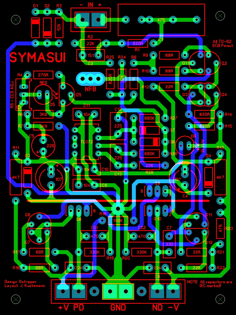

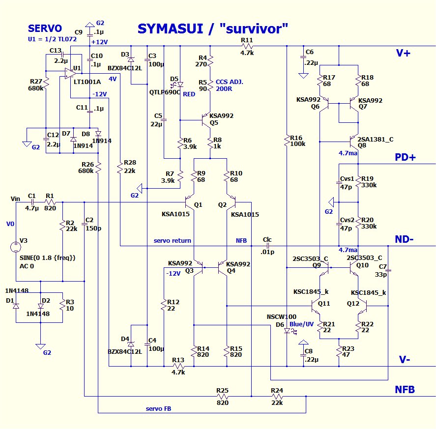

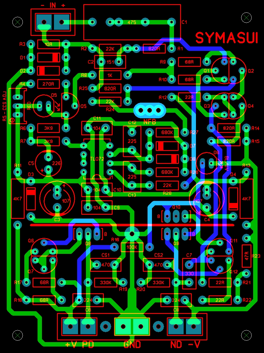

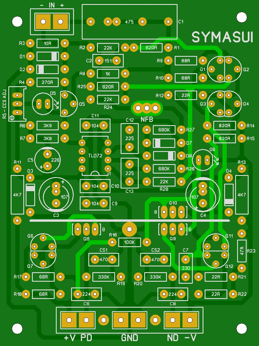

Based on activity in the main development thread I decided to do 'Symasui' next, so here's a peek at that. It is time for proofing so if anyone notices anything please let me know.
Moving forward I plan on standardizing on 3" x 4" boards with the same mounting holes so all IPS will fit with one physical set-up.

2) Symasui - A 'Symasym' type VFA with some Sansui influence. Differential current mirror loaded VAS sporting mixed compensation schemes.

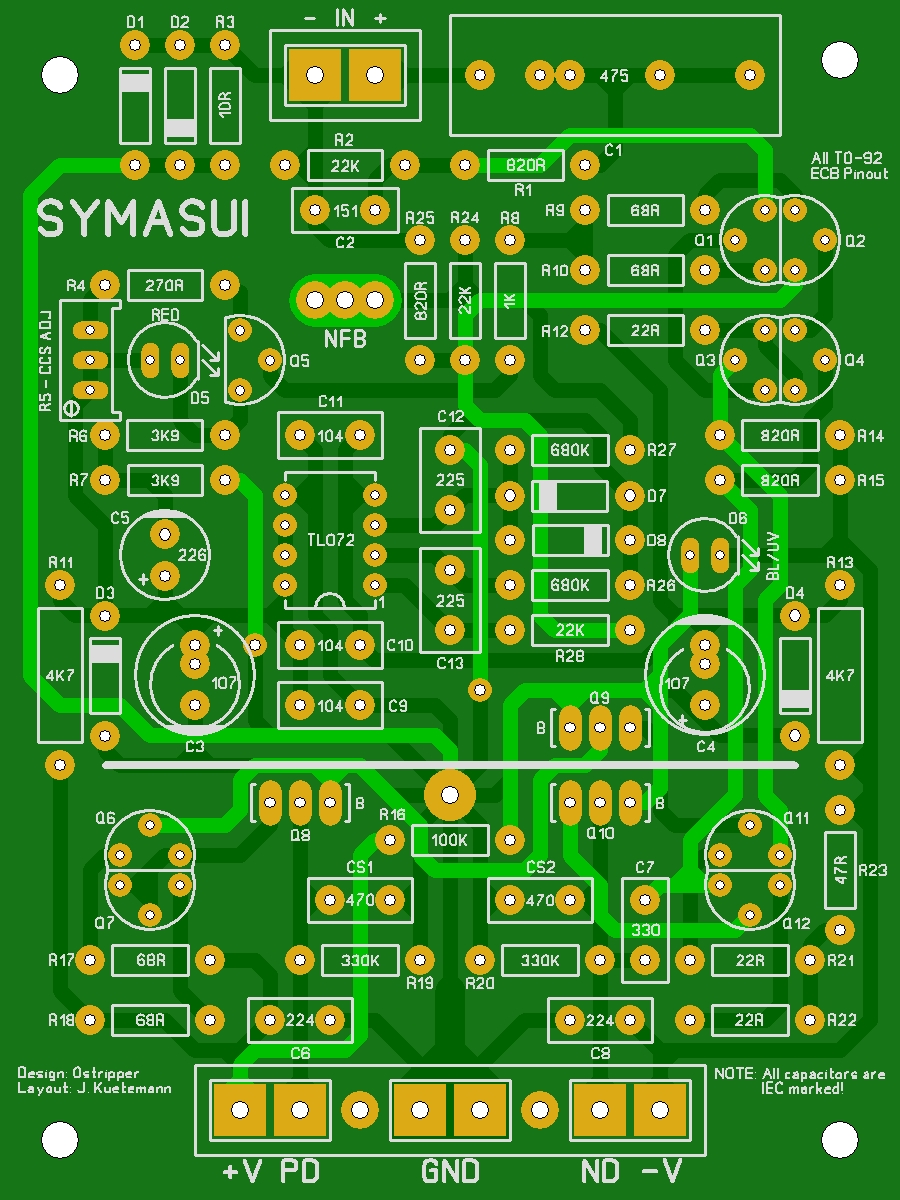

Still working on the Symasui. I found a missing connection and am now making what will be final tweaks.

Planning on ordering more 5P OPS and the 'Symasui' IPS shortly. Any interest in a 2P OPS board?

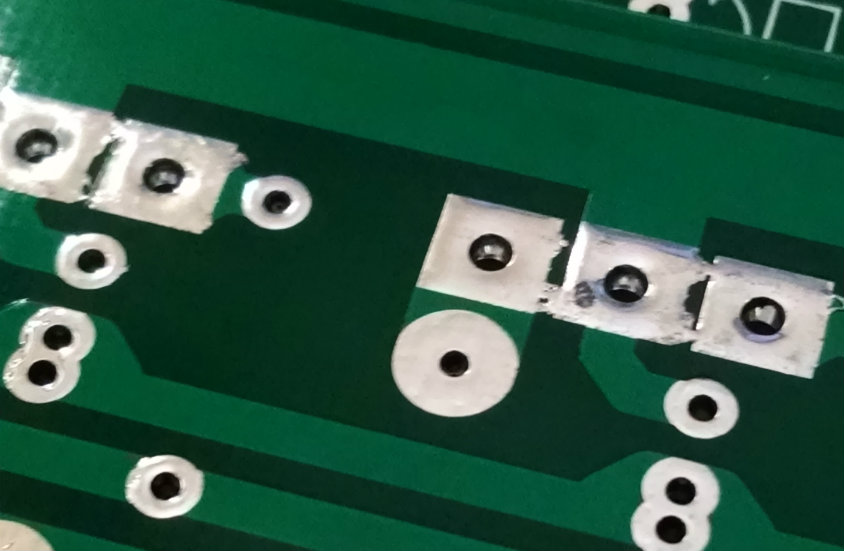

Have a quick look at your OPS boards...
Just a note to folks about the OPS boards:
A board member who bought some of the OPS has pointed out that the HAL tinning could be smeared resulting in a short between some pads. This was with only one of the boards, so may not be an issue with any of the others but it is still worth checking them. Apparently it cleaned up easily with the tip of a soldering iron and won't have any effect on the boards usability after removal. This is just a little of the tin plating smeared over the solder mask.
I want folks to know that I do have a look at all boards that go out to verify their quality before shipment but obviously missed this. My apologies should anyone find this with their boards. It should not result in any boards not being useable, just ensure no shorts are present prior to powering up.
I will ensure this is one of my visual checks in the future and I offer my sincerest apologies should anyone encounter this.

In the Symasui, GoNAD and Spooky Leach a DC servo is used with Wolverine and CFA-XH going without.
My goal will be eventually to be able to offer all of the IPS. I'm ready to stare at Symasui to look for any errors / possible refinements and then turn back to the Spooky Leach.
