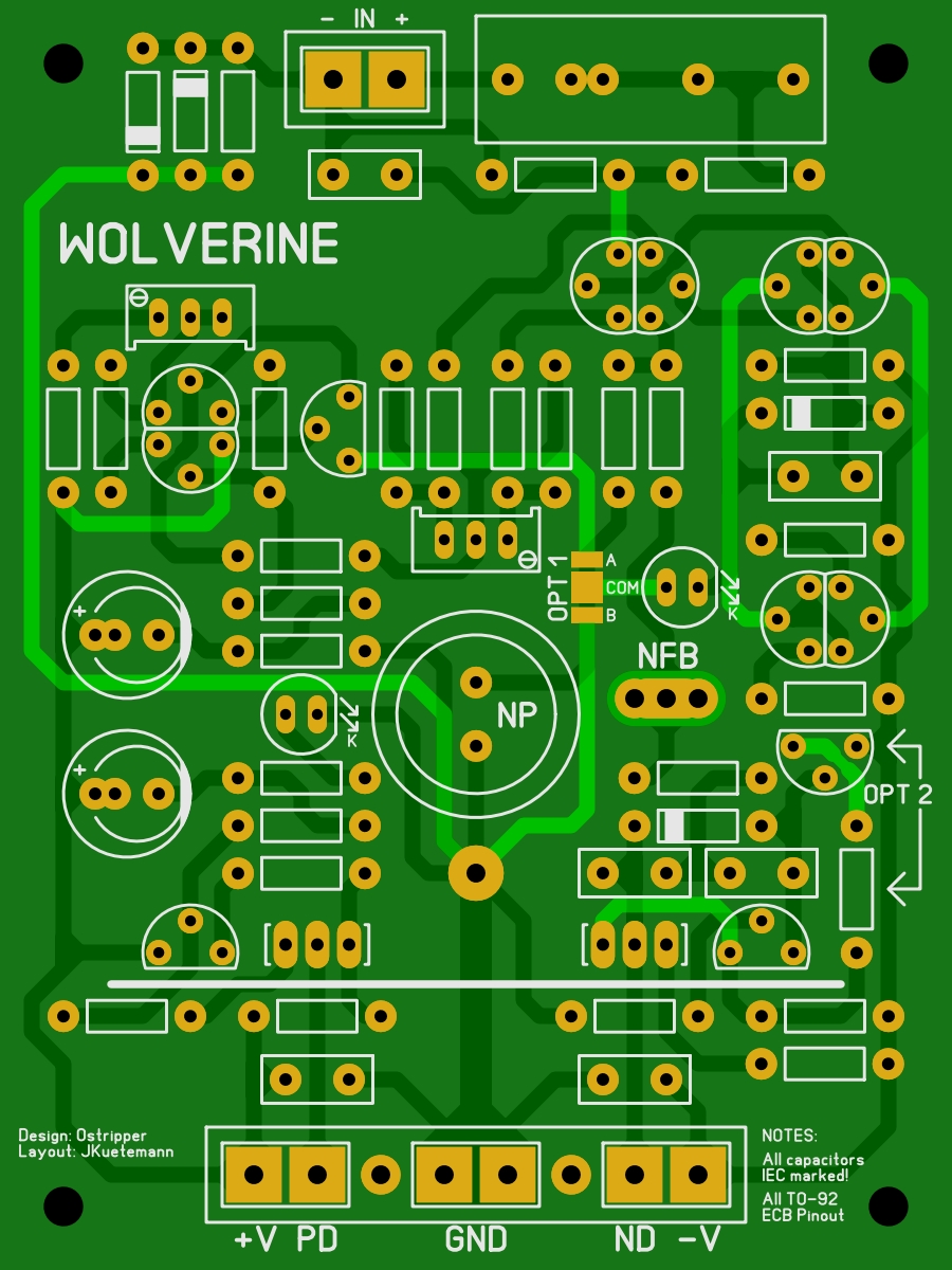

Folks, I'd like an opinion please, in particular from those who have seen / have both the CFA-XH and Synasui IPS boards. The question is this:
When I lay out the silk screen, do people like the component value marked in the device body or is the schematic designator only preferred?

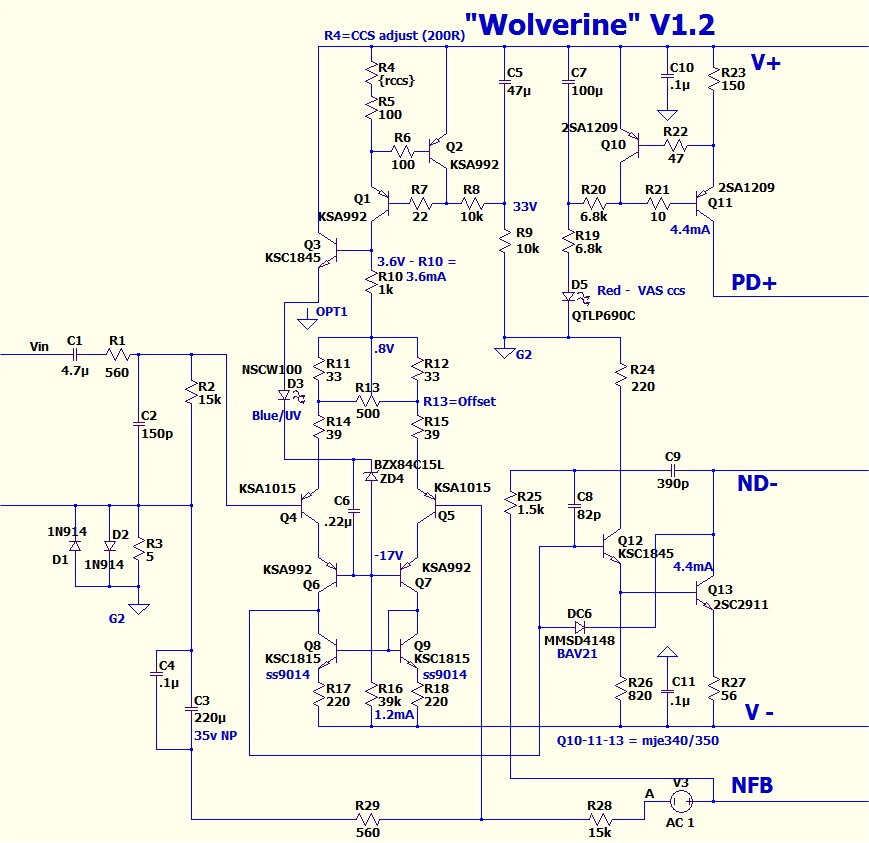

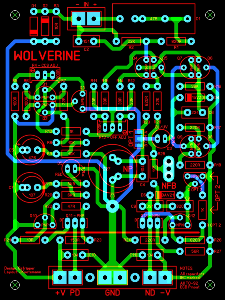

Wolverine is in the final stretch and is looking like the attached. Please have a look. Some values were adjusted to be the same as the Symasui for consistency. Also in line with my prior request for opinions about the silk screen I'm open to comments on this one. I tried to put as much on there as possible without getting too busy. Do you like it?

Are Q10 and Q12 attached to the heat sink?
No, they are not expected to be in contact. In OS's original schematic he had Q10 (a TO-126 of the same type as Q11) on the heat sink opposite Q11 but I see no valid technical reason to do so. I elected to make it a TO-92 to make life a little easier.
