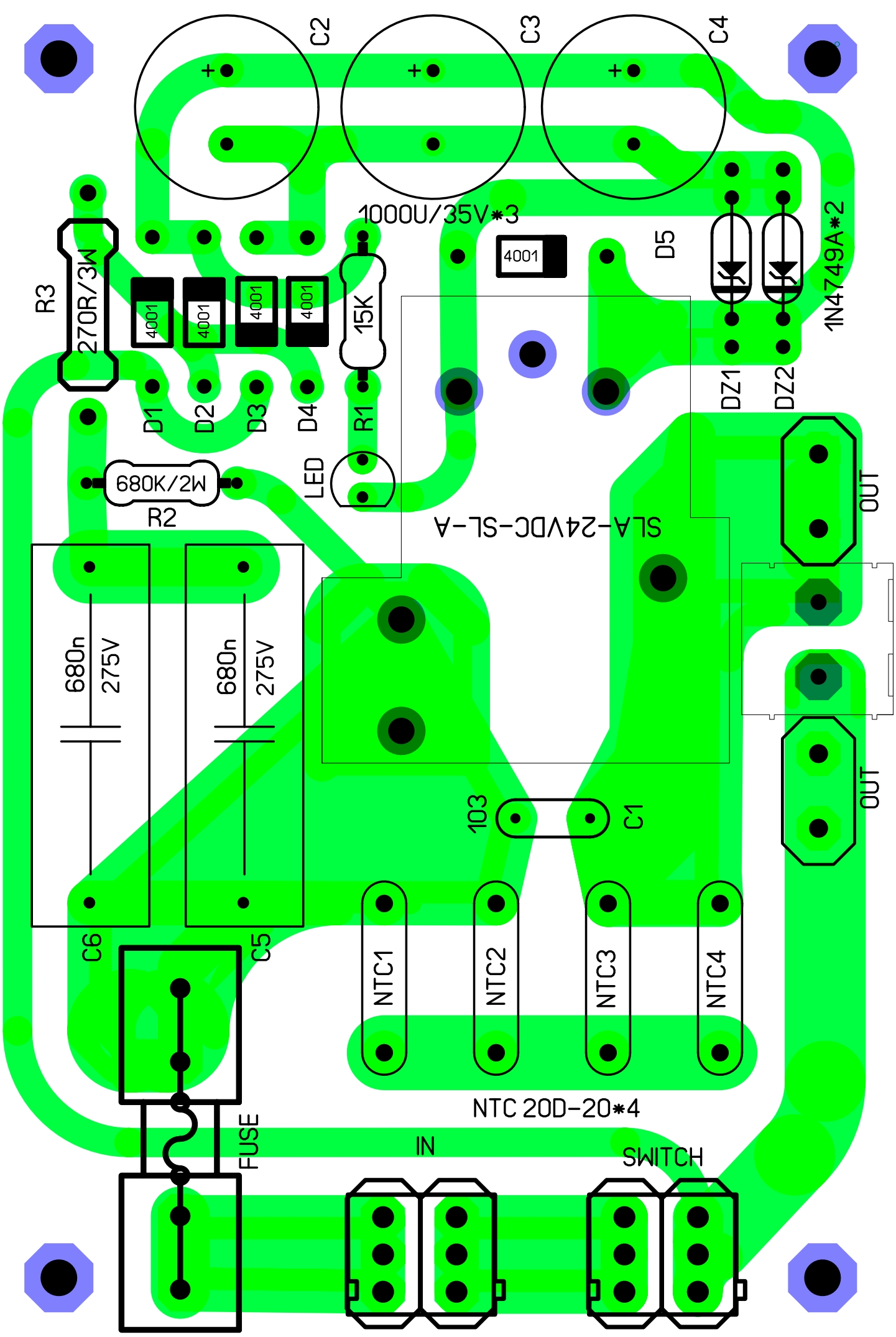

hello Ostripper, for any change do you have a soft-turn on circuit for a 600VA toroidal
actually for this Antek model AN-6440 600VA 40V 🙂

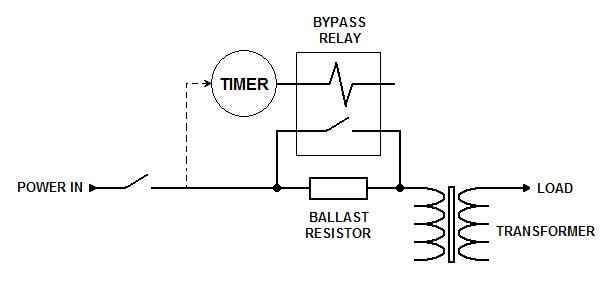

Talk to Vzaichenko/Jwilhelm. The "21'st century's" arduino based
soft start is even good on my 1KVA.
It can be timed at 5000mS to charge my 100Kuf cap bank to 90%.
Nothing is ever stressed.
The "21'st" is a 20R ballast resistor bypassed with (2) 20A relays.
It falls into the category of (below 1)
If you are not inclined and want to go cheap - (below 2).
Even as Rod Elliot - Soft-Start Circuit For Power Amps
says NO !! , I have seen the $5000USD Genesis stealth with just 2 20A
NTC thermistors survive 20 years. The NTC's were not even "baked" ,
like in a CRT TV power supply.
Former member MJL21193 also used these NTC's with no issue.
The only downfall might be the NTC flaming with a direct short.
OS

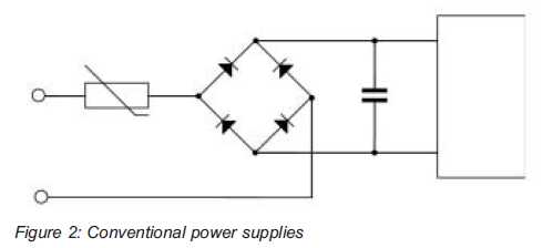

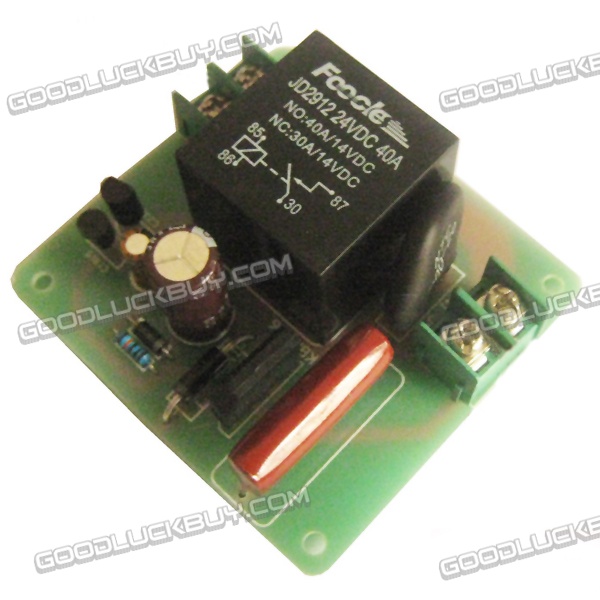

I have a design that I found online a few hours ago but I can not post copyrighted material here,
lol so instead of using resistors I can use two NTC thermistors in parallel ? the main where I live is 120V just like in the USA here is the illustration of the PCB maybe I can just use those devices instead or resistors right ?
Some just use 1 (15A+). Below .....
That would be the hybrid of the two examples I gave.
OS
NTC thermistors in Parallel ? There will be current hogging !
sorry I'm new to that 😛

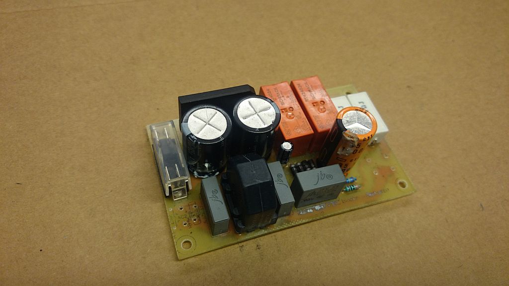

My bit of the off topic too. Bellow my simple soft start (reactance driven). I am using two relays instead of one. Why ?
One of relays works as a on/off switch so on the front panel you do not have to mount a huge hefty not nice looking 10A switch. Threw the front panel SW will be passing only 16mA. On the board there is DC blocker and simple mains filter.
