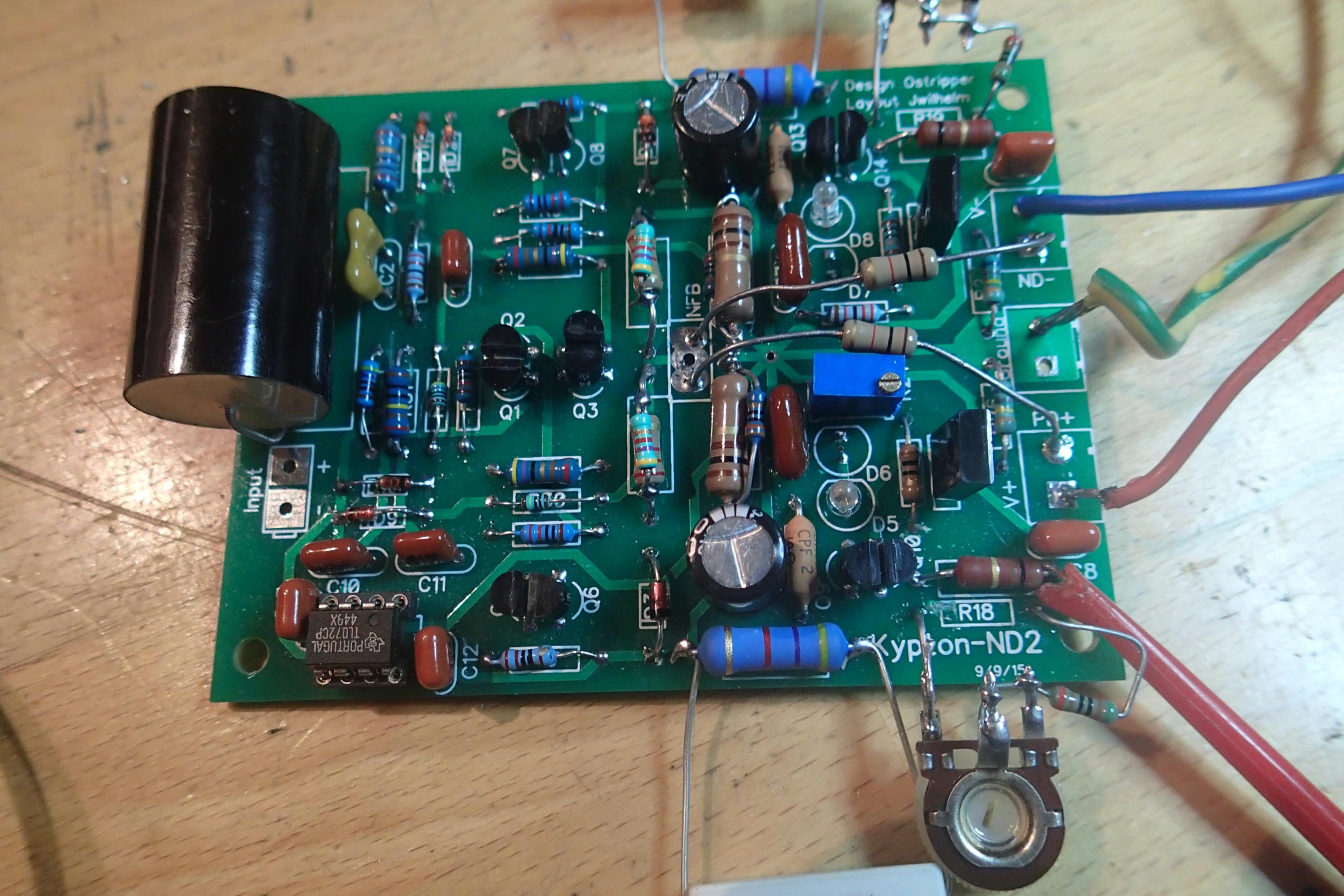

The first test of the Kypton ND-2 is done. Test voltage has been +/-30 V DC.
My aim is to use a power voltage of +/- 65 V . So all resistors mounted is taken from the "+/-64V list" exccept for R 18 and R19. As seen from the photo I have made this resistors of a 470 trimpot and a fixed resistor of 510 ohm.. I have monted one blue 3.2V led on each side and shorted "number two". This will be changed to the correct red 1.7 V leds later on. No small heatsink mounted on Q11 and Q12. All this differences might influence on the results. From ND- and PD+ 1K resistors are monted.
With my multimetrs over R22 and R29 I was able to measure approx. 0.66 and 0.68 mV. When I "trimmed" R22 and R29 the results influenced on each other. As a first test of the IPS I hope this shows that it works o.k.?
Where do I check the offset on my IPS?

The offset may not work properly without the OPS attached. A long as you are in the ballpark you should be fine.
I see a giant coupling capacitor...please have a look on this (see at the bottom of page) Capacitor CharacteristicsThe first test of the Kypton ND-2 is done. Test voltage has been +/-30 V DC.

Thimios wrote:
"I see a giant coupling capacitor...."
This is a a Audyn MKP QS 4.7uF with 38mm between the legs mounted very close to the PCB. Max distance between the mounting holes are 32mm. Yes I have done some bending to fit. Not recommende?? I took what I have. I have alternatives.
Question: The input are maked pluss + and minus -. Is it ment for singel ended with + as signal and - for ground, or is it for + and minus on a balanced input?

The input connections are not for balanced input, just audio signal and ground.
The problem with that style of input cap is there are two long unshielded leads and outer foil ready to pick up noise. A radial lead cap like a MKP is preferred.
