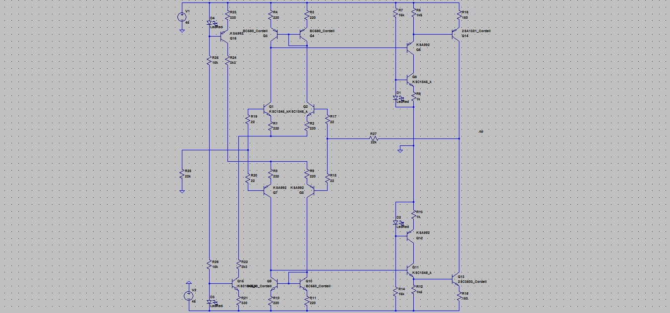

How single ended VAS current with loaded by constants current source, will change? I forgot the lesson long time ago when I was student.
I think how they work is same 🙂
I think I solve the problem of symmetry topology with current mirror. Just add buffer with constant current source, and then VAS quiescent current can determine reliable.
What do you think?

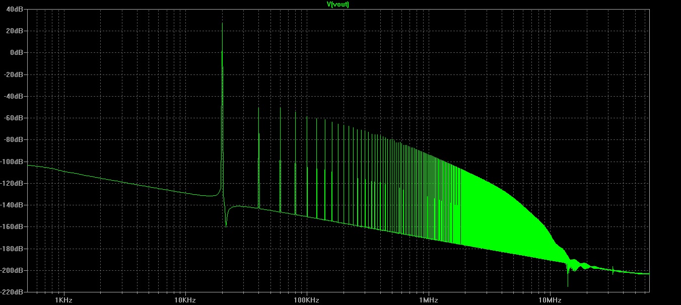

I make a complete simulation of amplifier with this idea. The harmonic profile is interesting. But I need lower THD.
Not really. Check the base current of the follower!
Sajti
What do you think?
Hi Bimo, CCS-loaded buffer does not save you from the VAS shoulders' "competition", resulting in common mode balance fluctuation, resulting in the VAS quiescent current fluctuation, unless you arrange a common mode control loop, one way or the other.
See, what I came to last year:
http://www.diyaudio.com/forums/solid-state/248689-xhs-xtra-high-speed-design-5.html#post4098539
I have removed the LTP mirrors and still have got very low distortion. CCS-loaded buffer is also there 😛
