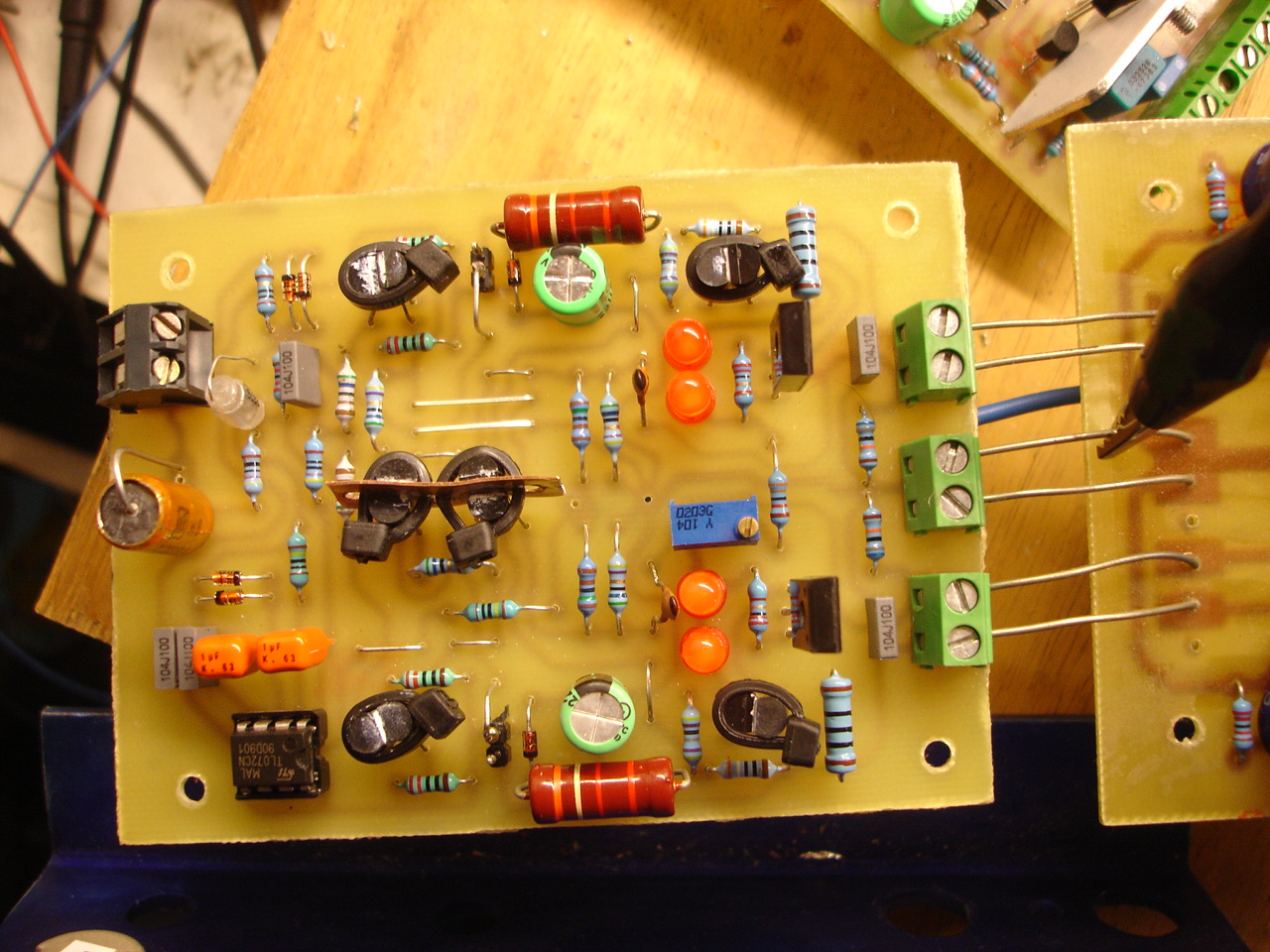

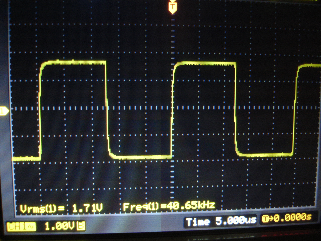

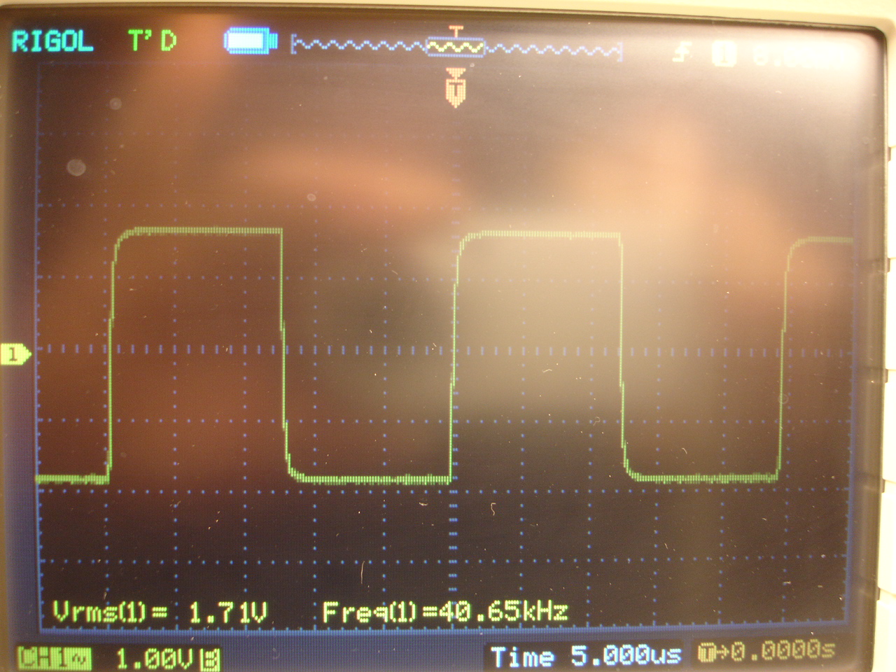

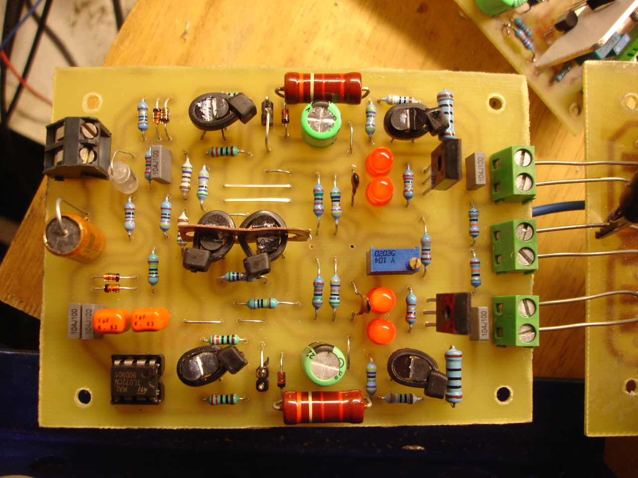

Ok guys.....it's ALIVE.
Power supply=+-50v
VAS current=6.5mA I(R22)=1,5mA I(R25)=8mA Ivas=8-1,5=6,5mA
OUT. Bias=22mA
OUT devices=2sa1943,2sc5200 one pair
offset=0mV.
Power supply=+-50v
OUT. Bias=22mA
offset=0mV.

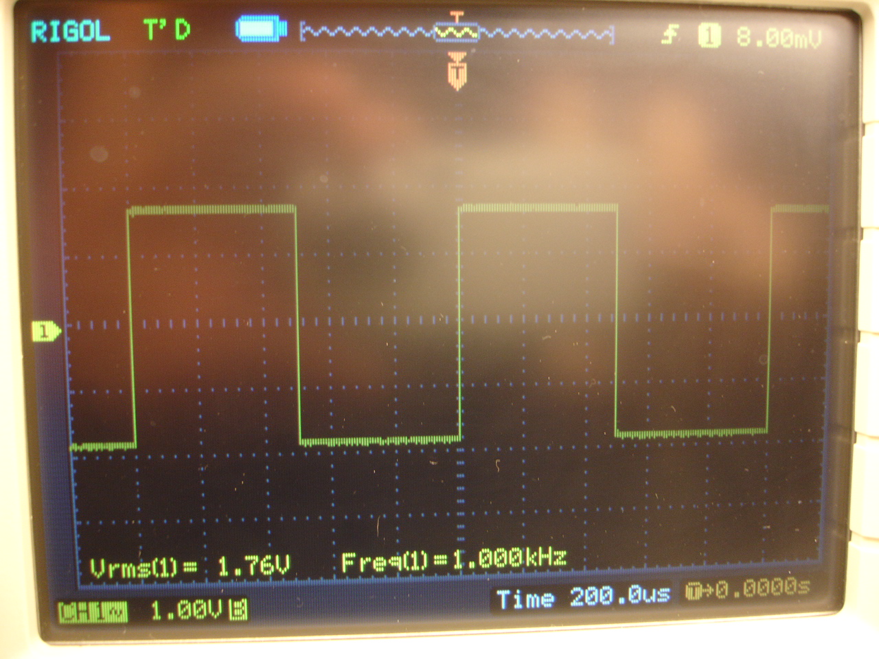

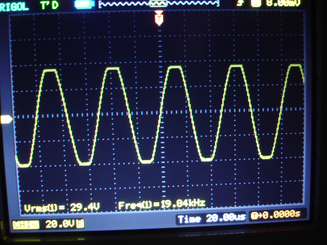

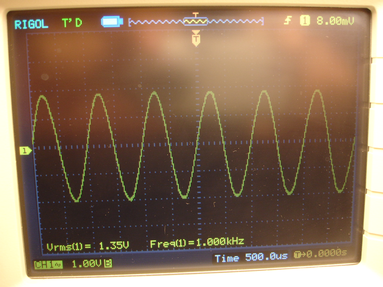

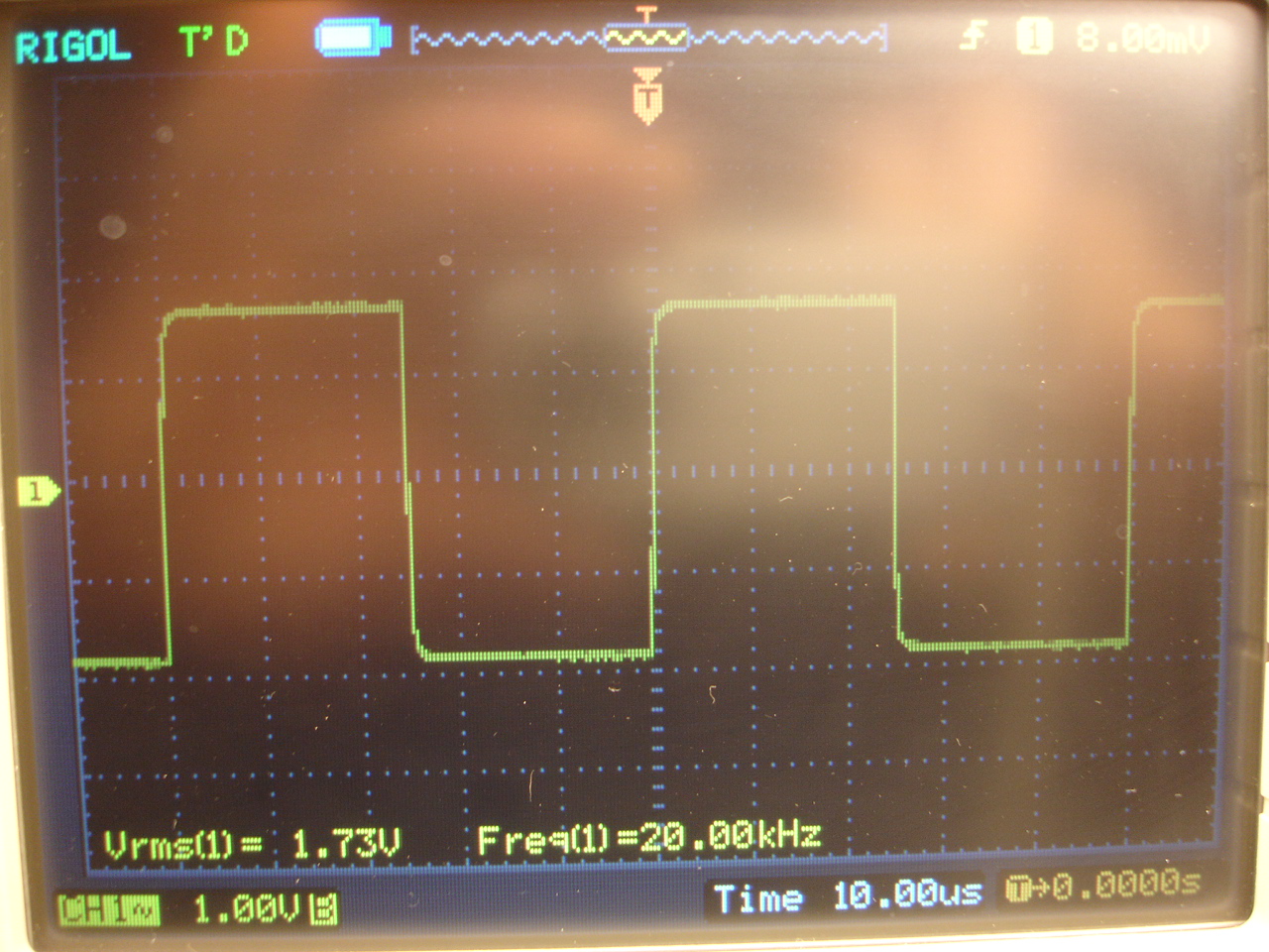

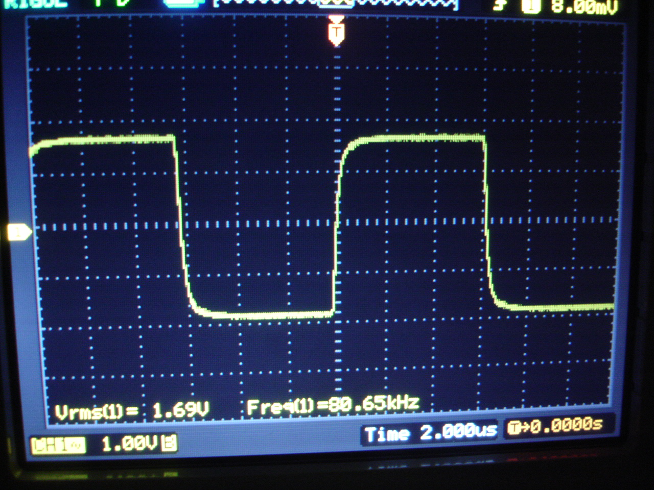

Thimios,
That looks real nice on your scope. Is there anything any better on sq waves than that at 20Khz and above?
Sorry Kindhornman i don't understand your question because......my bad English.Please ask again with more details.I will come back with more measurements later,if it is any interesting.Thimios,
Thimios
Thimios,
What I was trying to say in not so simple English was have any of the other input sections you have built had better sq wave results than this input section? They look very good so high above the audio band. I would have to go back and look at all your previous postings to compare the SW results to see if anything else looks as good as what you are now showing. To me that looks excellent, no ringing or anything else to offend.
Ok understand now,i can't remember all these IPS😱Thimios,
Yes i believe that this IPS is something special but someone must see previous IPS again for sure.Just now i see that forgot to get a speed (μs)measurement
