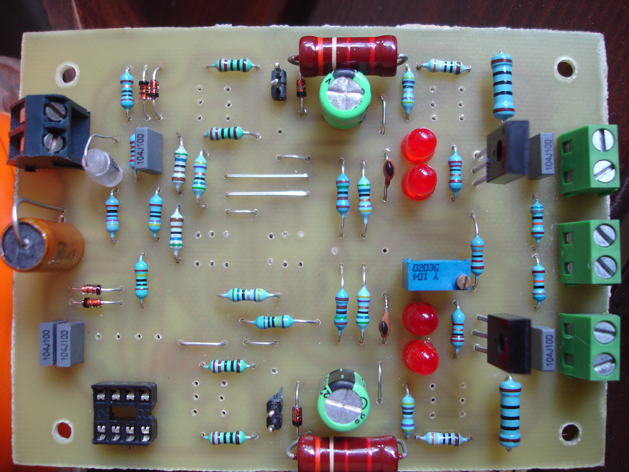

Small progress.
Many missing parts🙁

I see you have it set to try "A" and B" ??
The old "NAD" was "B" , no real issues (had a hawksford with + temp)
"A" -should be better ,
as the same Vceo for all 4 992/1845's will cancel thermally.
The super-pair VAS has close to 0 co-efficient.
The diamond resistive current source (mirrored by Q 5-8) just has
the ppm co-efficient of the resistors (TCR).
You looked over the layout ? - I'm still doing so. Still no error (I can see).
This IPS is "spooky" level in it's complexity.
Edit - when you "fire it up" , do so WITHOUT the servo ... at first.
(It will work without the servo) ....
You will see what level of Q1/2 matching you have. offset under 100mv
is good. Servo will counteract that with < +/- 2V to correct.

Ok boss A:judge:
All 4 tranz.at the same stabilized supply.🙂
Don't worry, a little smoke is a must with Eastern 🙂
