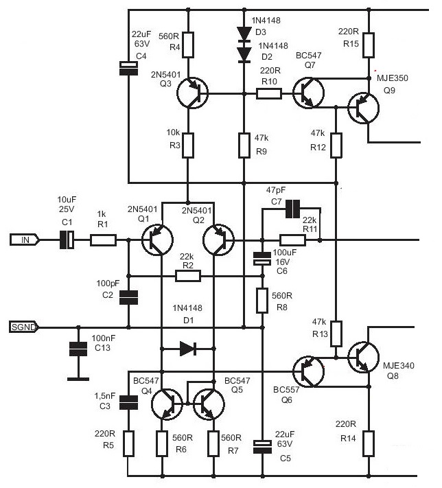

Hi Guys,

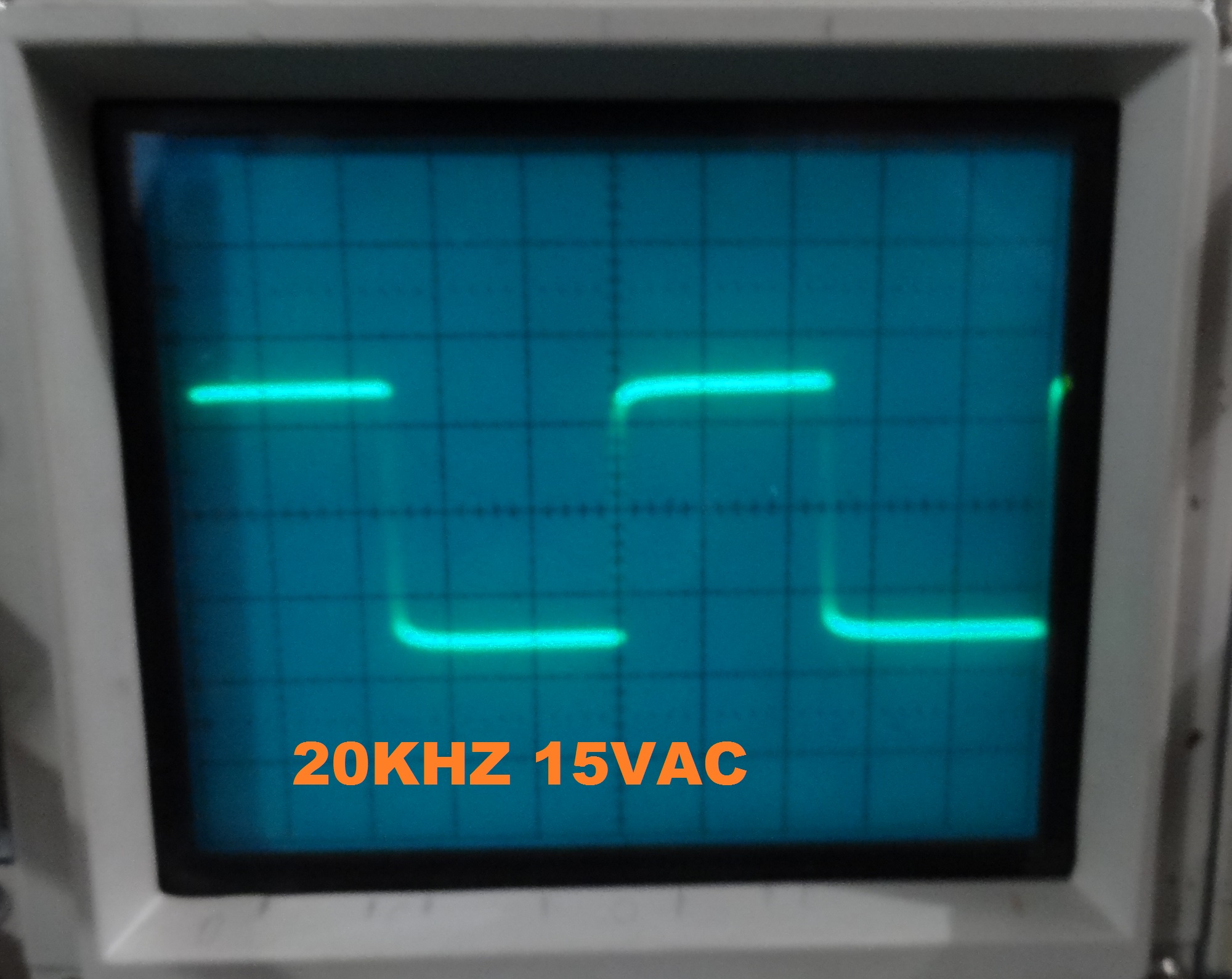

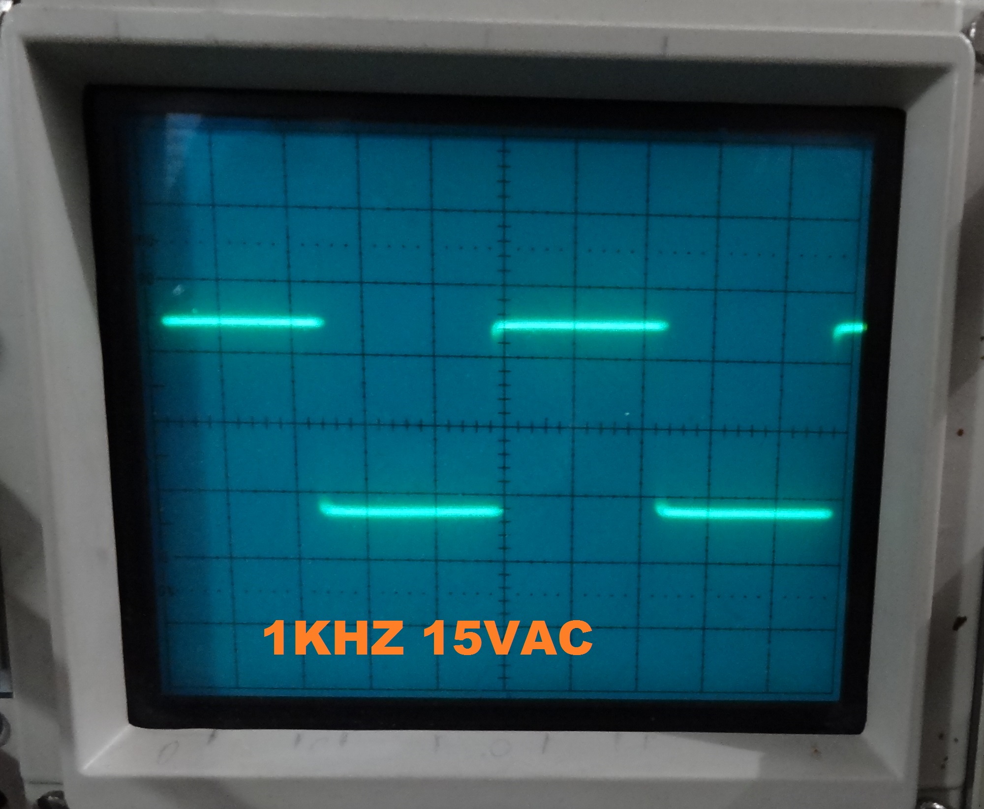

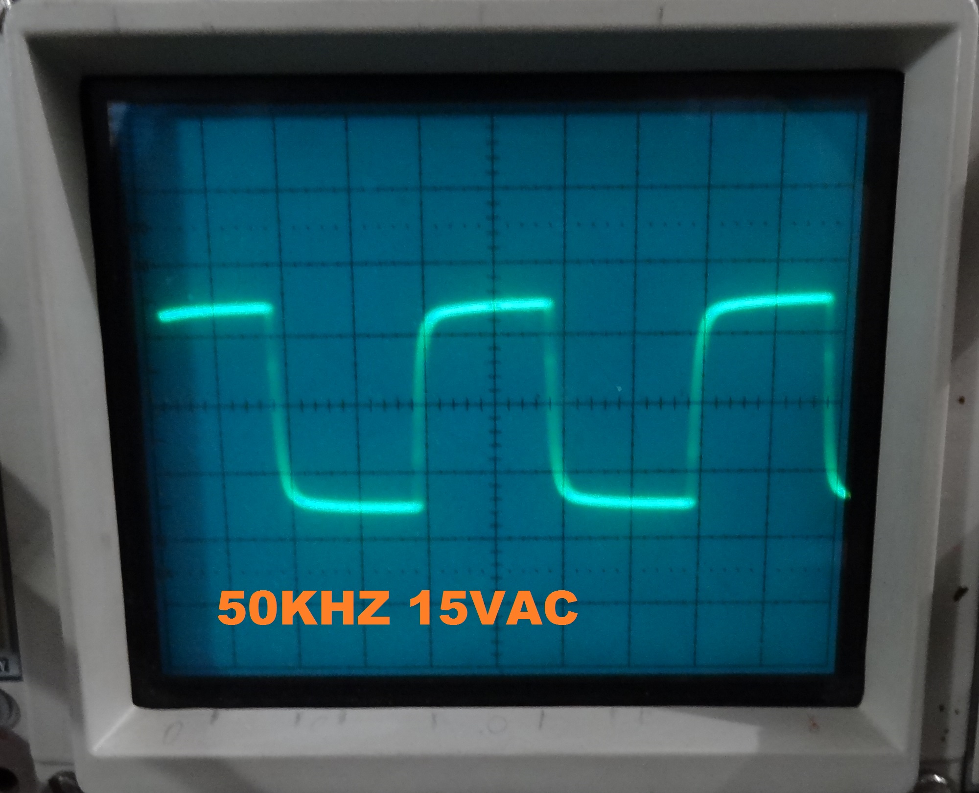

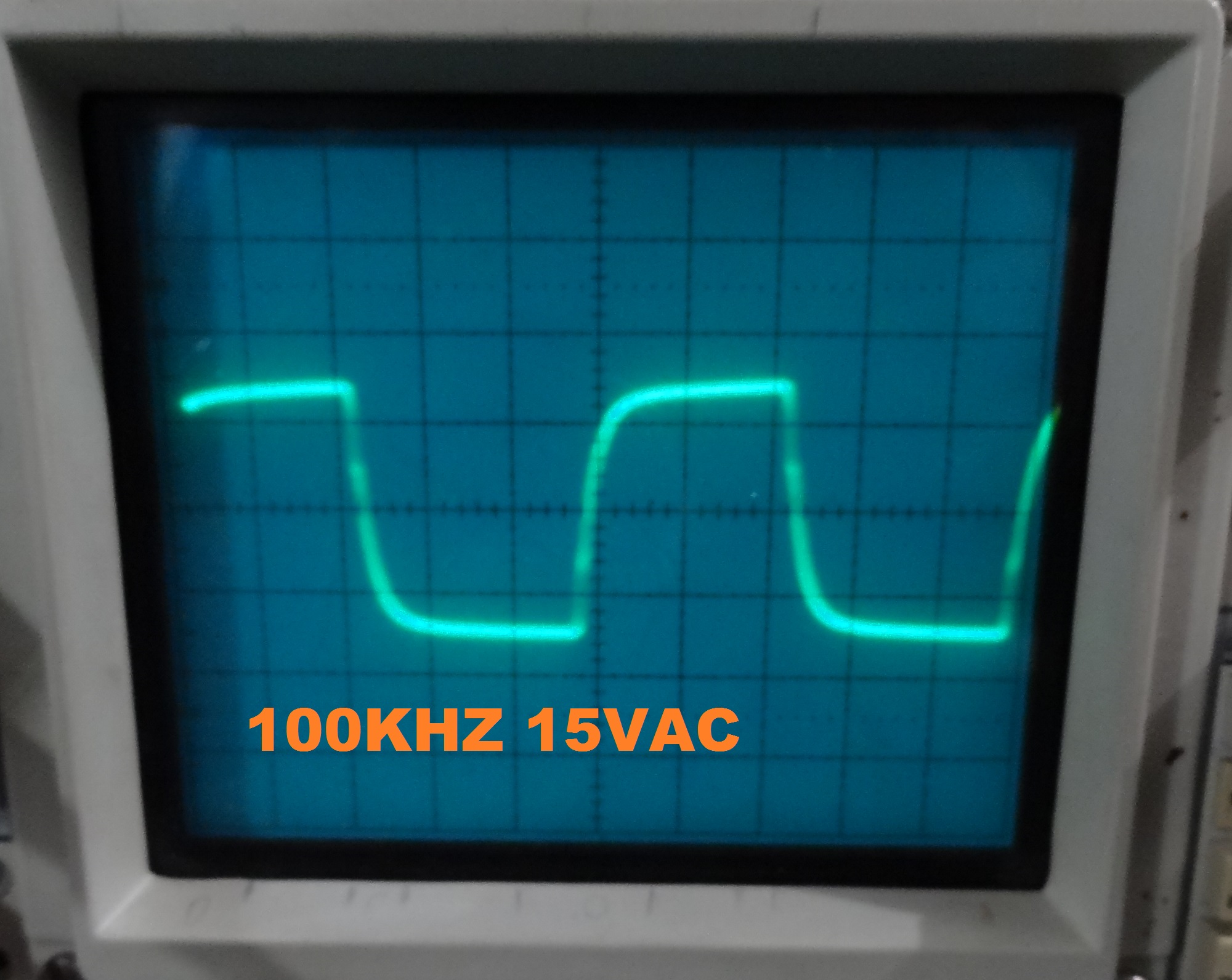

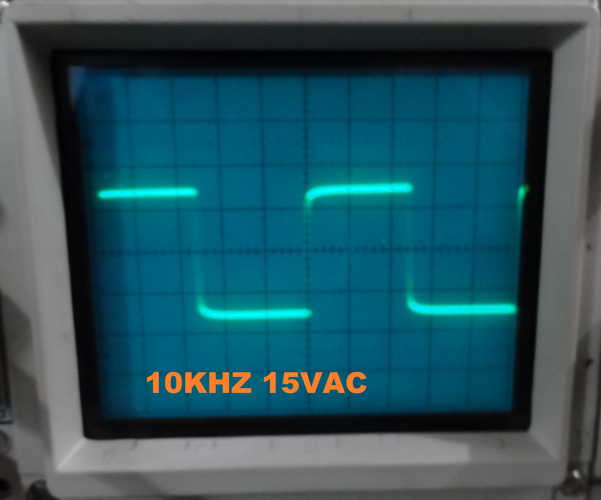

I changed my trimmers. I didn't have a 50k so I installed a 100k. Setting the VAS at 5.6mA had the trimmer down to 7K so I installed a 25k trimmer and changed R25 to 27K. Now I am reading about 40K from LED to LED.
I have the bias set to 68mA per device. It's been playing music for a couple hours now. Sounds lovely of course.
Here are my scope shots. Not as pretty as Thimios'.
Blessings, Terry

Ok understand now,i can't remember all these IPS😱
Yes i believe that this IPS is something special but someone must see previous IPS again for sure.Just now i see that forgot to get a speed (μs)measurement
I have good memory + insight.
The nicely rounded leading/ falling edge at 100k is the BEST I've seen.
That "rounded" = overcompensated. Nothing wrong with that , but
you could most likely drop C7/8 to 22p for another 1/2mhz unity gain
point ! (200Khz perfect SW).
This amp is textbook CFA , and "follows" the simulator results perfectly.
To get that perfect 5.3-5.5ma Ivas you could reduce R25 to 22k and trim
out R24 to spec.
Good work , Thimios ... you have a servo'ed "NX" on steroids that can
run a 250W OPS ! 😎

You trimmed the LED I , I see. Bleeding off a couple more mA through
the LED's is not a bad thing. Led's are rated @ 20ma - 4-5 won't hurt.
Did you test the node between R4 and R7 ?? This is the servo
voltage , can tell you how close the diamond is matched by it's voltage.
OS
Hi OS,
I checked the node at R4 and I have 1.2V on the left channel and 2.3V on the other. To be honest, I went by what I though you said in post 6766. You said the super pair were the important ones to match and that because it was servoed Q1&2 could be mismatched. So I didn't bother trying to match them. I suppose I could replace them but this thing plays perfectly as is and the ofset is very low on both channels.
I've been listening for a few hours now and I really, really like it. After you mentioned the 250W I couldn't resist turning it up. MAN scary loud and strong. You should hear those 12" JBLs. Who needs a sub?
Blessings, Terry
Hi OS,
Blessings, Terry
Your alright ... 1.2 and 2.3 V would equate to about .1 - .2ma more current
for Q2 (that is your "weaker" semi -NPN).
Also , the super pair matching ensures stability and that perfect clip
on Thimios's scope .
My Kypton C's are both about 1V - I did DMM match them.
Glad these worked first time - I was careful in the design. 😎
Edit - really really like it ? This is what the "NX core" sounds like with NO loading
of the second stage. the super pair will never exceed picoamps - even on clipping !
You could overdrive this amp for a decade and never stress any IPS devices.
OS

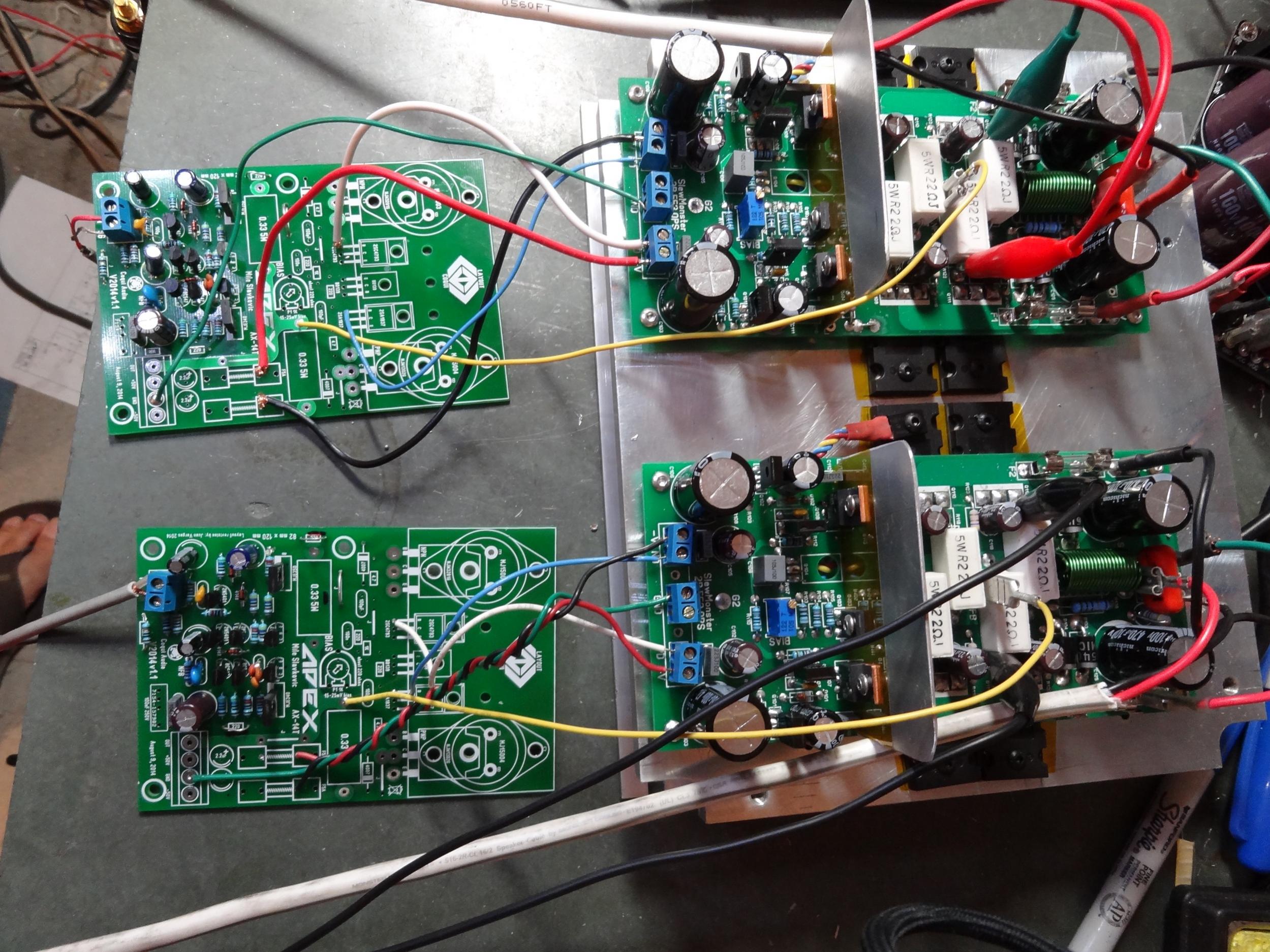

Mine clips perfectly too, I just didn't take a pic of it. This amp worked great right outof the gate. Someone should do gerbers for this one. I think this one would be popular. The first "super pair" IPS I used with the Slewmaster was the AX14 converted to and IPS. It played great right out of the gate too.

Yes , the AX14 was one of my starting points. I combined it with a
Hawksford (Vzaichenko , as well). It did oscillate on the "kypton V" with
massive gain. Perfect on the C -lower gain CFA.
The hawksford/baxandall (super -pair) combo clips better , lower "early
effect" . Best of the VAS's , but can "interact" with the wrong design.
This is the "right design" for it (low gain CFA).
Member Waso's (Russia) CFA feedback scheme is also used in this one.
All the best ideas are here.
OS

Waso's CFA compensation has some hidden secrets. The two millers act
in a combined manner. 15pF + 15pF act like 33pf in the old design , stability
is the same .... but we are pushing 411V/us at this point. (below 1)
"Splitting" FB also lowers current and associated thermal distortion.
Even 1/2W FB resistors will run cool here.
We can push for quite the bandwidth and gain margin now ...
22pF to 33pF can be used safely. 2.5 - 3.2mhz UG crossover.
In the end , we have a amp that Doug Self will NOT include in his book
because it " has no use for audio" . 😀
PS - input diamond is actually 992/1845 pair , my 992 model is "screwy" ...
does not have a "k" or "c" after it ?? Anyone have a good 2sa992 model?
OS
