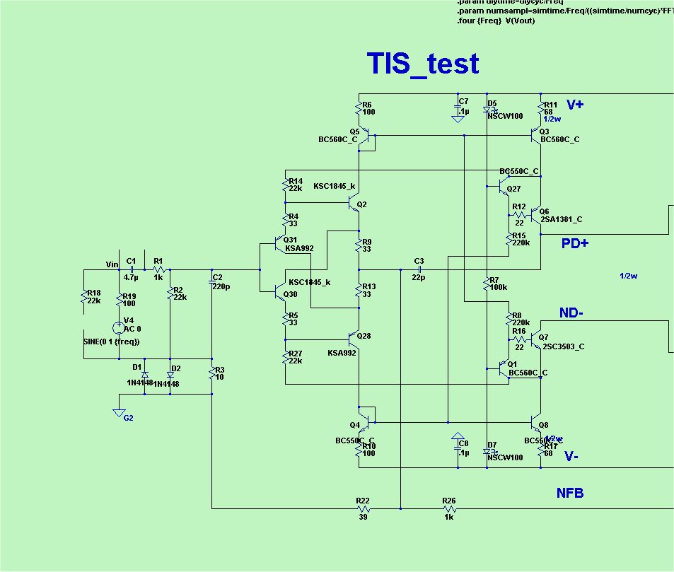

But , the TIS/CFA works (below) ! Time for further refinements.
OS
TIS CFA and VFA
Works better as a VFA - nothing impressive as a CFA.
Lower gain TIS can't manage <10 ppm 20K as a CFA. PSRR blows at <70db.
But , it did work. Can't match the K-C @ 80+db psrr /8ppm 20k.
As a VFA (like the original concept), it is better. I managed <10ppm 20K and
it had typical VFA PSRR.
Perhaps as I did not use ideal CCS's / Ideal output stages , my results
were not as stellar. ??? 🙁
With that many parts , not enough "bang for the buck".

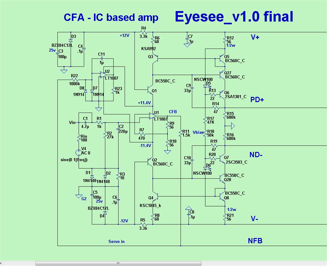

Eyesee is done - (design)
A perfect chip magnifier.
I read the TL072 paper .... 16V slew / .01% thd - eyesee w/ the TL does
32V slew and .01% 20K.
Just about every IC I simulated was within range of it's manufacturer's specs.
(or a little better). 🙂
IC is not in any compensation loop or directly in a feedback loop ,
therefore .... NO chip will exhibit any significant change in phase margin.
Some have higher native gain (higher CLG in the eyesee = .005% @ 20k).
The IC's spec is the only slew limiting factor - a faster IC = a faster amp ...
period.

I assume, it also maintains common-mode stability, although I don't understand how, as yet. Need to do more thinking 🙂
Or, if Edmund Stuart would explain - I would very much appreciate it 😉
Don't know exactly what you mean by "common-mode stability". Perhaps stability of the TIS standing current (DC operating point) under dynamic conditions?
Please explain.
Cheers, E.
Please explain.
Cheers, E.
That's right - in such configurations, having two LTPs with CCS-ed tails and dynamic loads, in many cases "VAS competition" takes place, resulting in standing current fluctuation. CMCL is one of the solutions, however, in your super TIS something else ensures DC operating point stability (I believe). Right?
Right! The TIS standing current is simply defined by and equal to the LTP tail current. As for "VAS competition", this is absent for two reason;
1. Input inclusive compensation, so there are no two (slightly different) caps to the upper and lower TIS input, which might provoke fighting.
2. Unity gain of the TISes. So if ordinary Miller compensations was used (i.e. with two caps), even then there was no "VAS competition".
Cheers, E.
PS: The crux is that the gain of the TIS has been moved to the next stage, i.e. the pre-driver. This way a lot of trouble is circumvented.
Cheers, E.
I see now! Edmond - thanks a lot for explanation, cool "out of the box" approach :worship:
Try the LT1057 🙂 It's currently LT's defacto standard hi-speed JFET generic opamp which is supposed to replace any earlier types (according to the datasheet). I'm using it in my schematic both as inverting input driver (2 of them) and as DC servo. It's THD is just 10ppb, completely neglible when loaded > 500R, at unity gain. But as it wouldn't affect your circuit other than slew, it probably won't matter much.
But I've declared it the generic opamp to use for myself (unless you want to go with audiophylic opamps).
if you use matched dual's for the mirrors I'am not so sure you really need a servo if you choose a trim-able op-amp.(as you have blocked input with a cap)
In the blowtorch thread there has been a debate about the performance of highly loaded op-amps, some maintains good performance even loaded down to 100 ohms

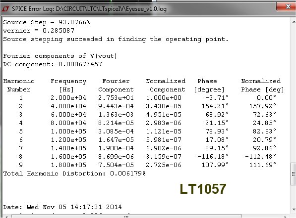

LT1057 is very good.
About twice as good as the LT1007 (below).
For CFA , you need more load - I used 112R ... but the IC is only <4V
(as a buffer). .005% is not too bad for such a simple circuit @ 20k.
