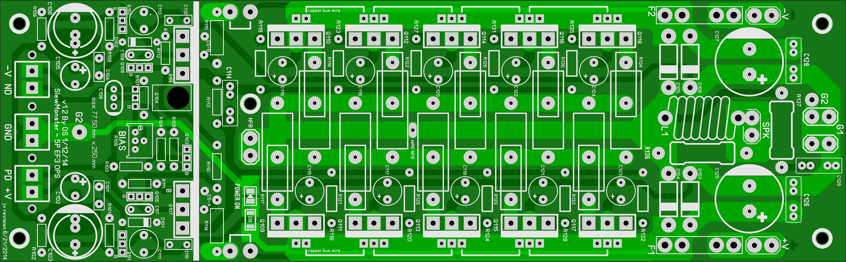

I did the Slewmonster 5P from you and mister JK awesome layout I already safe it for later 🙂 "choosing the IPS is hard 😕
but man so many IPS PCB's that is like you are in bakery and they are too many sweet things to chose from lol ,😛 now we have KYPTON-V wow ! 🙂 very cool :yes:

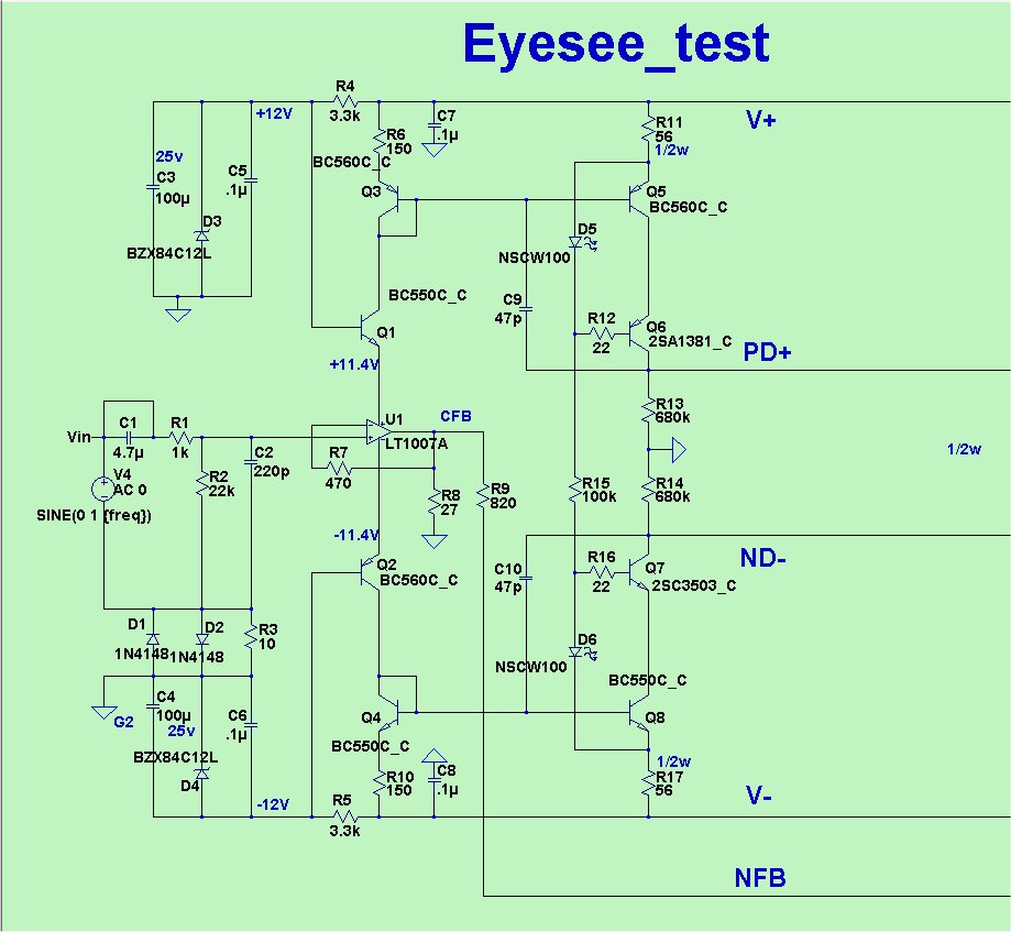

Like the "Eyesee" (below -schema)... just a TL072 or even a NE5534 (oops)

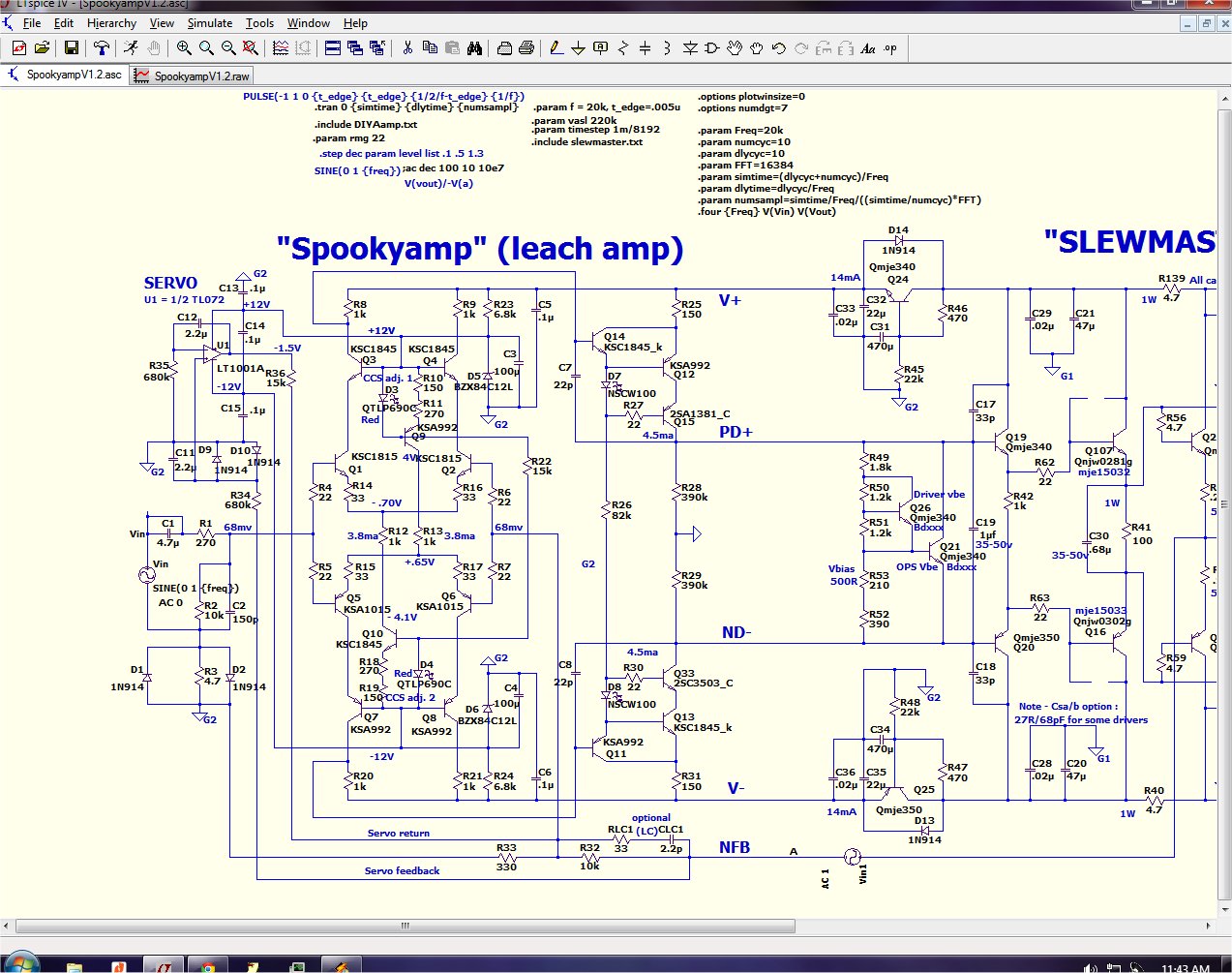

It starts with the Concept (eyesee V1.0 .asc - below)
What a simple amp - .001 to .003% 1K/20K , better than the old DX (before
the "blame").
Had to read the LT1007 paper .... http://cds.linear.com/docs/en/datasheet/100737fbs.pdf
Had to read " unity gain buffer" section , now "it eats square-waves" 😀.
What you don't know can (frustrate) you.
It needs more gain (op-amp is only a buffer with current feedback).
HEY !!! , it's a bloody CFA - 😎😱 Confusion fading .... 😀

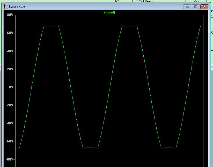

Edit - it clips nice ! (below 2) Big waveform for a little cheeeep.

Etch that Kypton- C , Thimios's scope test of it was the best CFA in -
1. clipping - perfect !
2. offset 1mv - perfect !
3. squarewave 20k, 100k , even 300k - nearly perfect.
Not a 3 transistor wonder , (12) but all run cool (and perfect).
Try the CFA - the "corporation" never got to it. 😛
OS

Roger that OS 🙂 so KYPTON-C will be then thanks,
man square wave from 20k,100k even more that is crazy wow 😀
I will then concentrate on KYPTON-C

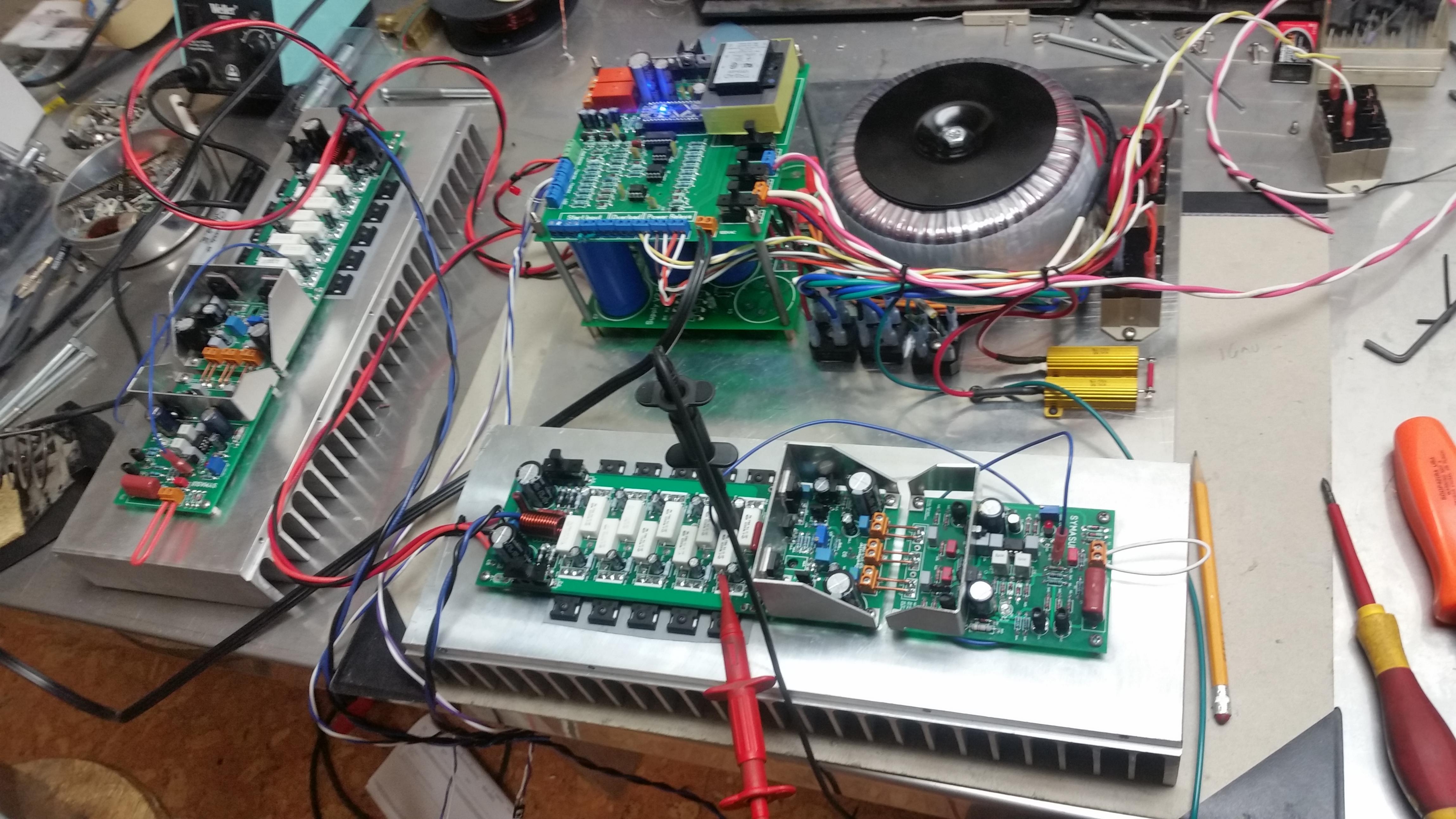

I'm slowly making headway building a chassis. I just lost control of the idle current on one channel. More fun.😀
Ahhha )) I see a familiar protection board in the new layout 😉 You've got a very cool transformer on the board - looks very similar to the one I use.
And - of course - the SlewMonsters!
Man-size transformer 🙂
Coming out nicely :up:
P.S. I'm also preparing for drilling the heatsinks...
