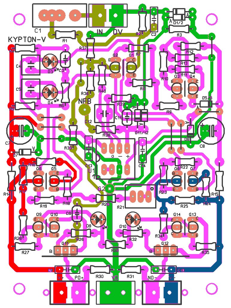

I have leave my town for a little rest.Almost as bad as the "spooky".
Almost gave up on it. -- HULK SMASH FILTHY DIYA AMP !! 😀😀
Sort of redesigned it ...as I almost "gave up on it".
Came up with a deluxe VFA that will please even the guru's.
20hz - .5ppm
200hz - .5ppm
2k- 1ppm
10k - 3ppm
20k-4ppm
220V/uS slew ..
Good enough for me !
Servo'ed it (of course).
Had to use EVERY sq. CM of the board (85 parts).
Even thermally compensated the CCS and referenced the servo from
the lifted ground (not G2).
We have a "lab amp" here. 😀
New schema and I will release the artwork tomorrow. (GLA lovers rejoice) !

Looks like I have all the parts so I just need the foil etch pattern so I can make a couple of boards.
Blessings, Terry

Well , here you go .... "mr. IPS factory". I am warmed up, now.
Had a snowstorm/power failure ... knocked back to the 19'th century
for 2 days 😱 .
You would be the first to tackle this type input stage ... I found no
others on DIYA besides vzaichenko's .
OS
Tried the standard CM , wilson CM , with and without the hawksford.
The superpair gives lowest THD / best saturation behavior.
I might take your advice and try a CM/superpair 😎 .

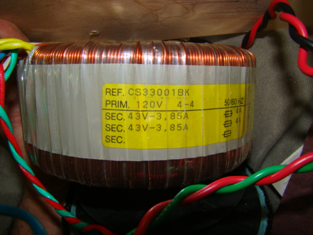

- a "lesser" 35-0-35V 500va toroid.
- boards (too many - 2 pair badgers/2 pair slew 5P/1 pair 2P)
OS[/QUOTE]
You need a "man sized"
toroid to go with those 5 pair output boards! I couldn't even test properly with a 35-0-35V.

Well, for a 2-pair one it will be fine (35V AC --> almost 50V DC)...
It's not going to be a "concrete crasher", but more than enough for home listening 😉

35-0-35 V A.C gives about 50V D.C . Absolutely satisfactory for Slewmaster if we haven't a bigger transformer.

Excellent ,send this to him who gave us everything!Os, would this be use full to you?
Yes , that would do about >60-0-60Vdc .
My case is (W)300*(H)138*(L)360 mm (internal) . What are the trafo
dimensions ?
