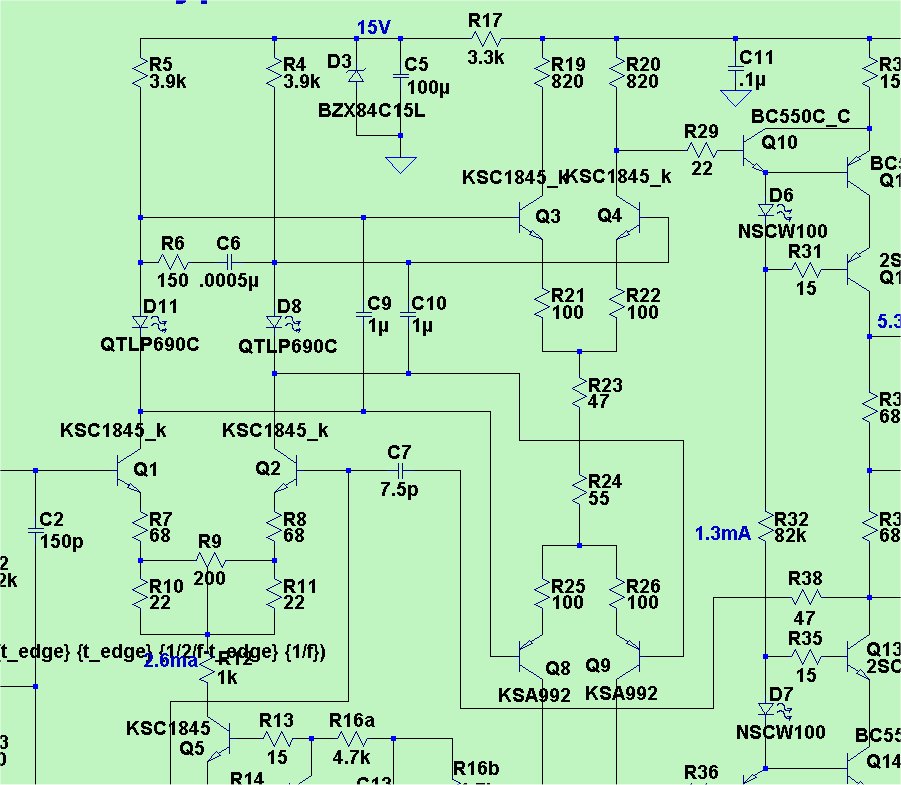

I try real hard to have first time successes for these designs. I was a little
worried.

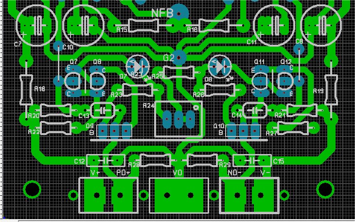

I'm doing the second "kypton" now. I now know the VAS is real good ..
V will have the same design.
I redesigned the VAS (layout wise) , transistor/heatsink issue is solved.
I will use the same for all kyptons (below).
PS - I have the "C" redesigned fully for toner DIY - all errata corrected.

Now it is confirmed that my suggestion to use Baxandall super pair VAS to get good clipping is not only simulation artifact, thank you thimios and to OS too.
Damir
You were right on the money ! PS - I read your threads carefully , many good ideas 😉 !

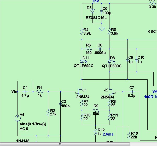

I am so impressed with the performance with ANY of my FET models ,
the "Kypton-V" will have a optional Jfet 1st stage (below).
The JFET simulations have 2 effects.
-They do increase distortion slightly ... 9ppm to 16ppm 20K (so what).
-H2 rises , the "tube sound" 😕 ?
-degenerate sources (less -22R) and increase Id to 2ma
All else is real good - offset , clip , slew.

Is there a Jfet that is available that will work? That one is listed as obsolete everywhere.
Nearly any I have tried work well.
I'm making the board for cheap , easy to source fairchild J111-113.
The first stage uses a 15V supply - any of mousers 105 n-channel fet's.
the FET only sees 7 volts Vds in the circuit - perfect.
ON semi has the 2sk596 http://www.mouser.com/ds/2/308/ENA0944-D-266479.pdf
Low Ciss microphone fet.
I'm sure just the OLG will be slightly affected by different Jfets (change rd).
At 7V .. electrically, all will run the amp( without smoke). No big
issue expected - BCxxx is pin for pin compatible with Jfet DGS.

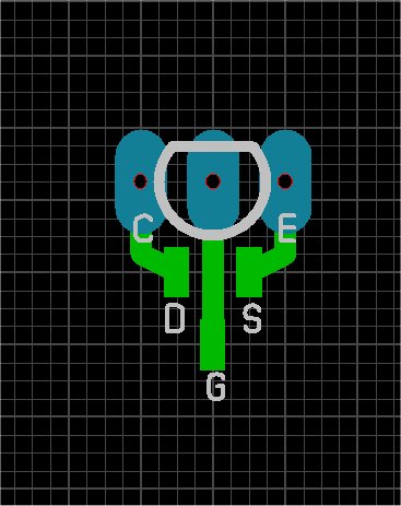

Everyone is scared of SMD , but they are DGS , too.
On the same pads as the to-92 , add the SOT-23 (below) ...
Then you could choose 100's more devices.
-BJT/ to-92 or SOT-23
-FET/ to-92 or SOT-23
Any device. Just change Re/Rsource to use it.

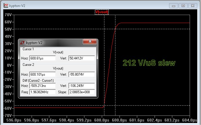

On the Kypton-C, you can omit R28-29 ... gain will increase.
I now have 212V/uS out of a cheap japanese circuit with 100db margin.
Borys and vzaichenko , to get absolute stability out of the 2 stage LTP (below 1
example) ,tweak your main compensation (C7) with decreasing values
10p , 8.2p , 7.5p ..... until overshoot is eliminated on a full rail to rail squarewave.
I needed different values to do this with either the BJT or FET.
Once the overshoot is gone , you will still notice a small "wiggle" , even on
a nicely rounded squarewave. Adjust (increase pF) the lag (C6/R6) to
get rid of it. Also, FET was different than BJT.
What is strange , the phase margin was always excellent , even if the
transient response was less than ideal. It does not respond like a LIN
or typical CFA design ??
In the end , you will have a perfect rail to rail response with stellar slew rate.
(below 2).
I "gave up" on this type amp a few months back 😱 - now I have it.
OS

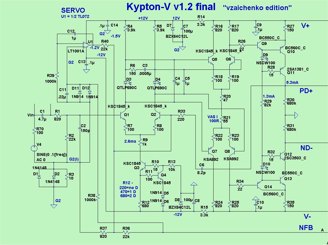

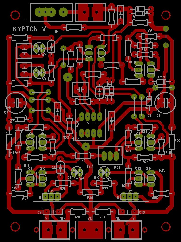

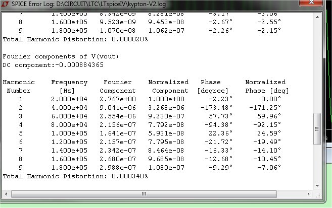

kypton v progress
Almost as bad as the "spooky".
Almost gave up on it. -- HULK SMASH FILTHY DIYA AMP !! 😀😀
Sort of redesigned it ...as I almost "gave up on it"
Came up with a deluxe VFA that will please even the guru's.
20hz - .5ppm
200hz - .5ppm
2k- 1ppm
10k - 3ppm
20k-4ppm
220V/uS slew ..
Good enough for me !
Servo'ed it (of course).
Had to use EVERY sq. CM of the board (85 parts).
Even thermally compensated the CCS and referenced the servo from
the lifted ground (not G2).
We have a "lab amp" here. 😀
New schema and I will release the artwork tomorrow. (GLA lovers rejoice) !
20hz - .5ppm
200hz - .5ppm
2k- 1ppm
10k - 3ppm
20k-4ppm
220V/uS slew ..

Nice one-sided PCB by the way
